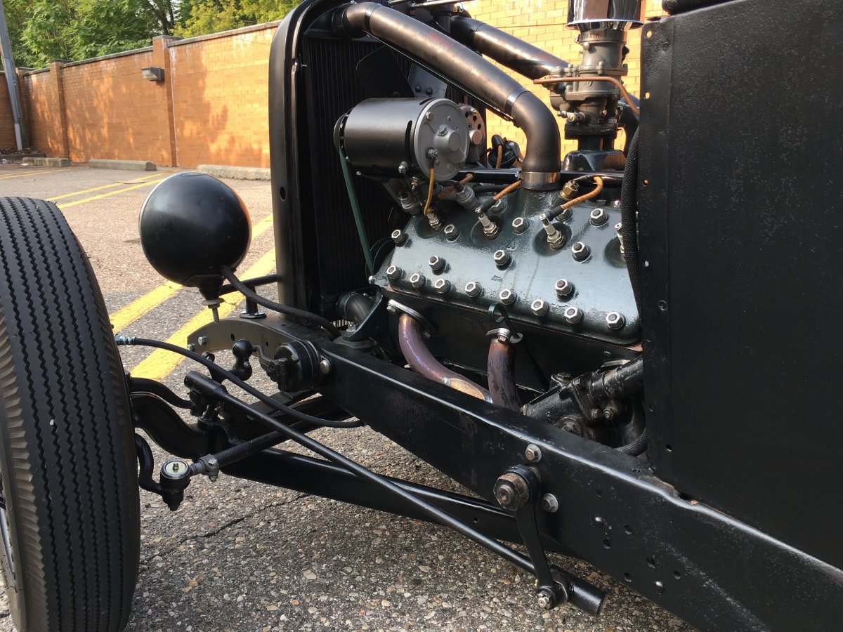

    Had a vertical fan clearance issue with my radiator outlet. Decided to mount the generator on the left hand head and make up a pulley specifically for the fan. I used the front and rear of another generator core, cut down the shaft (with the help of another Hamber who machined one end for me to match the bearing ID), and was able to lower it about 0.75" from where it was when the generator body was in place. This allowed me to keep much more of the fan blade to cool this 85 HP beast!

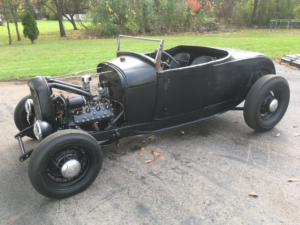

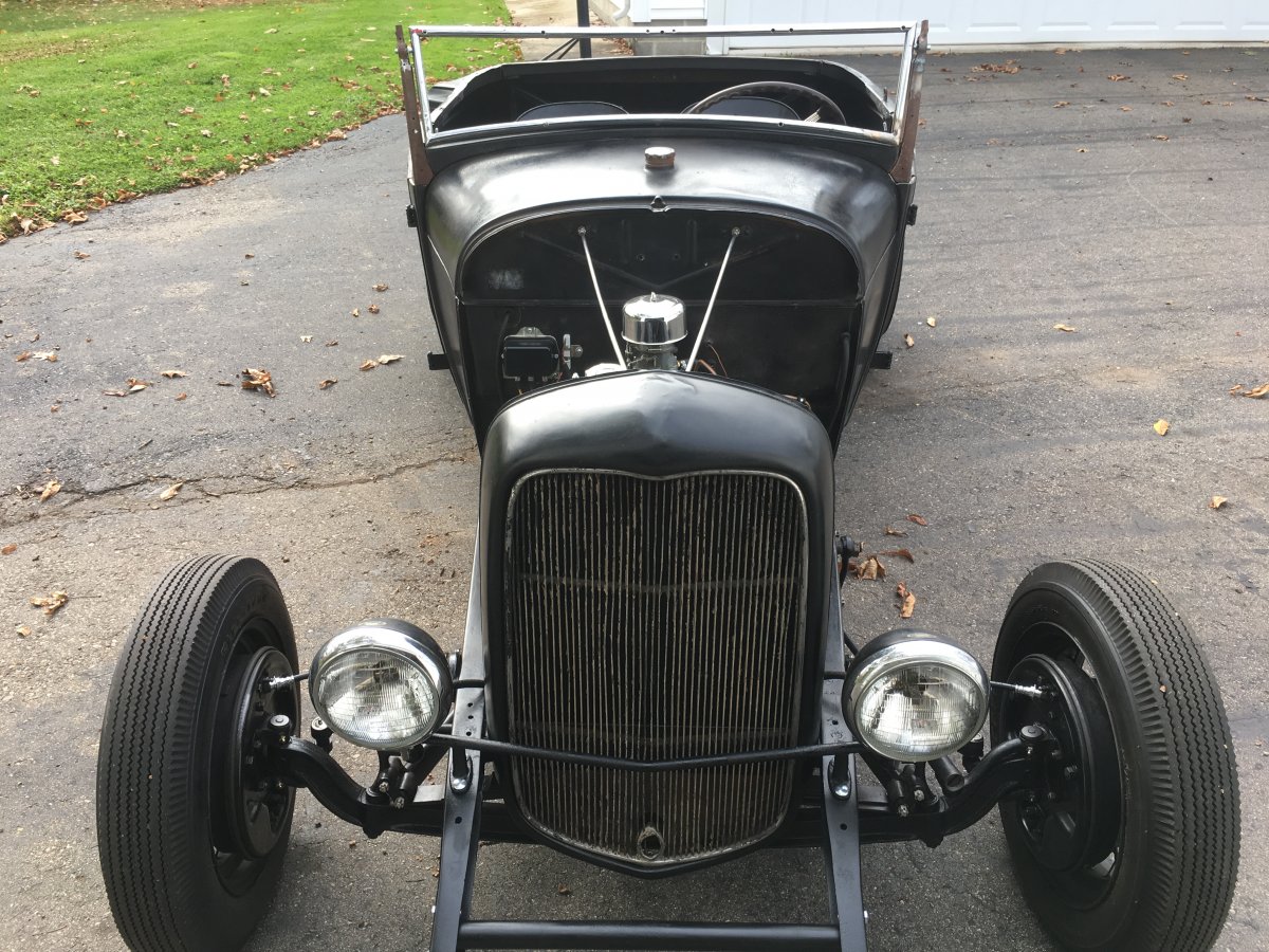

    IMG_0913.JPG IMG_0914.JPG IMG_0916.JPG IMG_0919.JPG IMG_0920.JPG Looks like the history of this thread in pics is lost like many others. The car is on the road now. Here's where it's at currently. Still working on a windshield and some small stuff.

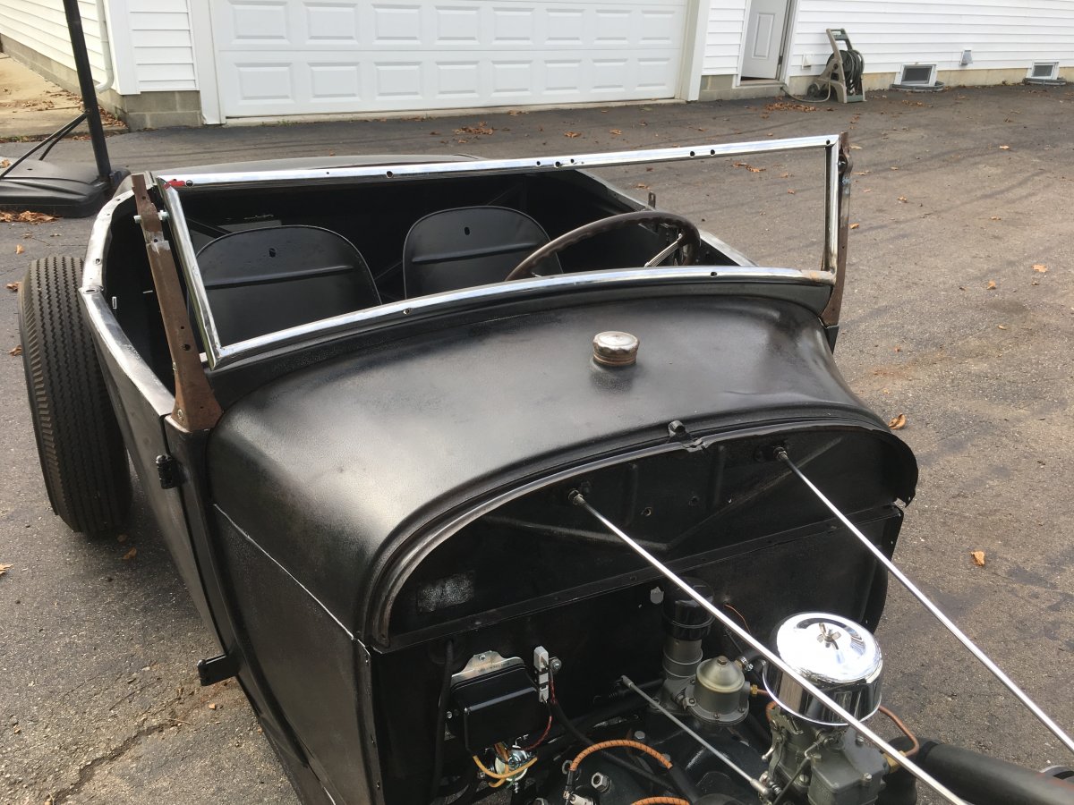

    6FB07598-0086-4DD3-92CE-0F073B02CD42.jpeg 78158E98-F4E4-483D-BFF3-EFC7834DC973.jpeg D3EC8A8A-B88F-45DB-937F-41B45551A679.jpeg Got the windshield mocked up. 4.5” chop. Old chrome frame.
