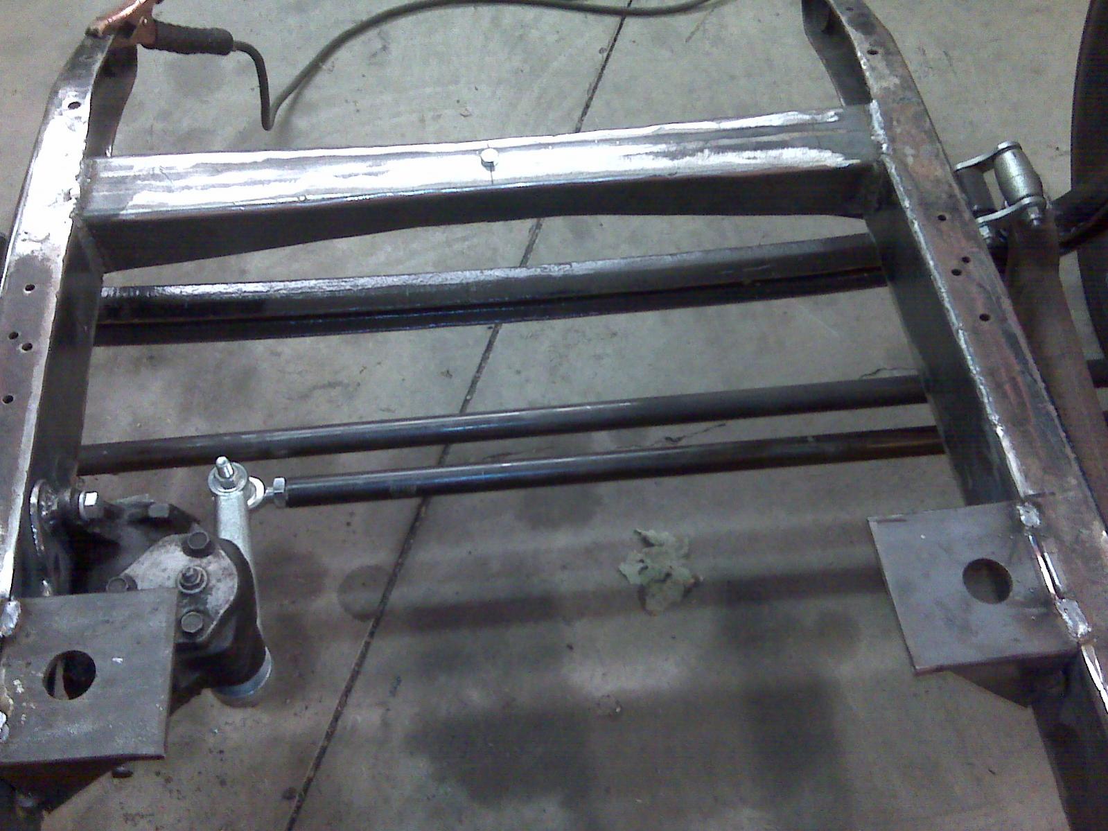

    im curious if you finished off the gaps in the welds where you coupled the front and rear frame??

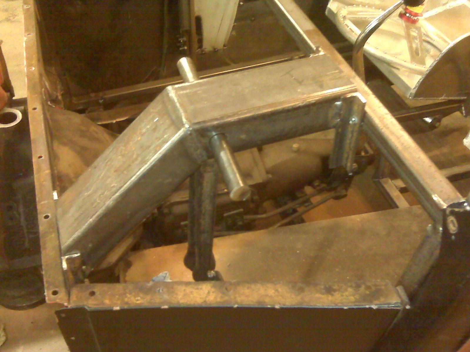

    Since the pics in my 1st post I have completed the welds on the kickups. I have also boxed in the original Model A section of the ch***is. I also welded in some 45 degree corners to smooth the appearance of the front kickups.
    I wish I had a pic to help describe my description. unfortunately for you I have my body sitting on my ch***is preventing me from taking a pic for you.

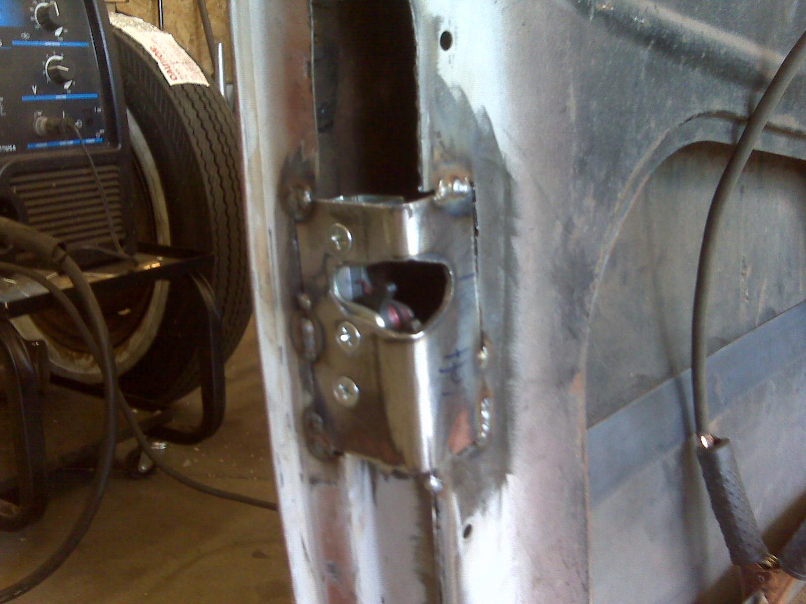

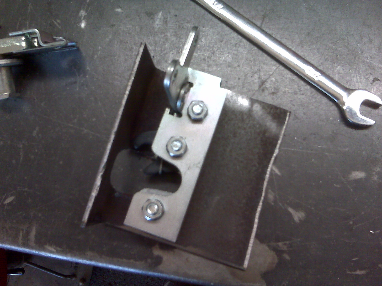

    I've made some decent progress lately. I after I slimmed down both my doors by a good 3/4" I installed some bear-claw type door latches. The installation went pretty smooth. I guess that's because of doing it once before on my sedan. It's pretty nice to have overcome the hurdle of making pickup doors work on a coupe/roadster back half. I still need to finish welding them together and do some mud work on the patch panels.

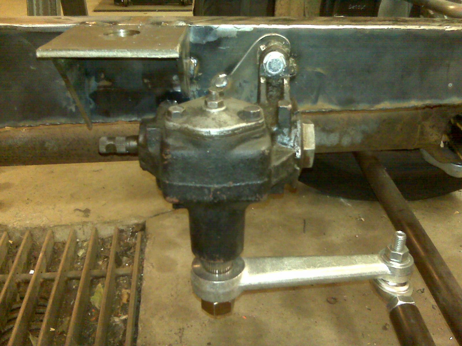

    The long Independence Day weekend was an opportunity to do some serious work. The the first thing I worked on was the steering column. Originally I intended on using a Mopar steering box and having traditional steering. After mocking up the installation I decided it wasn't going to work for me. I simply didn't have enough room for my feet and three pedals. Luckily I had a Vega box on hand to use instead.

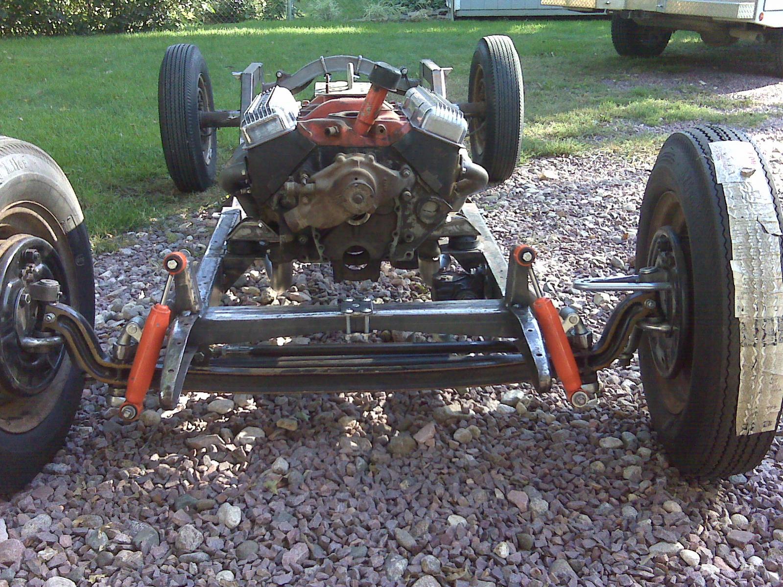

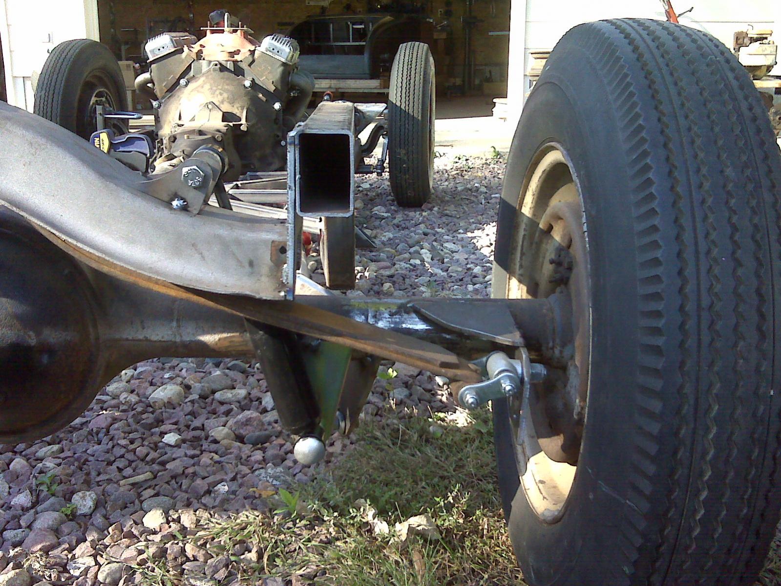

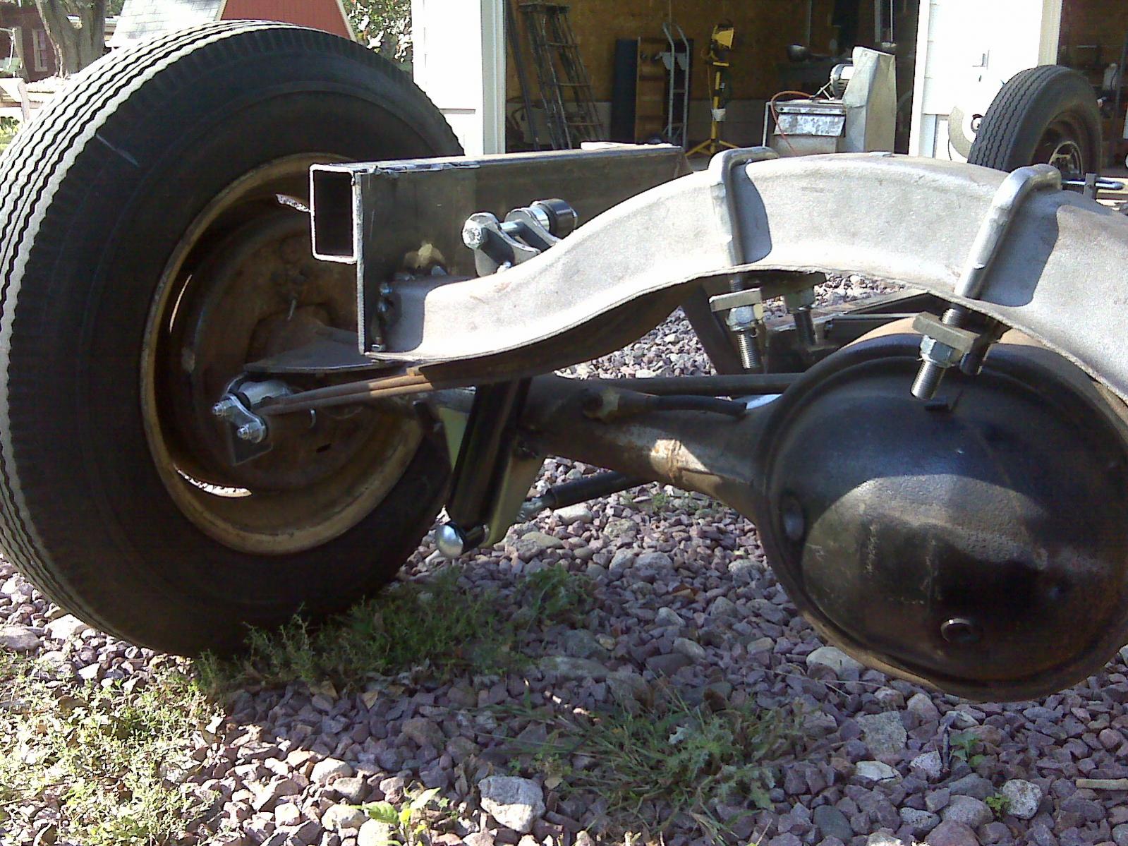

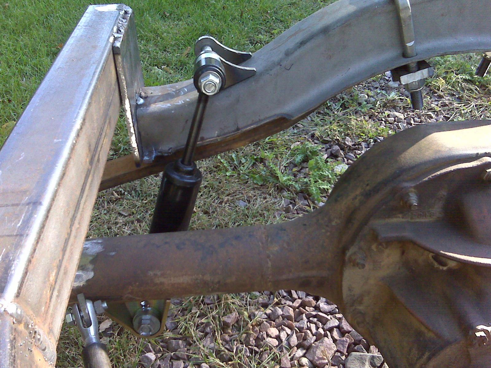

    There has been more progress on my roadster over the last couple months. From the front to the back.... I built a couple front shock mounts and a front panhard bar. I also built a transmission crossmember. I knew that with a roadster channeled roadster body, the only thing that will hold it together is a rigid ch***is. So, I built a x-member. I was fairly limited with this because I planned on running my exhaust directly underneath it. I used some 1.25" square tubing I had sitting around. I sure hope it will be enough. I used some .25" plate steel to pull the two sides of the ch***is together. My most recent progress is the exhaust. I chose to use some Speedway block huggers. I found Jegs to have pretty compe***ive prices on 2.25" exhaust tubing. Of all places to purchase automotive parts, I found Amazon to have a great deal on Cherry Bomb gl*** packs. Oh, and free Supersaver shipping to make it a better deal. The last thing I have done is mount the rear shocks. I was able to mount them between the rearend and rear crossmember. Currently I am working on mounting the battery. I think I am going to mount it behind the p***enger seat.

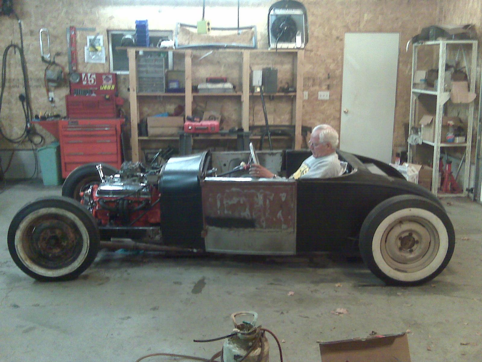

    I have made some great progress lately. I stripped the car down to the bare ch***is to complete some welds and add some gussets. I have also replaced many critical bolts with grade 8 bolts. Today was a big day. We were finally able to fire up my 283. It sounded great with the cherry bomb gl*** packs. I owe all the credit for that to my dad. He is awesome. He has forgotten more about engines than most guys will ever know. We also bled the brakes and the hydraulic throwout bearing. I now have a very good pedal for both. Tomorrow I am going to focus on cooling. After that I will attack some electrical stuff. Hopefully this weekend I will be able to back it out of my shop and take a trip around the block.
    Hopefully I have a drivable car to tear down this winter and paint and detail. I will try to take some more pics during the final ***embly.
