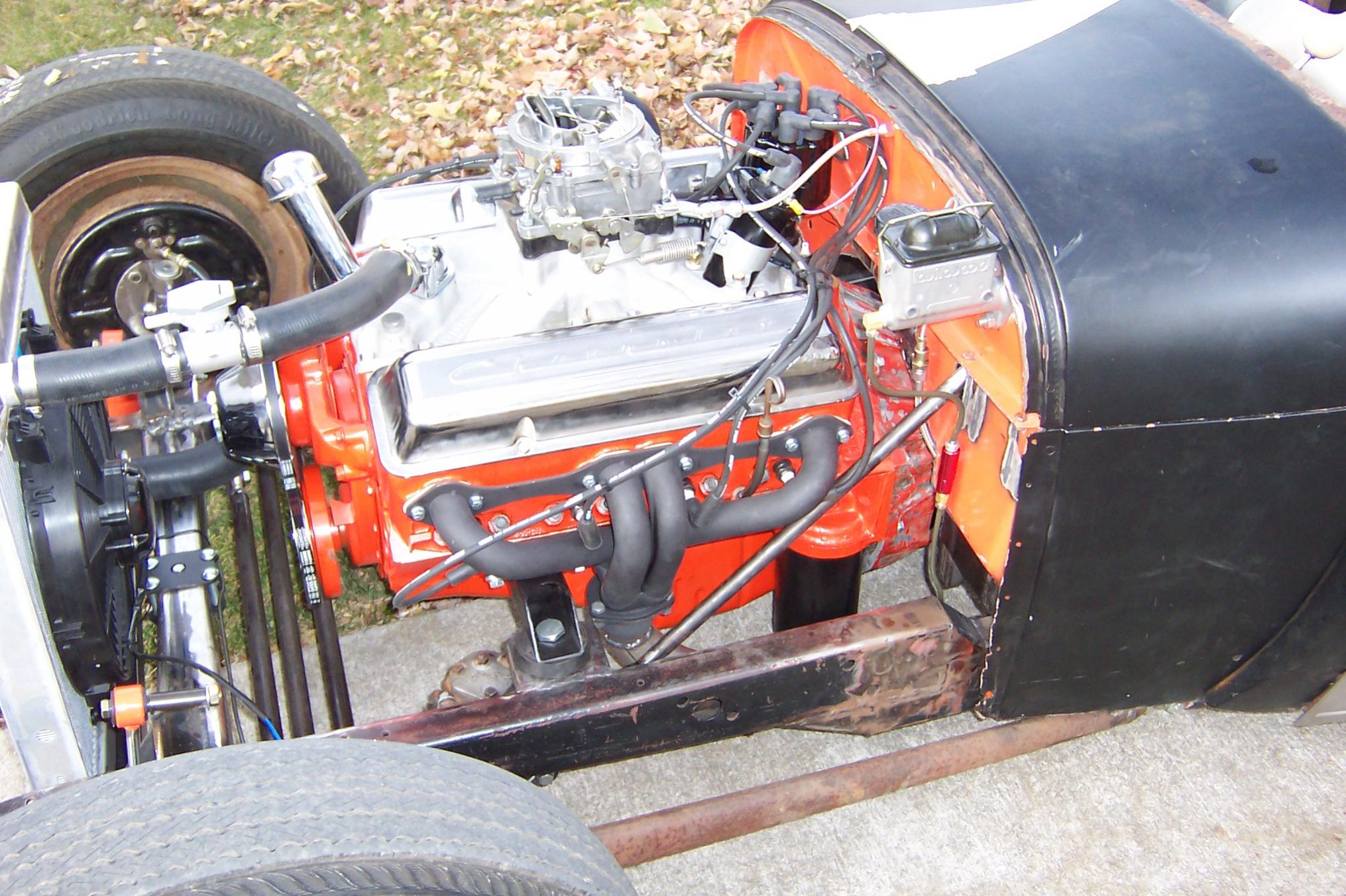

    Today was spent out of the shop doing some things I had been putting off to work on my roadster. However, I couldn't help but take it for a small cruise. I also took some more pics of some things that probably haven't been shown in much detail yet. Oh yeah, the plug wires are temporary. They will be swapped with some shorter, more appropriate looking wires.

    The radiator I am using now is a $125 19" h x 22" w Speedway radiator. It was intended for a Ford. I rotated it to be 22" w x 19" w to fit into a '28 - '29 grille shell and of course work for a SBC. I removed the filler from the radiator and capped off the opening. As you can see I am using an inline filler instead. I also had to cut and raise the lower outlet on the radiator. I will take a pic the next time I go out to my shop.

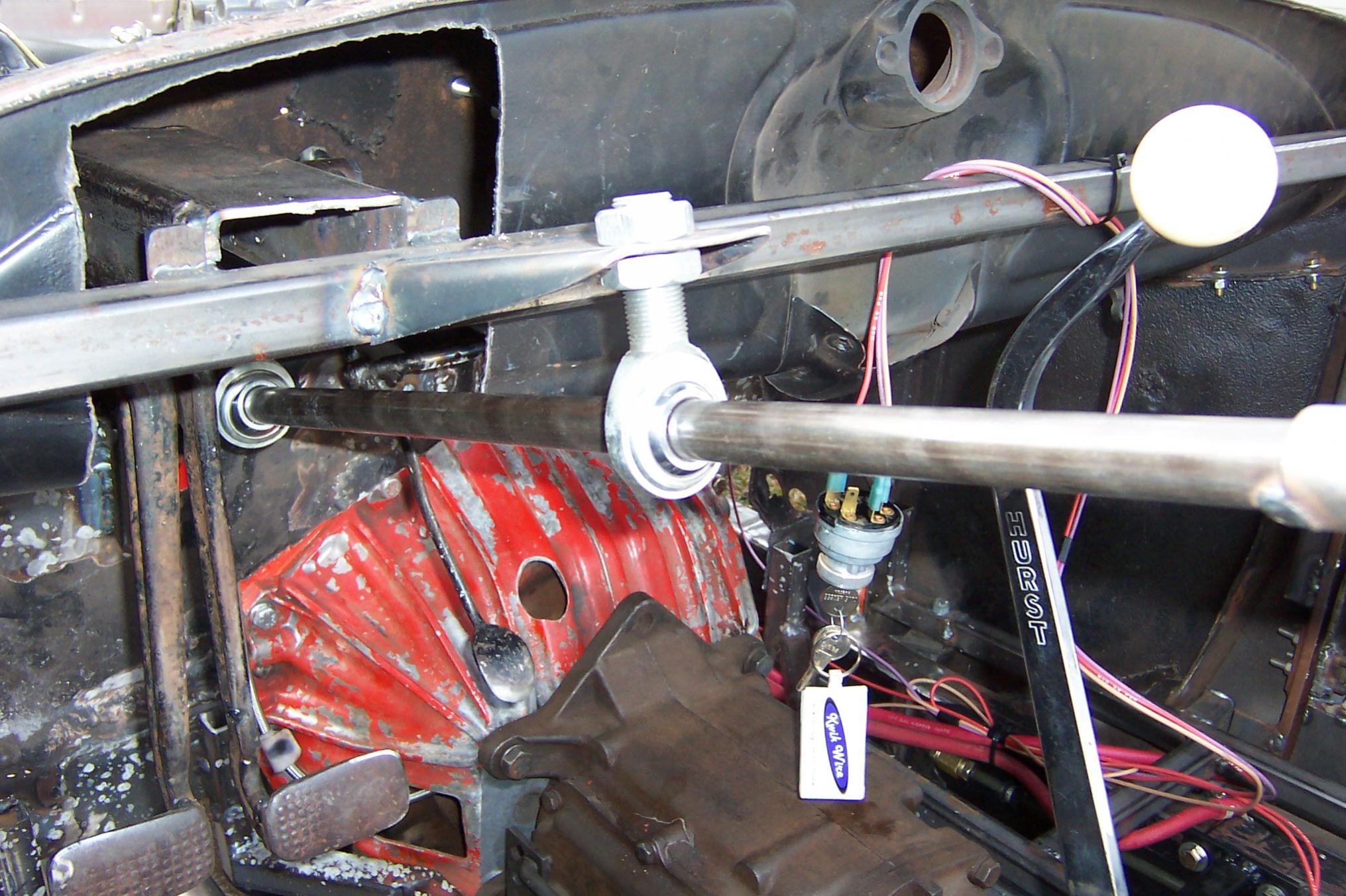

    nice roadster,what shift linkage are you useing? I had a hurst syncro-lock on my 3spd.super quick shifter kept blowing out 2nd gear syncro hubs,11 of them.haha
