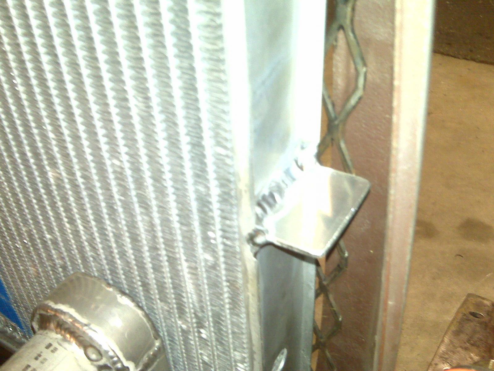

    Friday night I brought my radiator to a friend to have him weld some tabs to it. I had him weld on two tabs to mount the radiator to the saddle. I also had him weld on four tabs to mount the grille shell to the radiator.
    Yesterday was the first day in a long time I went out to my shop to work on my roadster. I worked on getting my radiator moved closer to the front crossmember and I also did some work on the doors and door jams.
    This coming week I hope to continue working on my doors and door jams. If I complete that, I would like to do some work on my clutch and brake pedal ***embly. There seems to be a bit too much slop in the pedals. Right now the pedals move about an inch before the clutch and brake engage. Hopefully that will be as simple as tightening up some things.

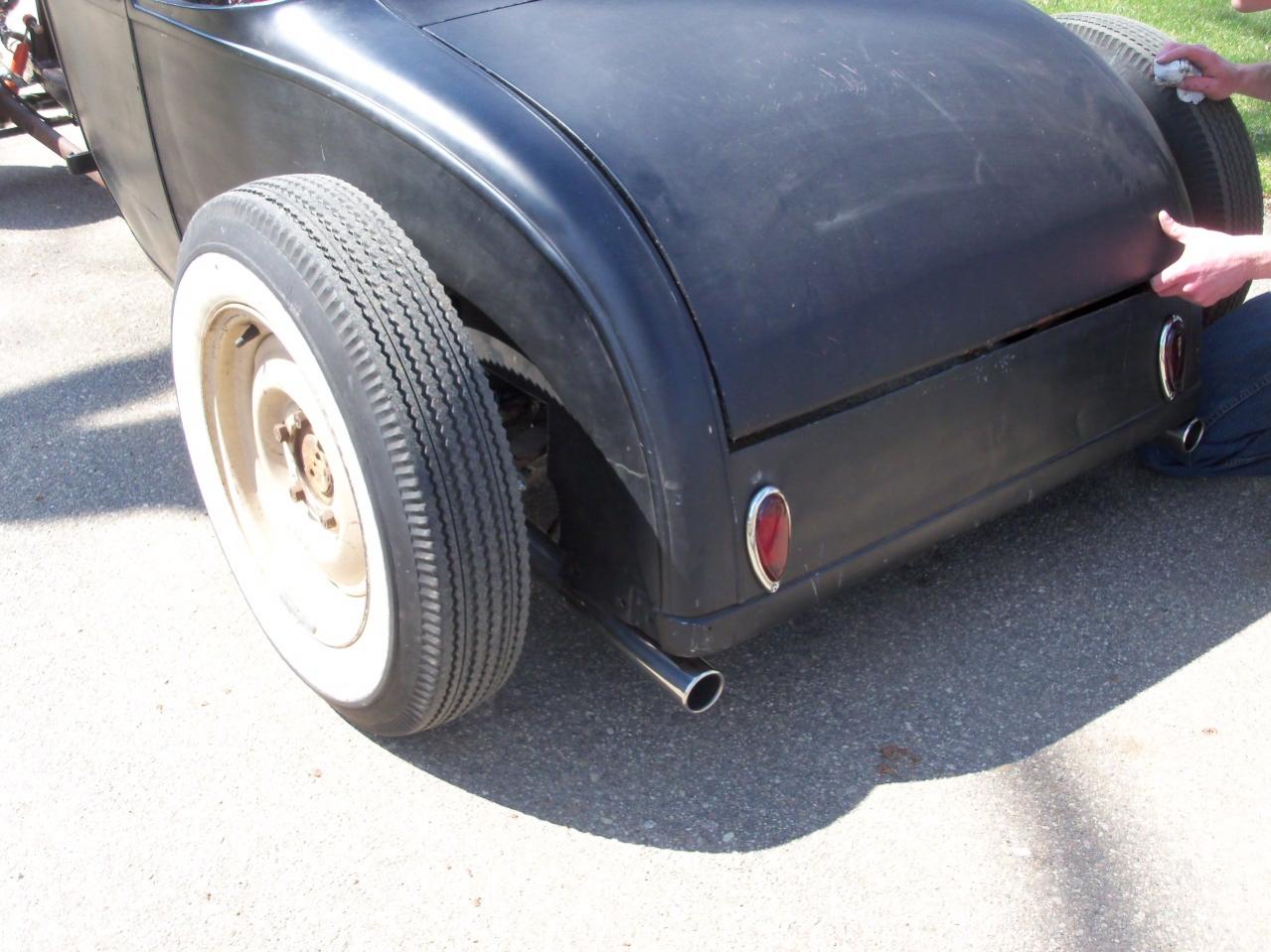

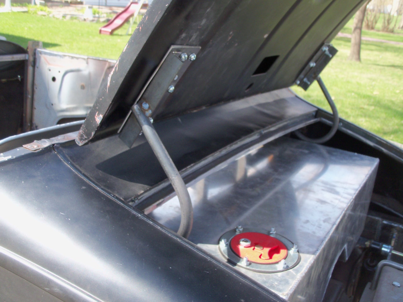

    I'm sorry I haven't uploaded any progress pics in a while. I guess that's because I haven't done a whole lot to show progress; just a bunch of odds and ends. Most recently I fabbed up some trunk hinges and some trunk gutters. I also had to get my fuel cell modified to allow some more clearance between it and the rear end.
    Also, I sent in my application for a VIN to the state of IA. I haven't heard anything back from them yet. Hopefully I will soon. I would sure like to be able to get a ***le and license for it soon as we are getting some nice "roadster" weather. I'm sure I could be doing plenty of other things while I wait that will make it more road worthy.

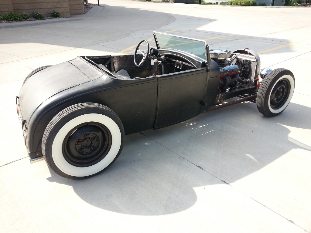

    Thanks for waking up this thread again. I have been so busy remodeling my house that I haven't had a chance to work on my roadster in months. I did, however, pull it out of my shop to take a quick spin around the block last month. I simply wanted my roadster to know that I hadn't forgot about her... because we all know that our cars have their own feelings and personality, right?
    I appreciate all the positive feedback. It is inspiration for me to get my **** out to my shop to continue working on my car.

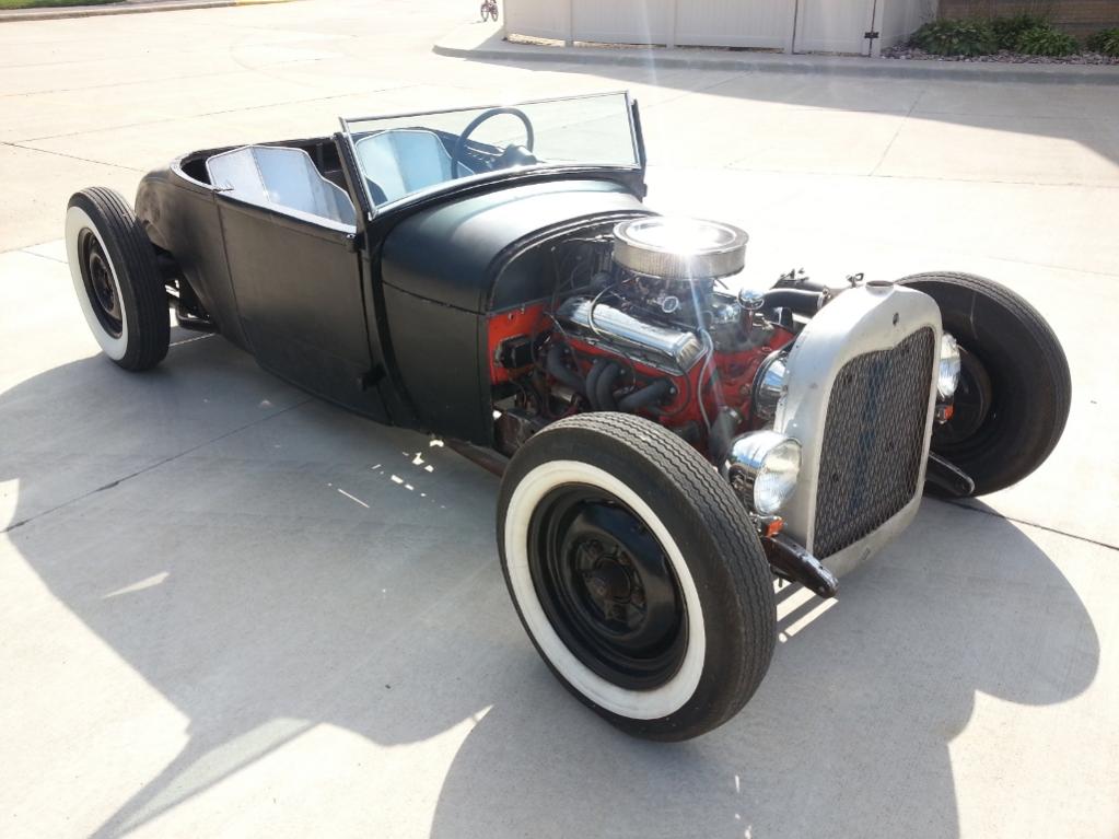

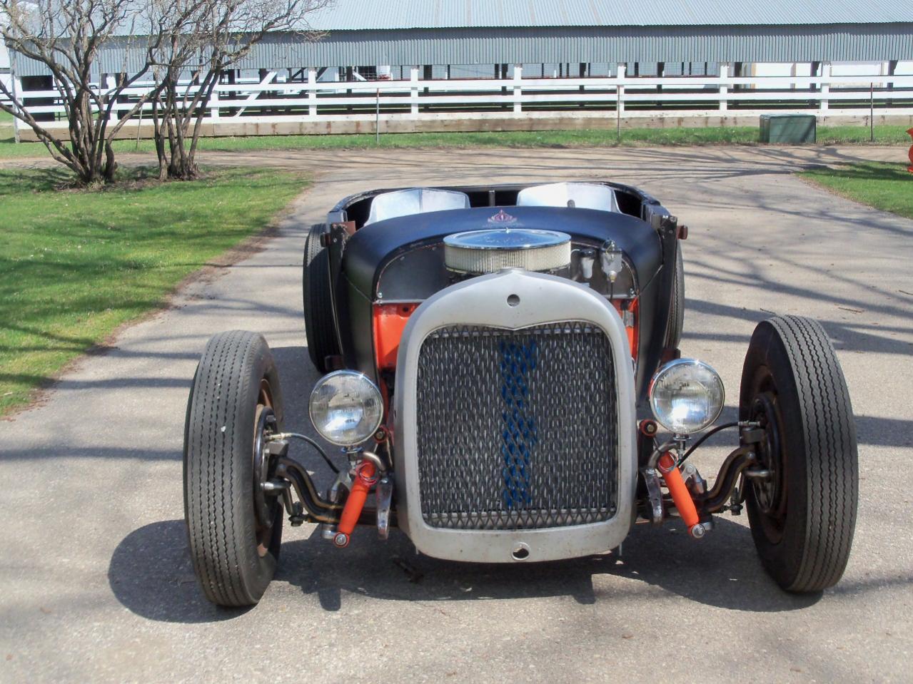

    I have been able to get back to work on my car recently. My work started with building some way to mount the windshield. After I completed that, I built a custom size roadster windshield frame. I had a friend of mine with a mill help me machine out a 5/16" channel in some 6061 aluminum bar. I then got some gl*** cut and, siliconed the gl*** in the frame.
    The next major thing I needed to do was get a license plate on my car. So, I visited the local DMV to inquire. Previously, I has acquired a VIN number and ***le by way of a DOT inspection. I thought they told me that the registration was suspended pending another inspection once the safety standards had been met. So, I asked what it would take to get my car licensed. The officer told me there was nothing stopping me from licensing it. I then did what every honest person would do and, I played dumb. The result was license plates for my car.
    Most recently I have been cleaning up some old steel wheels to mount my tires. I had heard much about the success of electrolysis for removing rust. So, I thought I should try it since there didn't appear to be much to lose. Let me just say that the results are amazing. I'm sure if you ask 10 different people who've done it what they did, you'll get 10 different variations. In my case, I did everything everyone else does with the exception of subs***uting baking soda with 20 Mule Team Borax. I would let my wheels sit in the solution for 12 hours, power wash them, flip them, and put them back in for another 12 hours and power wash them again. The results were amazing. The rust and in some cases paint would be falling off when I removed them.
    This past Friday I had some tires mounted and balanced. I felt as if my car was ready for a hiway test. I didn't even make it out of town and my front end started the death wobble. I brought it back home and scratched my head for the rest of the night. On Saturday morning I went out to my shop to try to resolve the wobble issue. The first thing I checked was the toe. I found that I had 3/4" toe in. Once I got that to about 1/16" I took my car for a test drive. This time the wobble was gone and, my car was hiway ready. And, that's how it is now.
    The next step will be to work on the interior stuff for a while... floor boards, dash, seat pads, etc... I hope to be able to drive my car out to Outkasts in Mitchell, SD in a month.
