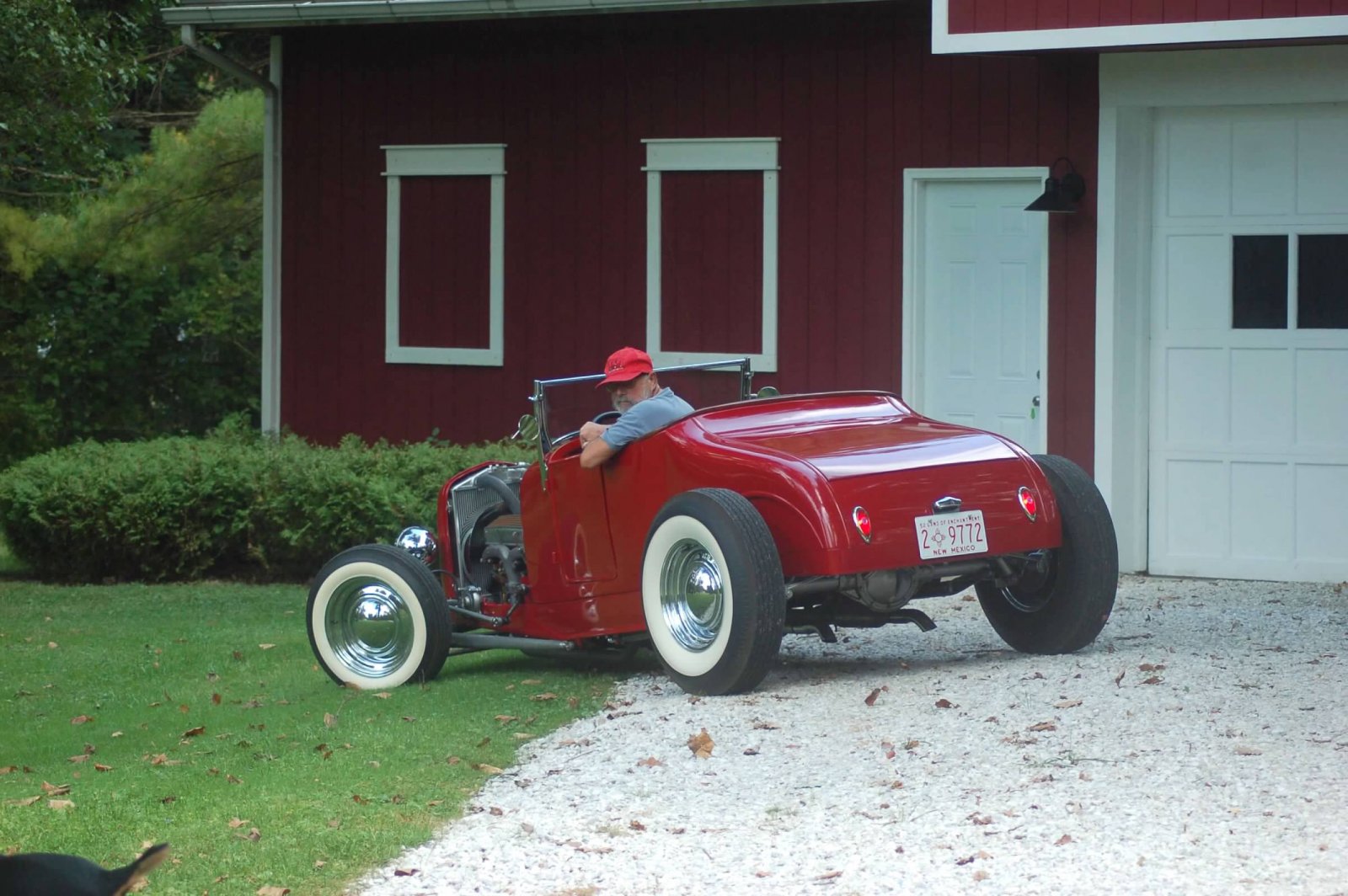

    I hope you weren't talking about mine.

    No, the OP mentioned “will be a test mule as he builds an engine…”
