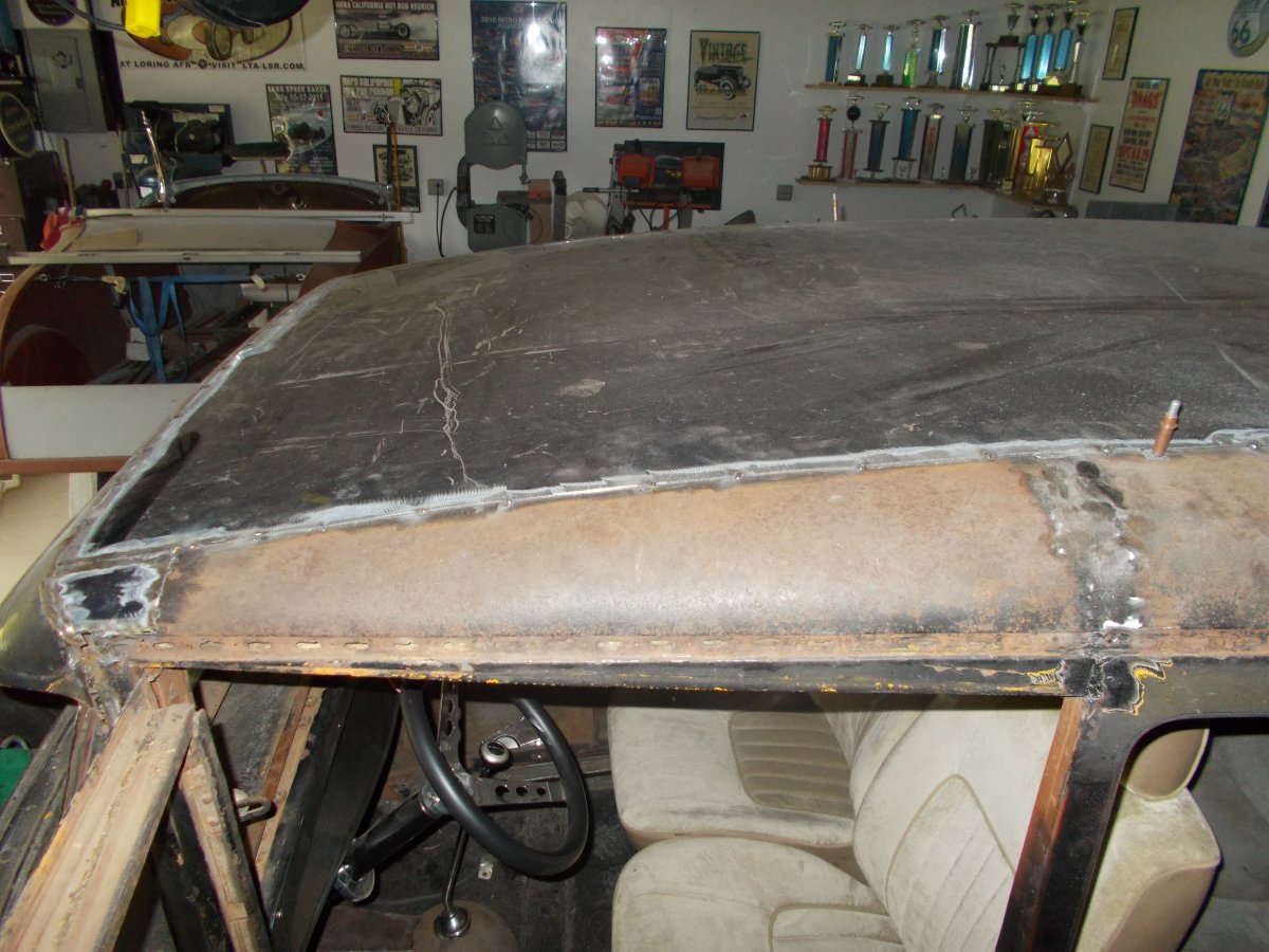

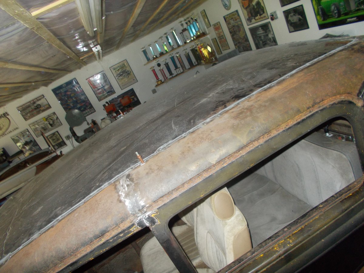

    You may be surprised. I found that an '86 Toyota minivan fit my '28 Model A Tudor sedan perfectly, both lengthwise and laterally. Here's a thread that shows my steps:
    https://www.jalopyjournal.com/forum...e-6-steel-roof-covered-by-stock-vinyl.636247/
    I hate to sound negative, but around many metropolitan areas, junk yards shred anything older than ~10 years. :-(
    EDIT: The pictures in my roof thread were "kidnapped" by photobucket. I've since replaced them with the same photos, but hosted here on the HAMB.

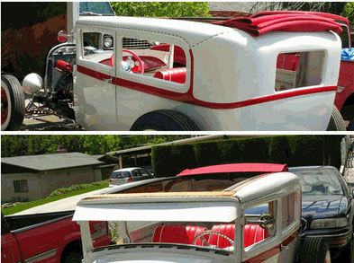

    Okie Pete, tommyd, Almostdone and 6 others like this.

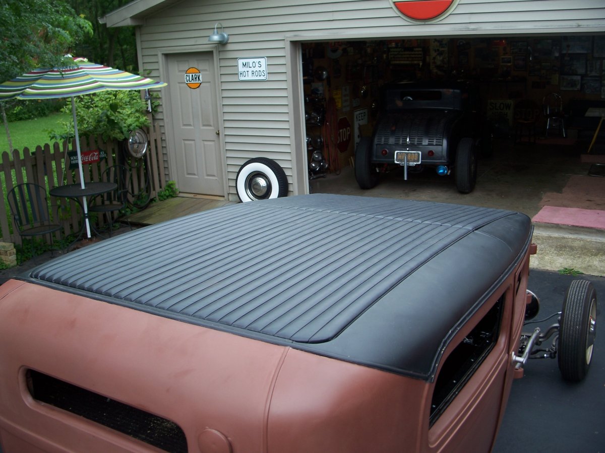

    Okie Pete, els, porknbeaner and 2 others like this.

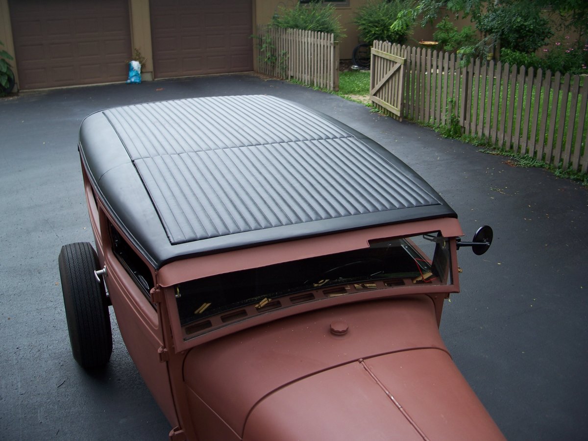

    Okie Pete, els and gbgh like this.

  19. 28TudorAZ
    Joined: Dec 29, 2016
    Posts: 114
    28TudorAZ
    Cause it gets really hot in AZ.
    dirt t, hemihotrod66 and els like this.

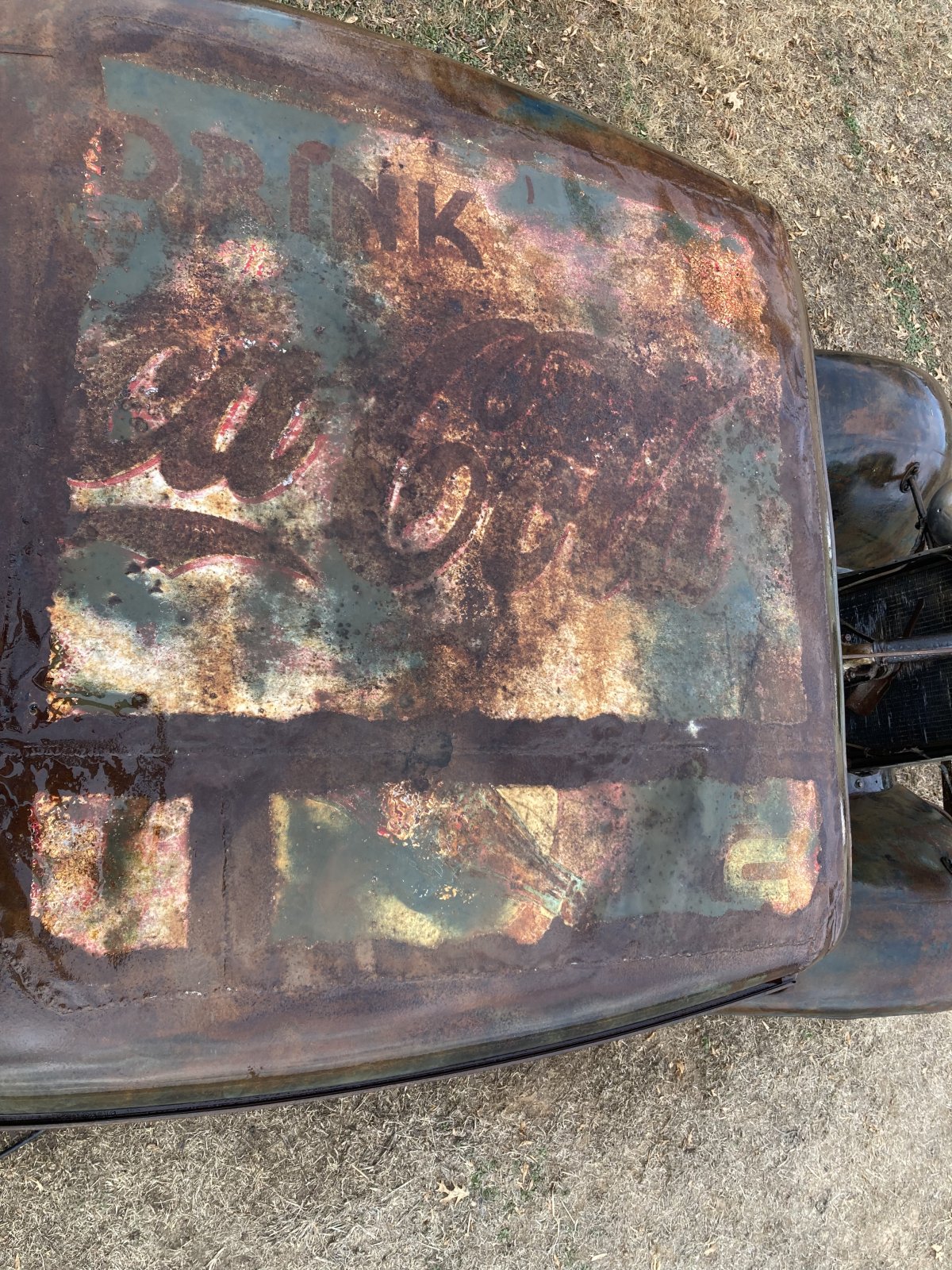

  29. Okie Pete
    Joined: Oct 29, 2008
    Posts: 6,599
    Okie Pete
    IMG_4807.jpeg Here’s what the previous owner used
