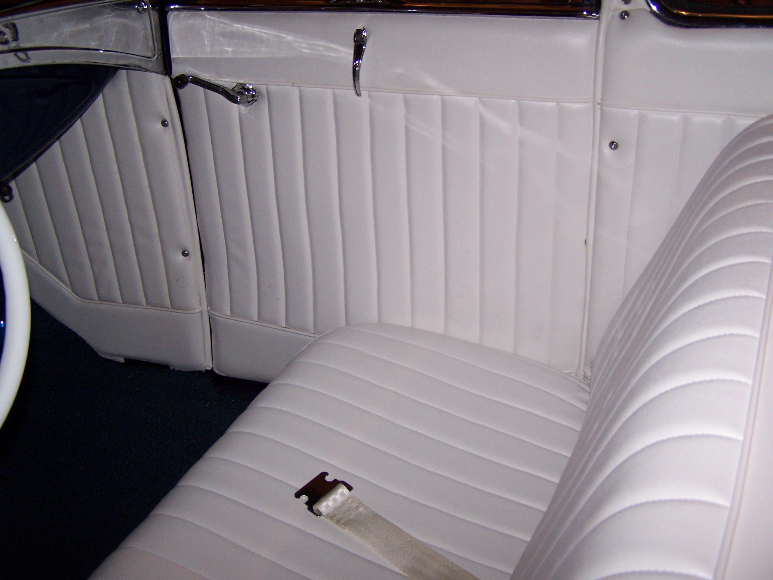

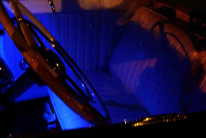

  26. Here are 80s Chevy van in my t. Friend has same in his a
  27. A Rodder
    Joined: Jul 13, 2008
    Posts: 2,474
    A Rodder
    Here is the one I just put in my coupe
