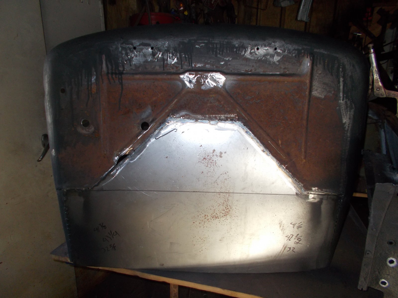

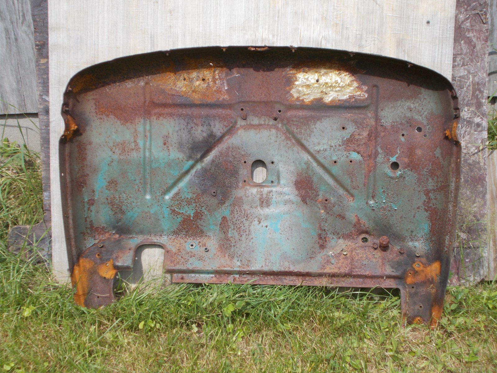

    side panels are easy... much harder to make the top if longer than stock...
    reversed '30-'31 firewall will buy you 3"-4" more engine room...

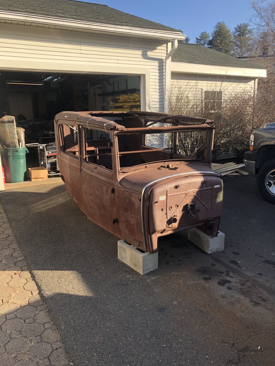

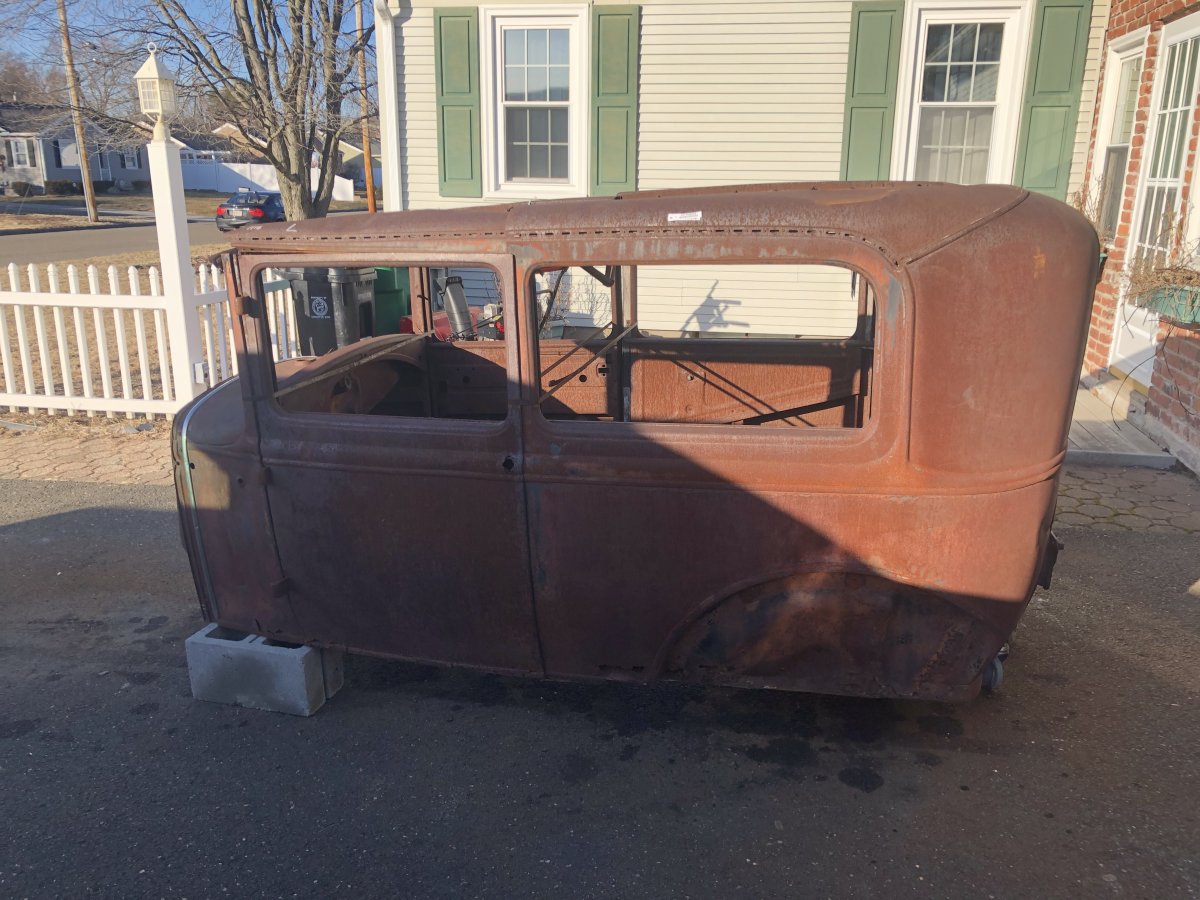

    Hey all,
    Thanks for everyone's tips and dimensions. Going roughly on the 75" from the rear axle centerline, it looks like it will be roughly a 2-3" firewall recess with the radiator in the right location. I won't be running a traditional water pump. It will be a remote mounted electric pump so that I can control the flow volume/time in radiator so that I can make the best of the stock size radiator. It's a dual core '32 aluminum radiator.

    Matt, as Smitty has suggested turning the firewall around gains you about 3 inches. He is a master at building A's from scratch pieces and making them look right.
  6. A little more info on my car, The engine is a Y block Ford, the firewall is not cut or reversed, I stretched the frame 5 1/2" the radiator is mounted in the stock location I have the engine mounted low in the frame so I have a flat floor, right now I'm running an automatic trans (a Ford-o-matic) but I have a 3 speed ready to go in. I'm 6' tall 245lbs and I fit fine, it can be a little hard to see stoplights at times but not too bad. remember it's a 4" chop and 2 1/2" channel. Like I said I have a rear seat but it is shortened and lowered a little and have the gas tank behind the seat.
    Just to be completely clear on the measurement I posted, that is from the center of the rear axle to the front side of the lower "foot" of the firewall. Now the tape had to curve out a little to go around the side of the body to measure and like I said, my subframe and door sills are all home made so they could be off a little.

    X38 - Stock location yes, and full size 32. I will be using a different style cross member from what is pictured. I will be moving the cross member forward, adding radiator mounting tabs in stock location, then lowering the radiator mounts to accommodate the change in chassis from stock.

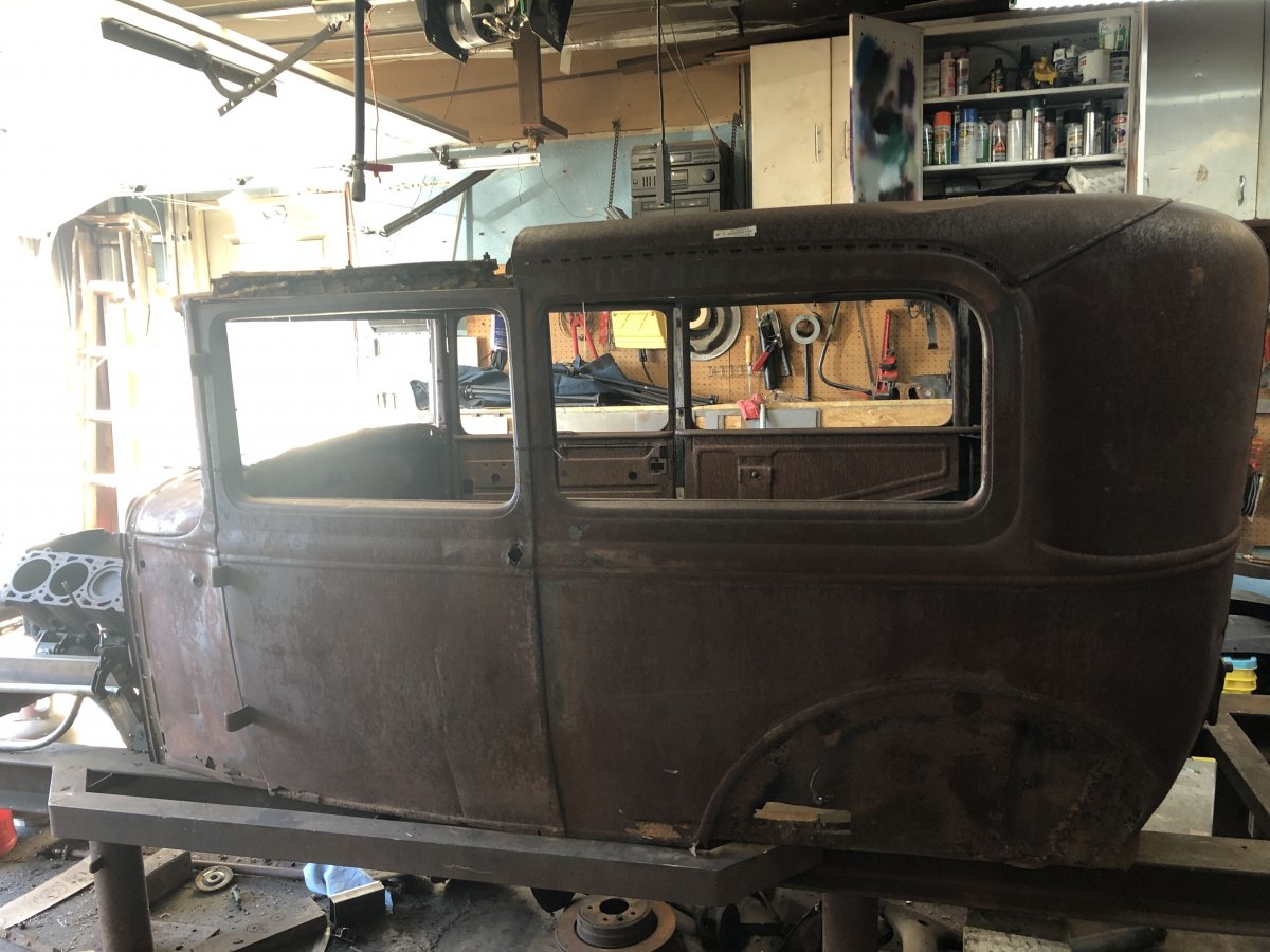

  13. mattyrz05
    Joined: Nov 20, 2012
    Posts: 49
    mattyrz05

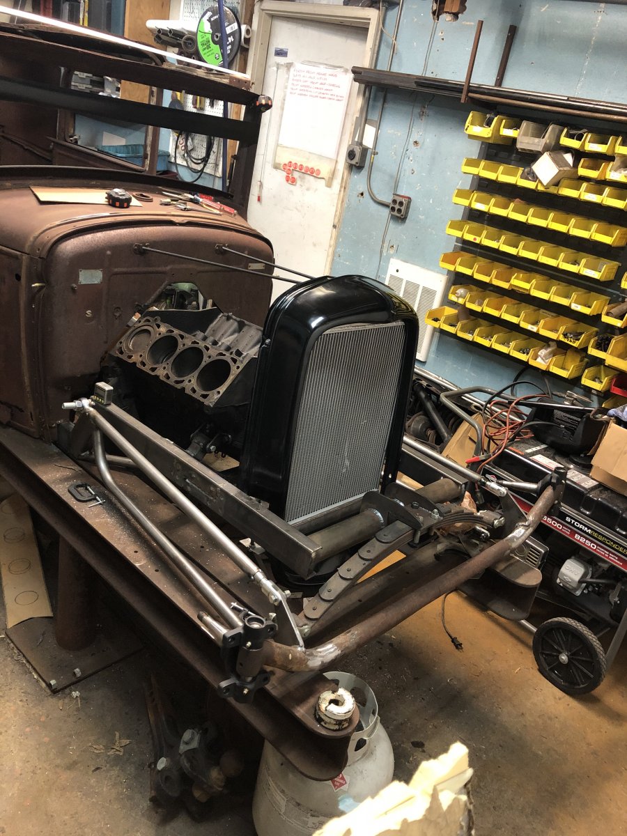

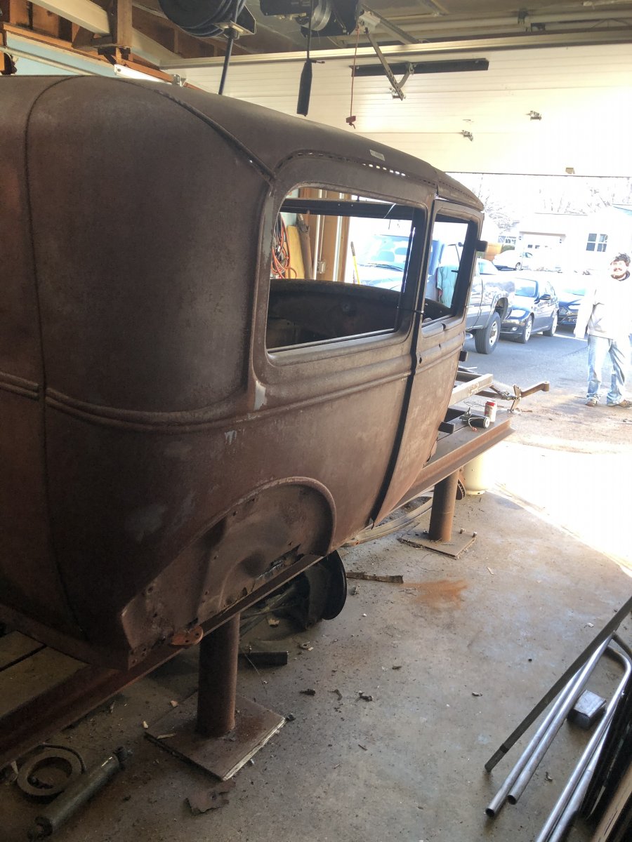

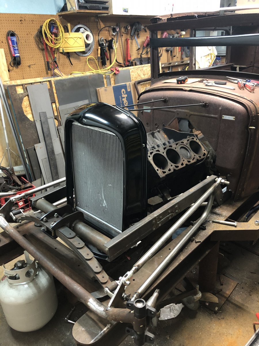

    Hey all, Have an update. Things look good. I think all the measuring went right.
  14. So I see you got a body, how about some more photos.
  15. mattyrz05
    Posts: 49
    mattyrz05

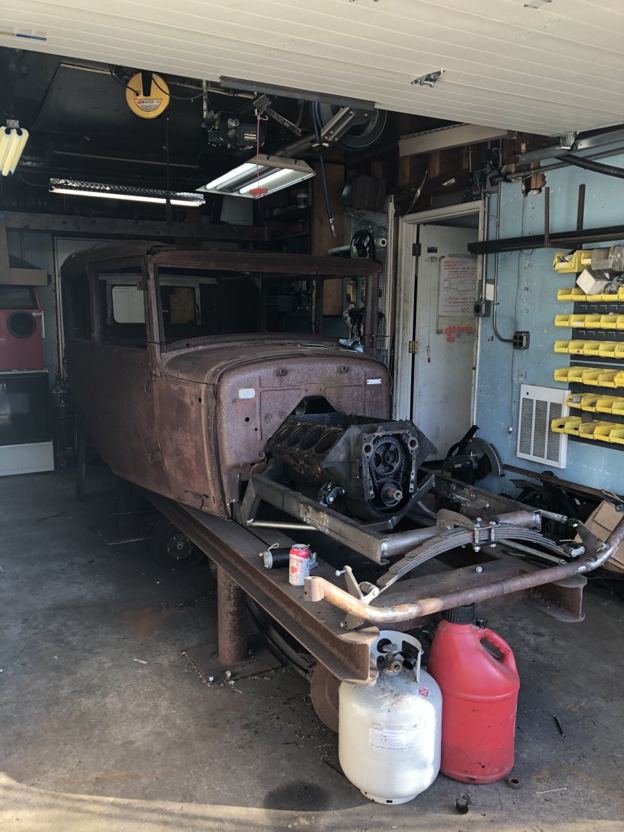

    Here are a bunch of pictures, now it’s time to finish front and rear suspension

    Working on the radiator and grill shell now. Front suspension is 95% mocked up. Need filler panels for the hairpins.
  17. mattyrz05
    Posts: 49
    mattyrz05
    Hey everyone, a lot of you have suggested running the firewall backwards to gain some room. I don't think I'll have the room for that, but could be very wrong, as I am intending to run the original gas tank. I'm going to end up pushing the radiator forward about 1 1/2" to make room for electric fans and a water manifold to go where the original water pump resided. The current plan is a remote mount electric water pump. Now to find a compact balancer and a single groove pulley. Gotta find a flat one, space is of a premium. Maybe I'll make one on the lathe and bridgeport?

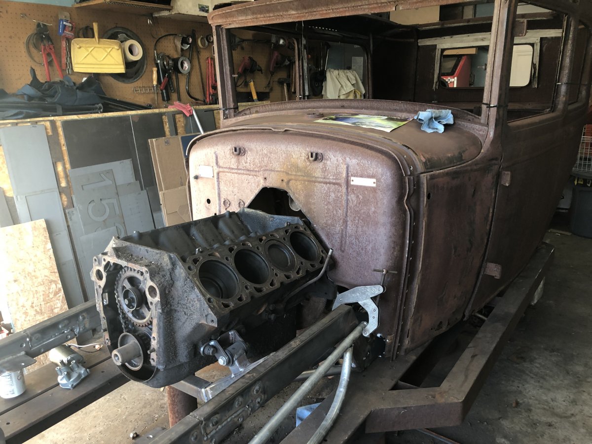

    Kevin Ardinger
    Exactly what I was thinking! It looks like the engine is way too far back!

    Kevin Ardinger
    Looks like it worked out fine for you. From the pics of the frame I thought the engine was too far back. Looks great! Now it just needs to be shortened! LOL

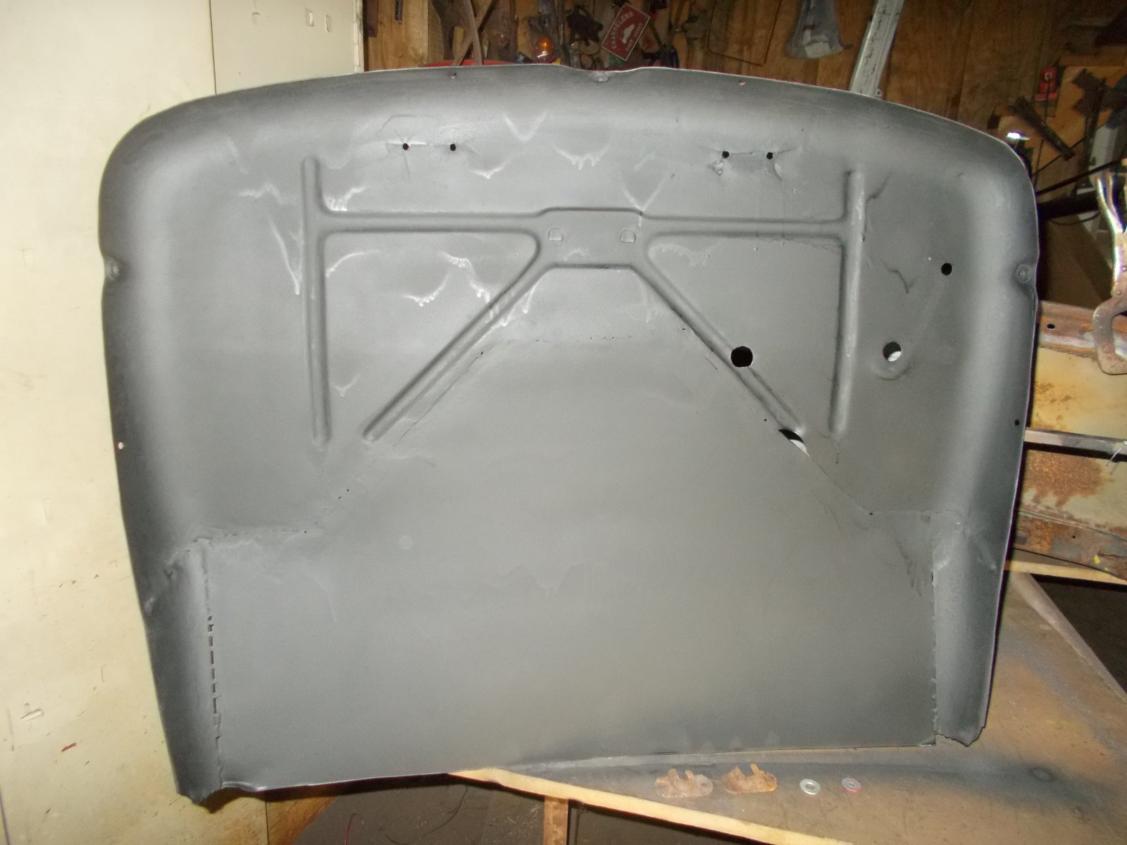

  23. sloppy jalopies
    Joined: Jun 29, 2015
    Posts: 5,256
    sloppy jalopies

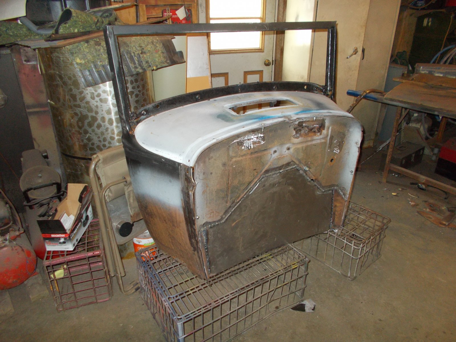

    i just love the stich work... pic of reversed firewall... go matt go ! DSCN4441.JPG DSCN3564.JPG DSCN3565.JPG DSCN3556.JPG

  28. sloppy jalopies
    Posts: 5,256
    sloppy jalopies
    stocker is about 4.25" from firewall to tank face...
    stocker tank to cowl edge is about 2" ...
    my reversed is about 1.5" from tank to cowl edge, i removed about 1.25" of firewall to cowl edge from the firewall, basically the offset that sits inside the cowlside when stock...
    you could remove more from the firewall if wanted...
    have one cut out, need it or pix ?.
    mattyrz05 likes this.
