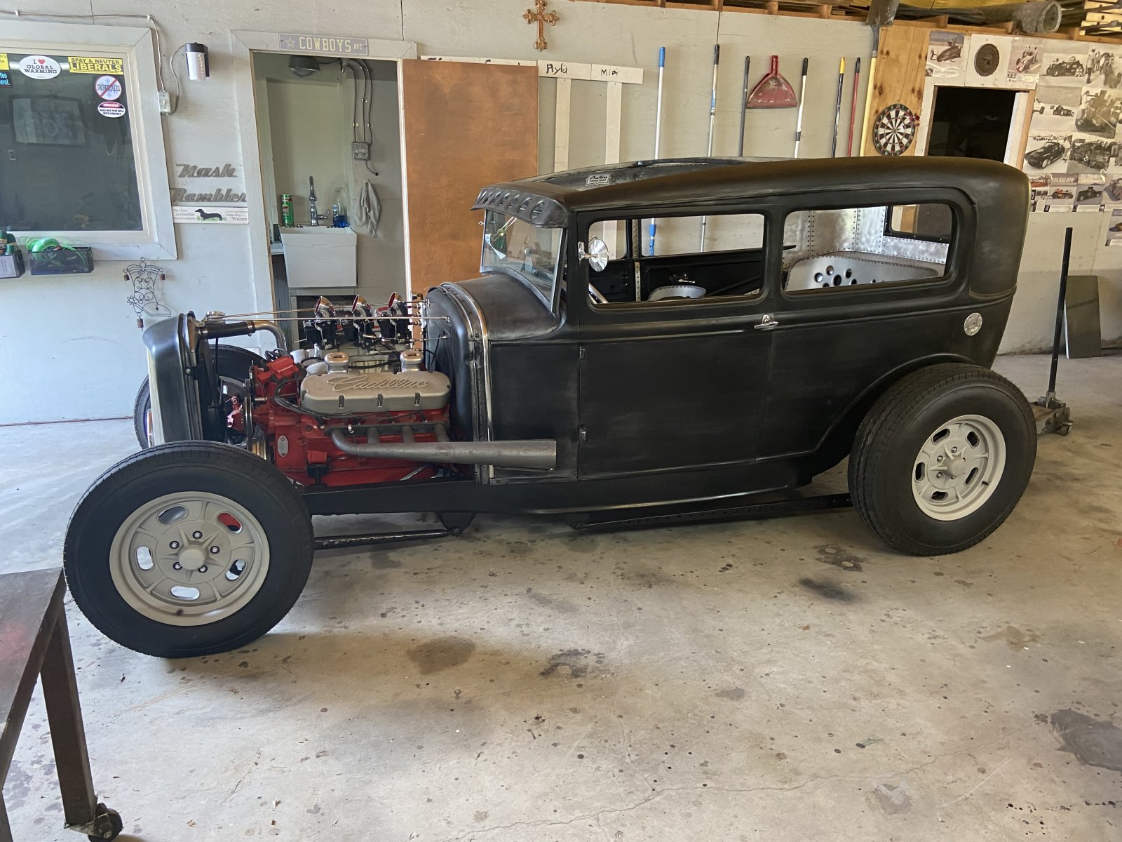

    This is my Model A, when I built it I did not fill the roof and now I'm rethinking my decision. At the Roundup this weekend I saw a car with a sheet of aluminum over his and I thought it would tie in well with the aluminum on the inside of my car. I will be fabricating two more bows to go on each side of the one that is there. I want it thick enough to be sturdy but thin enough to work with. So my question is: how thick should the sheet be???? Bless me with your knowledge guys!

    I would use .050 2024T3 aluminum,
    this should be thick enough to not oil can
    do you plan to roll it a bit?
    if so .040 may work for you

    I'm planning to roll a little to match the existing bow that's there, plus add two more bows and the sheet will be on top of those.

    Do you plan to buff it?
    2024 has a thin coat of pure aluminum and will buff out very nice
