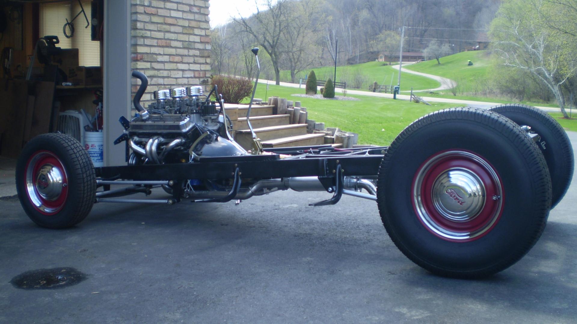

    ImageUploadedByH.A.M.B.1389236428.248754.jpg . We mounted our new tires, I know they aren't bias ply but we wanted a better ride.do you think we have too much rake?

    It's perfect, don't change a thing.

    Thanks ,we like the crazy rake look. Just hoping it didn't look goofy,and cause driving issues. Too bad I had my inner fender wells all patched up,because they rub. Going to have too do a minor tub job.
  5. IMHO,there is no such thing as too much rake!
    and Bias Ply tires ride great. HRP

    Seems a little high in the ass, to me.
  7. Just a tad high, looks to have a 70s rake going on imo. JW

    yep, looks like Cool 70's - might need to modify seat base so that you lean back a little to have a better ride for you.

    A noticeable rake is nice,but,and just IMO,when it starts to look like a fat girl sat on the cowl,it needs to be evalulated.

    fronts are 145 sr 14 Michelin 24 inches tall, rears are 31x12.5.15 hoosier. I wanted to match the fenderwell as much as possible. It's are first build so it's all pretty new to me.

  18. I like it !
    4* seems to look great on a hotrod.
    The problem I encounter is with 4* rake and the engine sitting at 3* the other way - makes a 7* visual problem at cowl to engine relation.

  20. check your caster because changing rake changes your axle inclination/angle

    I would love to have that, but the 32 frame was out of my budget :( I am also struggling with just patch panels and the chop.
    Never thought of the castor, Whats the minumum I can get by with there?

    I shoot for 5 minimum...I , personally, like around 7 degrees

  24. I like the rake,but the wide steamroller tires on the rear does scream the 70's. HRP
  25. I think you can have to much, but yours is not one of those. It's perfect, I'd leave it just like it is. I struggled with getting it right on mine and it looks like we have about the same rake and similar size ( diameter ) tires. The only difference is visual difference with the fenders on mine. IMO.
    I read 31 Vickys reply and thought wow. so I just put my magnetic angle finder on the air cleaner and it reads 1 degree down in the front, when I set up the drive train I used the 3 degrees down (trans) 3 degrees up (rear end) formula with the frame level to the floor, so I must be at 4 degrees rake with the tires on. I guess the bottom line is, how does it look when it's sitting and yours looks good.

    & yeah, check the Caster...

    little to much rake for my taste. it has a nasty look to it with the rake and blower
