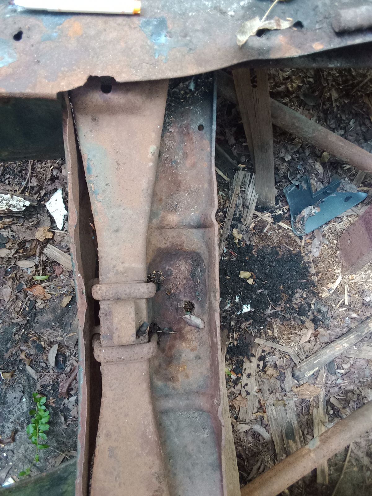

    alchemy and 05snopro440, I'll see if I can get the PO's daughter to send me pics of the crossmember. If not, then I'll make the visit this weekend and take a couple pics.

    The front crossmember will tell us what sheet metal was on it originally. Switching the grille would require switching the crossmember to make it fit properly.

    The 7/8" drain hole in the crossmember wasn't added until January of 1930, his frame was produced in December of 1929 and more than likely does not have the drain hole. It should however have the two depressions where the radiator bolt holes are that were added in October of 1929. Do you have any sheetmetal for this car?

    Ford COULD NOT produce a 1930 with a 1929 Front crossmember, couldn't produce a 1929 with a 1930 front crossmember. The radiator mounts are different.

    Pictures are in, but they don't show all of the radiator mounting pad areas. She didn't send pics of the fenders. Hopefully, there's enough to tell whether it's a 1930 or 1929 (fingers crossed it's 1930).

    Your crossmember does not have the 7/8" radiator drain hole, so it was built before November of 1929. It also shows the early style starting crank bearing A-5461 and the A- 5455 spring clips, ("U bolts"), phased out in February of 1930 and early style radiator splash apron.

    Don't recall seeing the rolled bead on the back of the crossmember, what is the history on that?

    That’s an AR front crossmember that had the rear tabs cut off. That means early 28.

    Thanks, alchemy! I'll recheck the serial number, A2715606, this weekend. The last digit was the most faded. Perhaps it's not a 6. Although I didn't get the desired outcome on the chassis, there's a silver lining to this. I've been collecting parts for a 28/29 roadster build so I can add the chassis to that collection, send the '30 down the road, and get a couple more bucks to add to the roadster bank.
