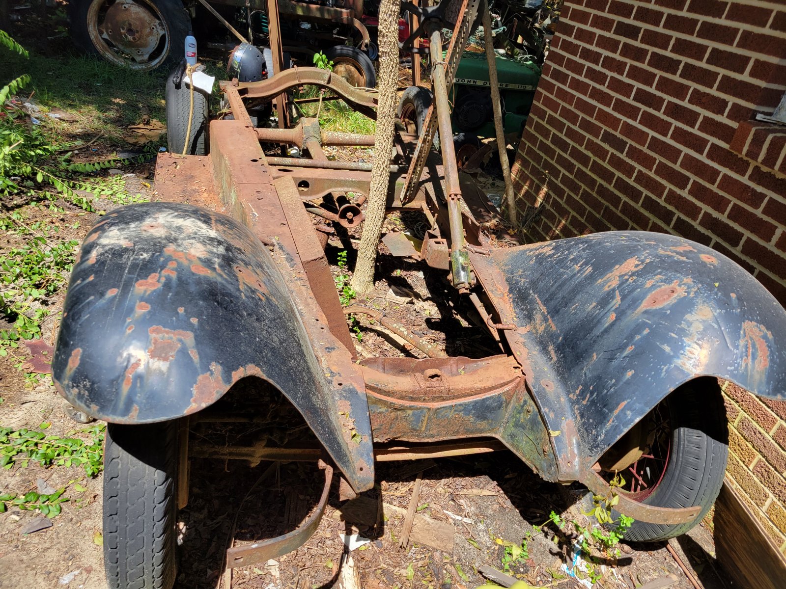

    Looks like 30/31 fenders and apron on that 28 frame. Or maybe it’s only the 28 front crossmember in a later frame? Was it riveted in, or bolted?

  3. alchemy
    Joined: Sep 27, 2002
    Posts: 22,579
    alchemy

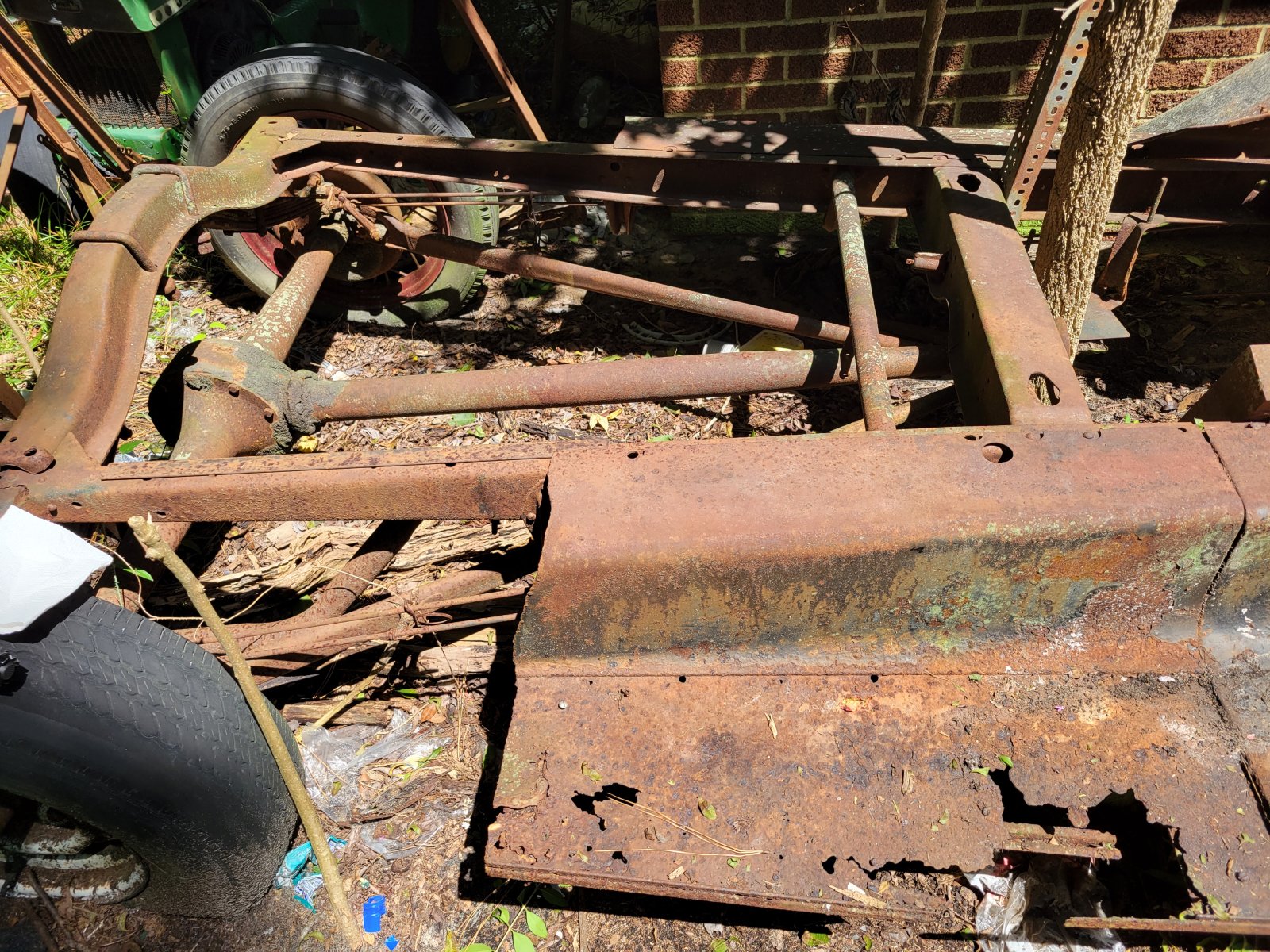

    He did show us pics Woody. The front pan and fenders are not 28/29, they are 30/31, but the front crossmember is early 28. So if the stamped number is really from December of 29, it’s a true mutt.

    Where are the pictures of the fenders?
  5. alchemy
    Posts: 22,579
    alchemy
    On either side of the crossmember. If you can’t see those aren’t 28/29 fenders from that little bit of pic, you might not want to give identification advice on them.
    The rolled edge over the front apron. The lack of the small riser blocks that the hood shelves fit over. The notch for the radiator bolt. And the top edge of the apron has an offset under the grille rather than just the simple return that 28/29’s have.
  6. woodiewagon46
    Joined: Mar 14, 2013
    Posts: 2,515
    woodiewagon46
    from New York
    The bottom line is, if he is trying to register that car, it still goes by the serial number stamped on the frame. The Model A Ford is probably the most researched and documented car in history and in New York State if you try to tell the DMV examiner that the car is a '30/'31 because of some clapped up, rusty fenders, with a 1929 serial number, he will tell you to take a walk.

    I made a visit to the PO's place today and took some pics of the sheet metal. I also gave S/N area a good cleaning and found the S/N to be *A2715066*
