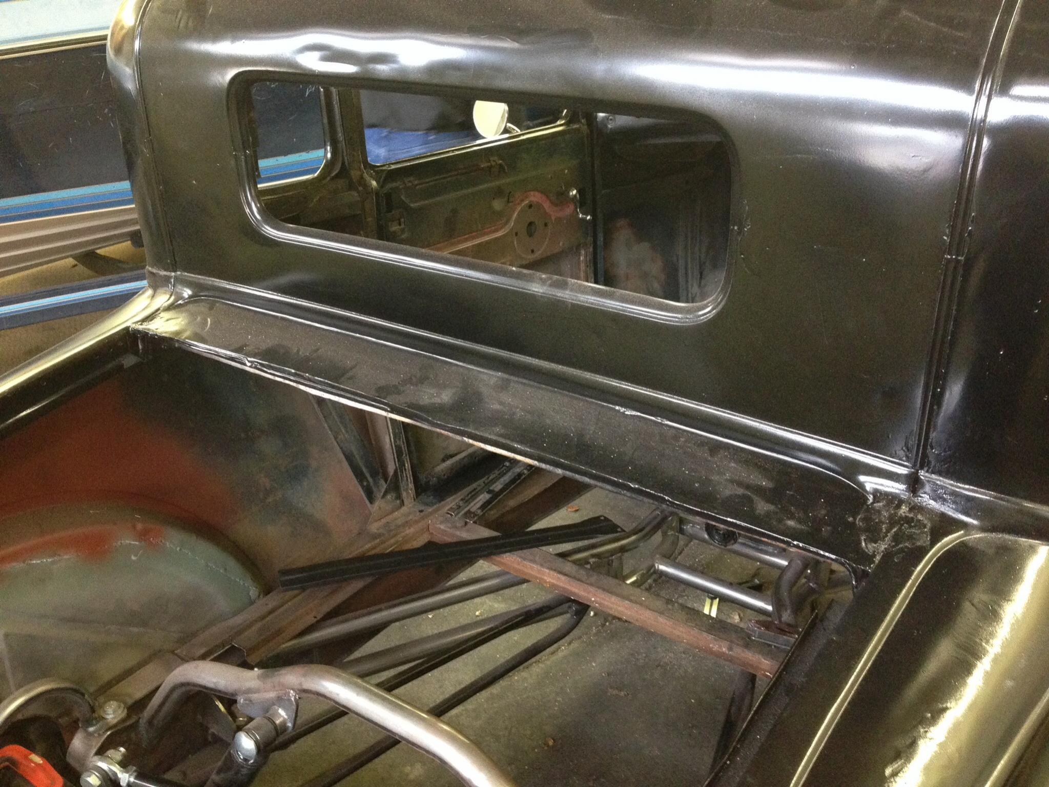

    Hey Model A people, I'm looking for a source to get a sheet metal panel for my 1930 Model A Coupe. The panel I just can't seem to find is located above the trunk and below the rear window. Mine had a couple of inches of filler. I don't want to sculpt a new one. It would be easy enough to fab, however, there are some body curves that are on the edges, and my skills aren't up to it.
    Does anyone know what to call that panel, and if it is reproduced. I can find darn near every other, but can't seem to locate that one. Thanks for your help!

    I don't think you will find anyone selling a replacemnet because on the A Coupe it is not a seperate panel (it is part of the rear window panel).
    I did a pretty good hunt for one as I wanted to replace mine but in the end I couldn't find antone that made them so I repaired what I had.
    If you have some luck in finding a repop please post up the details.
    Cheers

    What you have looks soild form the pictures. Can you tap it into shape?

    Looks solid, but who knows whats hiding under that paint and bondo? (unless I'm seeing it wrong and that is infact bare metal)

  14. To me it looks like black over some very rough bodywork. Had to blow up the pics and look at the light reflections to be sure though. The panel he's talking about might be swiss cheese under the mudwork. These also might be pre-work pics and the car has been since stripped to bare metal.

    I had a similar problem. The rear panel I had to use was missing that section on both sides (no wonder I got it so cheap!)
    It's not reproduced, you'll have to repair it or replace it with a donor piece.
    It's a tough repair as the flange below it bolts to the quarter panel and the rain gutter is attached to it.
    As already mentioned, on the A Coupe it is not a seperate panel (it is part of the rear window panel).
    I was able to get a section from a FordBarn guy. It was from a coupster (roof cut off). but it wasn't high enough to fill the void. I fabbed up the top little piece and it all cleaned up pretty good.

    It's called a tulip panel, not a daisy panel. Nobody makes it for a coupe, but a roadster should have a lot of the shape you need at the back edge. Get one for a roadster and weld it into your coupe's beltline. Call Brookville for the best roadster panel.

    I looked into the roadster panels from Brookville. They call it the "Above the Deck Lid Panel".
    You won't be welding it to the beltline without sectioning a couple of inches out of it It's much wider that a coupe. Plus the body line is down on the panel rather than up on the window panel.
    It's 240.00 for that panel and I think it would be a last resort.
    Yours doesn't look that bad. It would probably be best to remove it from the car and fab up some pieces.

    Thanks to all those who replied. I'll try my hand and if I butcher it, I'll give brookeville a call.

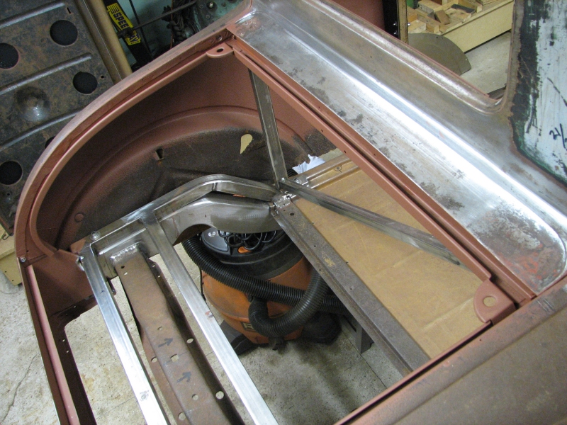

    Hey did you ever get this taken care of? Id strip it down and see exactly what you need to replace. Then Id call Metal Twister at his shop in San Diego and have him build you one? Give me a call man... I was just looking over mine and it doesn't look like it would be that hard to build one for ya. Bet I can build you what you need! We do way more than just seats....
