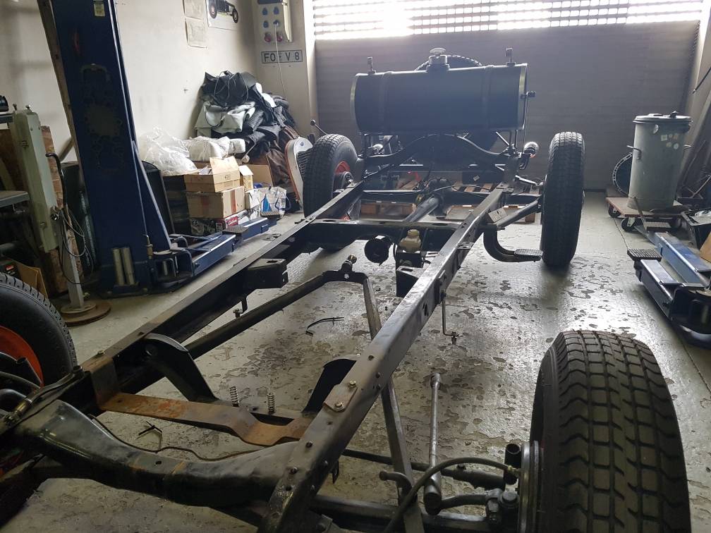

    Karma threw me a punch with this one. It's one of those Argentinien built Model-A speedsters which came in the shop to be lowered 2" all round and get a flathead V8 fitted.
    Seemed like an easy project, but I kept finding "interesting" engineering everywhere. I'm surprised it ever drove anywhere under it's own power.
    This is the frame after removing the body and banger engine. Seems to be a modified AA ch***is or maybe a more recent remanufactured one. It has a set back engine and riveted in kick ups at the rear.
    The body has huge hidden compartments under the floor. They'll be cut out, as the current owner isn't a drug smuggler.

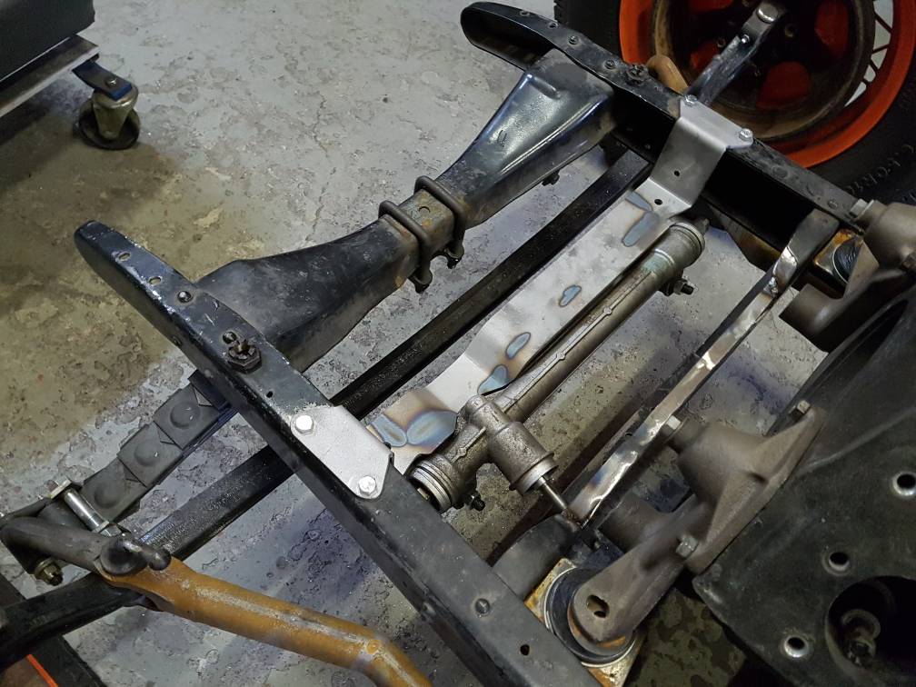

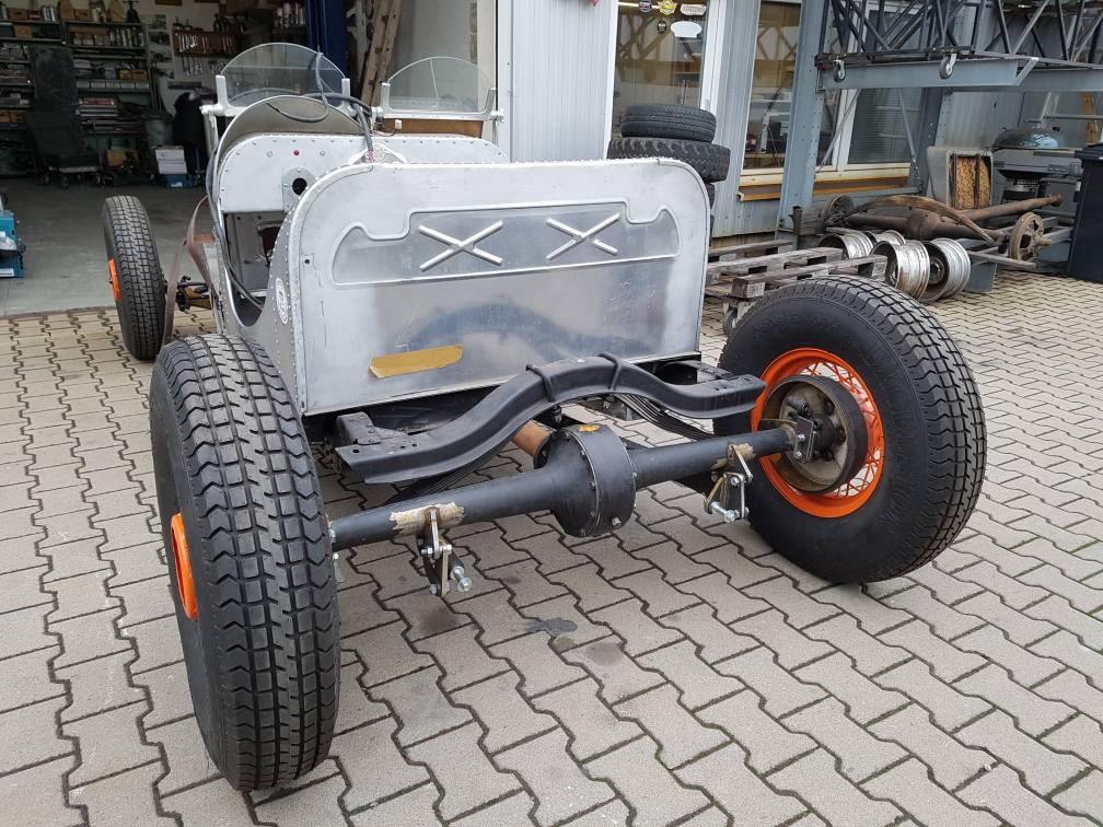

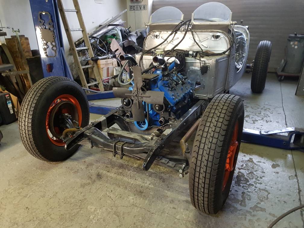

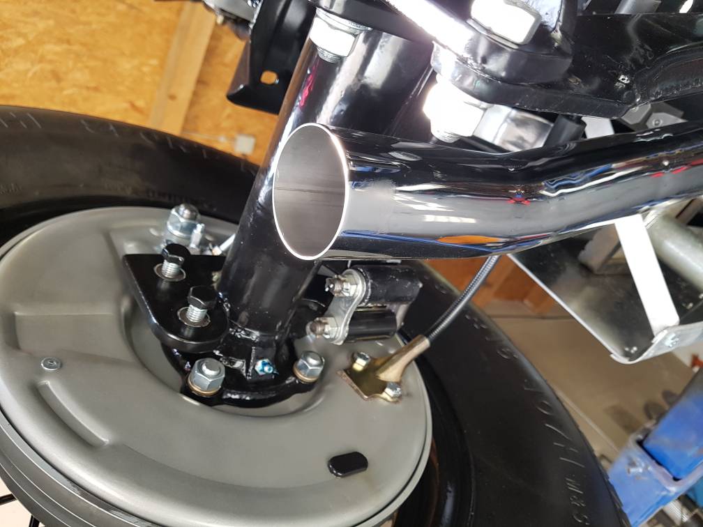

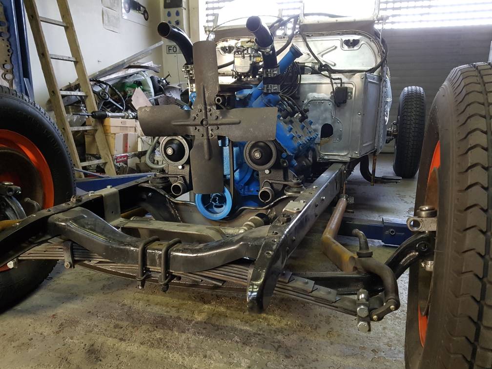

    Here's the mock up so far. I repositioned the rear axle 3" behind the rear spring and made weld on hangers to lower it 5" at the rear. With a new reversed eye spring it came down 7" in total.
    I replaced the Model-A torque tube with one from 1932 which is 2.5" longer. This meant the motor only came back 1/2".
    I also unsplit the rear wishbones.
    Due to the car being lowered so much I couldn't do the K-member the Tardel way. I'll post pictures of that later.
    The whole front end was junk. I threw literally everything away except the perches. Even the kingpins were oversized so the axle and spindles were junk. Hand made front hubs with no provision for a seal.
    The new front is made out of Model A spindles, a dropped 1941 I beam, split 1937 bones and a new reverse eye spring.
    I'll be fitting a new steering rack from an Opel Corsa B. 20181029_152911.jpeg 20181029_152957.jpeg 20181029_152928.jpeg
    Sent from my SM-G935F using The H.A.M.B. mobile app
    Stogy and barrnone50 like this.

    Think maybe those pockets were structural? There isn't any diagonals in that frame and it would've scared you silly the first offcamber turn you hit at speed, those pockets might have been an attempt to add ridgedity to the frame?

    I'd have thought that a flat floor would do much more to triangulate the frame in plan. And neither triangulation in plan nor open-topped boxes like these would do much for torsional stiffness. I'd guess that the boxes were about discreet storage space in a visually minimal open car.
    How will the rack and pinion be set up?

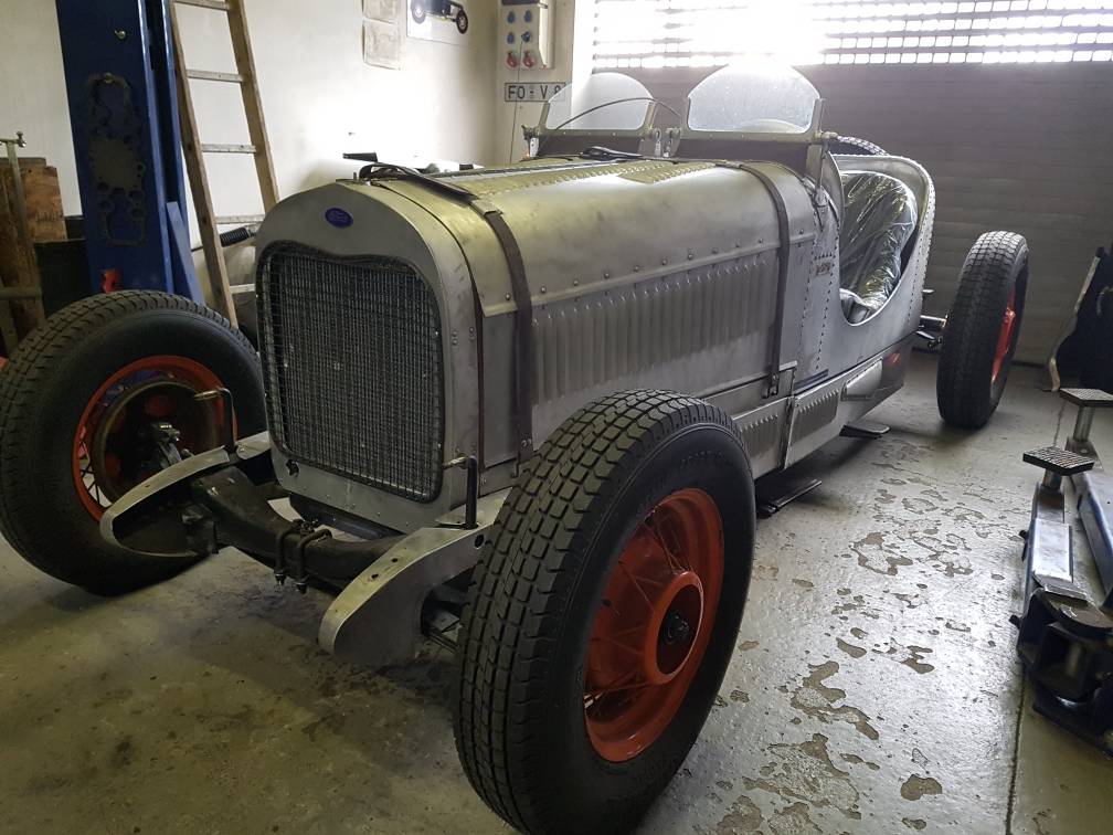

    This is what it looked like when it came in. The body is hand made out of aluminium. The radiator shell looks original but is actually hand made.
    I won't be changing the body at all. It's a mechanical rebuild with V8 running gear, and lowering as far as possible. IMG-20180417-WA0000.jpeg

    Rack and pinion isn't really correct on a solid axle car. (Toe in becomes variable). However I've learnt from those who have installed it, that in practice, it works very well. I guess front suspension travel of max 2", does really affect the toe in settings that much.
    I'm looking for a very direct one finger steering like modern cars have. It'll be low, with limited suspension travel. Stiff shocks all round and Lincoln 2" brakes all round. Looking for a sporty ride on this one.

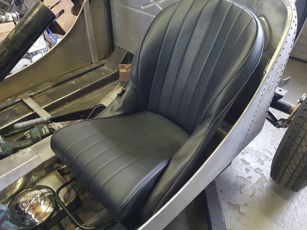

    Progress is being made on the Model-A speedster. I fitted some sports seats I bought in England. Also pictured is the Opel Corsa D steering rack fitted. 20181121_113151.jpeg 20181121_113232.jpeg

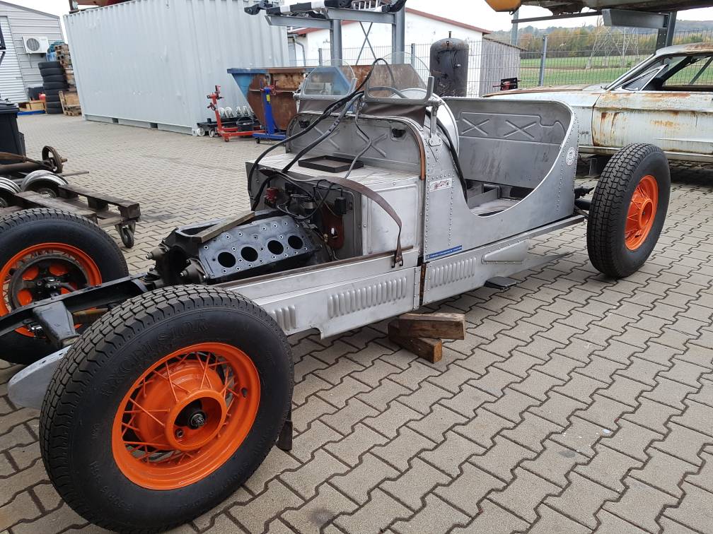

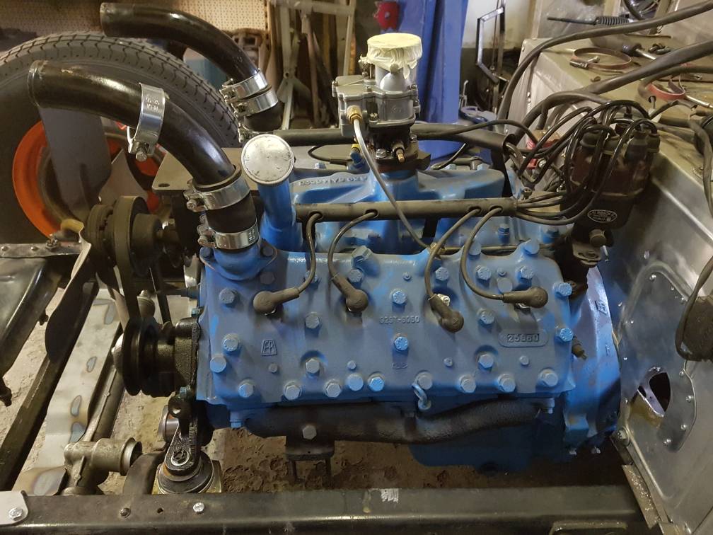

    First trial fit of the flathead V8. It's a 1960 G29 German built flathead. They're basically an 8BA but still have the 59AB half bellhousing cast in. It has a rear mounted Bosch distributor.
    Unfortunately the Stromberg 97 sits at an angle. I'll probably fit a 59AB intake to level it out. 20181122_145517.jpeg 20181122_145456.jpeg 20181122_145447.jpeg 20181122_145433.jpeg

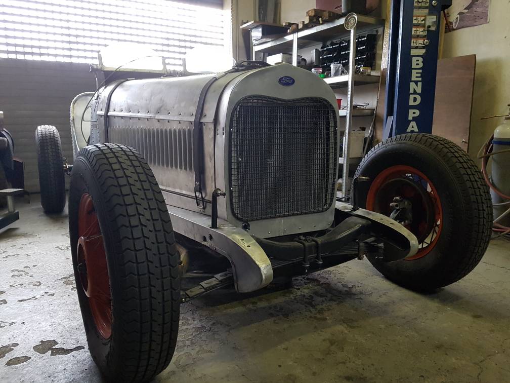

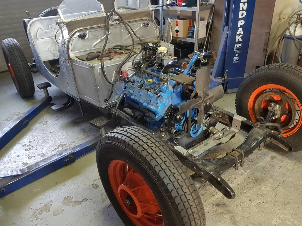

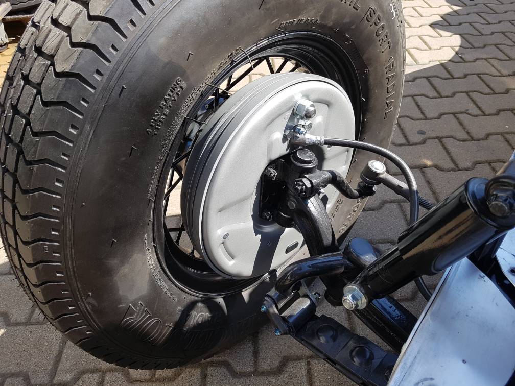

    Front metal work refitted and new V8 radiator fitted. I used F1 front shock mounts and the typical accessory lower mounts mounted on top of the wishbone. This calls for a short shock which I found at So-Cal. 20181204_135539.jpeg 20181204_135849.jpeg 20181204_135329.jpeg 20181128_132410.jpeg

    Yes it does, but the customer just fitted these tires so we will have to live with these until they're worn out.

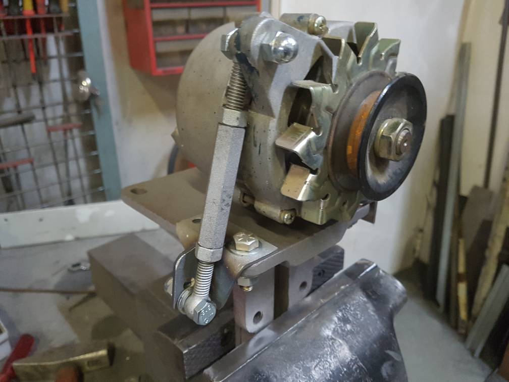

    I bet not many of you have ever seen one of these. It's a German flathead generator stand. It's got the "FK" for Ford Köln (Cologne) cast in underneath it. I wanted to use this neat piece so I mounted an alternator on it. 20181207_124312.jpeg 20181207_135734.jpeg

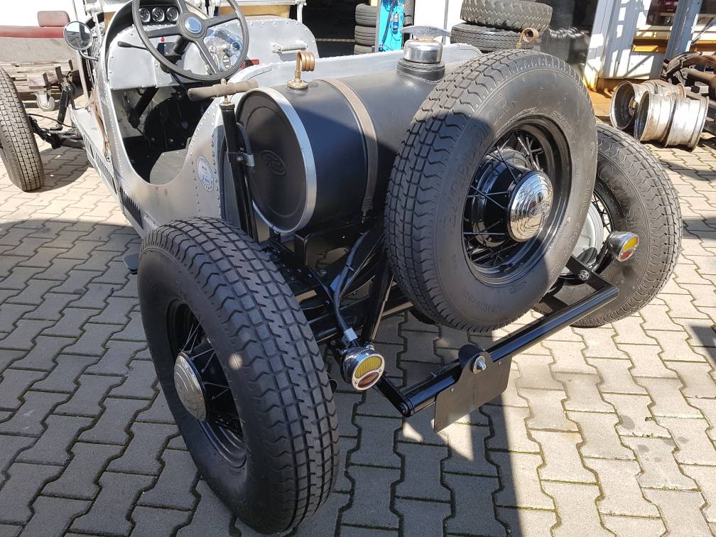

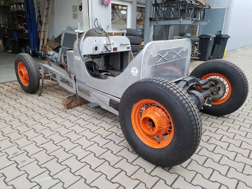

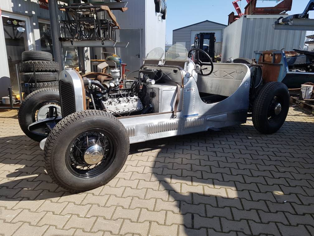

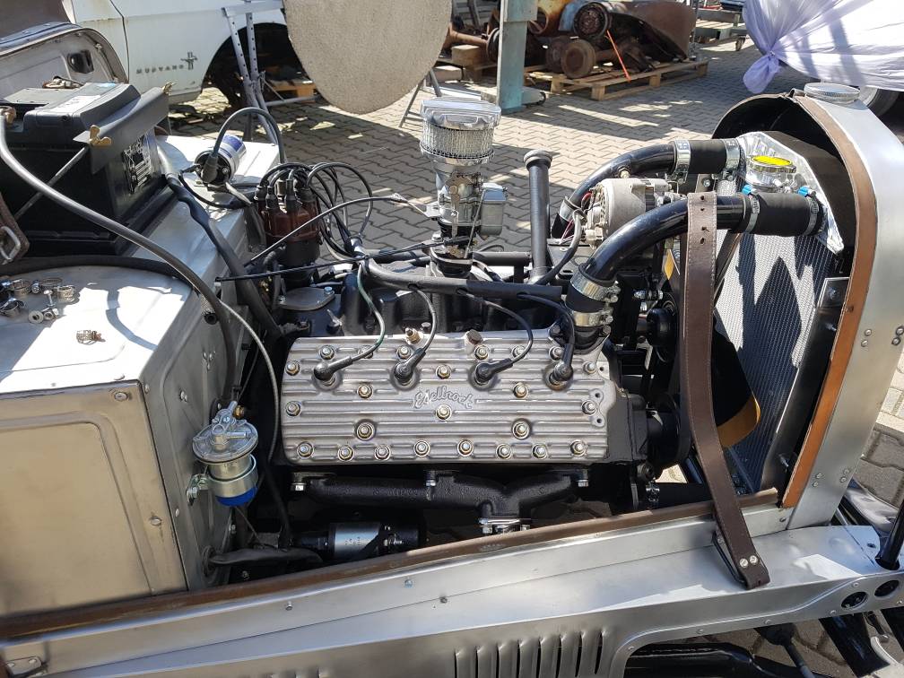

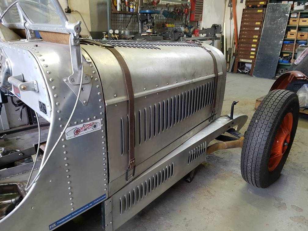

    So here it is, nearly finished. The seat is currently being upholstered in real leather. The hood and front valance will be fitted after I've tuned the engine.
    I set the rear axle 2.5" back, spring in front of axle, with the help of a 32 torque tube. It has Boling Brothers Lincoln Bendix brakes, 1935 Ford wire wheels powdered coated black. The entire ch***is and running gear are powder coated black.
    It has a German Truck Flathead V8 from 1960, and 1939 Transmission and a Model A rear axle.
    20190329_130202.jpeg 20190329_130137.jpeg 20190329_130128.jpeg 20190329_130114.jpeg 20190329_130055.jpeg 20190329_130022.jpeg 20190329_130007.jpeg 20190329_125940.jpeg

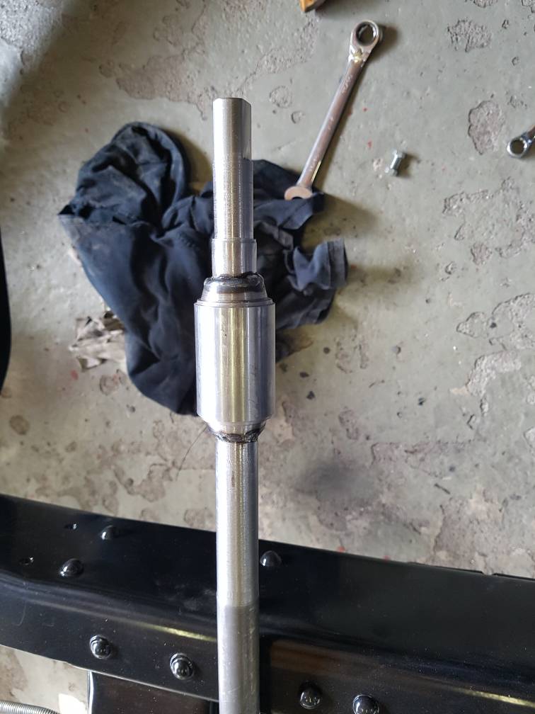

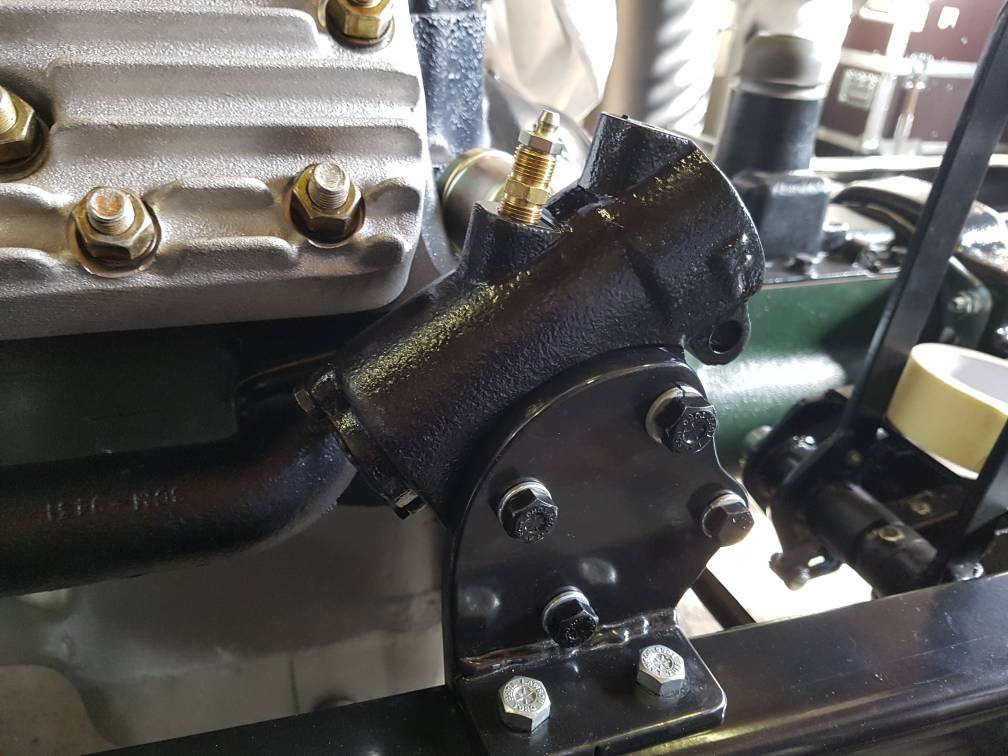

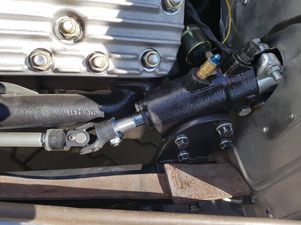

    I was fed up with vague steering boxes so I decided to fit this one with rack and pinion steering. I utilized the Model-A steering box as a lower column mount but the shaft goes on thru the box and has a DD end welded on. I found that a Vespa motor scooter crankshaft seal fitted perfectly to seal the bottom of the box.
    A GM 2009 Opel Corsa manual steering rack give a direct 3 turns lock to lock with no play at all.
    I used the GM because even though it's a European car, it uses the standard GM spline, so I could use aftermarket UJs from Speedway. 20190320_151008.jpeg 20190320_151014.jpeg 20190329_131040.jpeg
