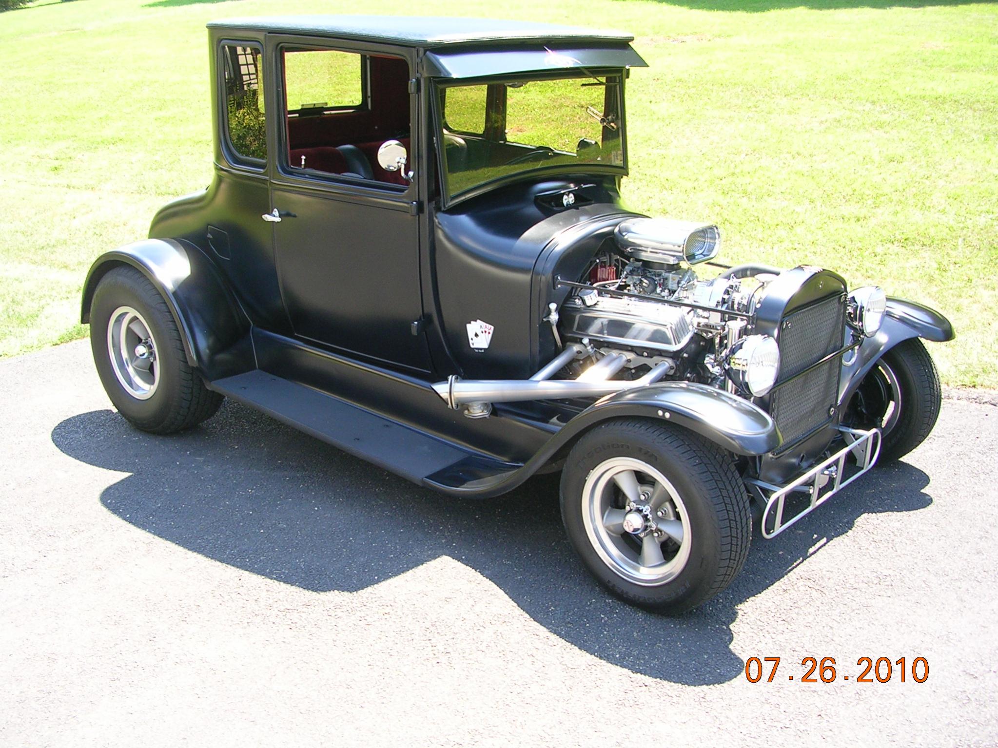

    Thats the way I did them on my T ,except I left the base part on,just eliminated the clips and had a screw from inside,except mine were lower,and upside-down don't have a close-up but you can see them on this pic. Wish I would have known--I have a brand new set of 3" peep mirrors!!!
