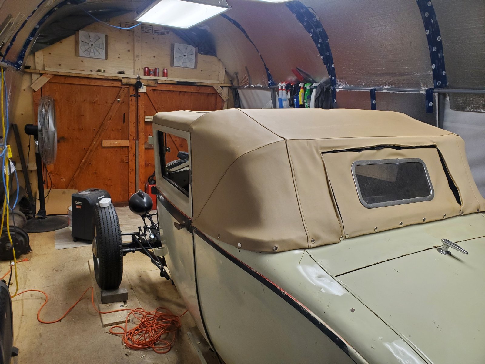

    20211227_175006.jpg 20210912_141618.jpg Here's mine, still working on the final fit of the top but it's pretty close to being good enough

    Joebrown, have any side pics? I'm liking the forward slant of that top.

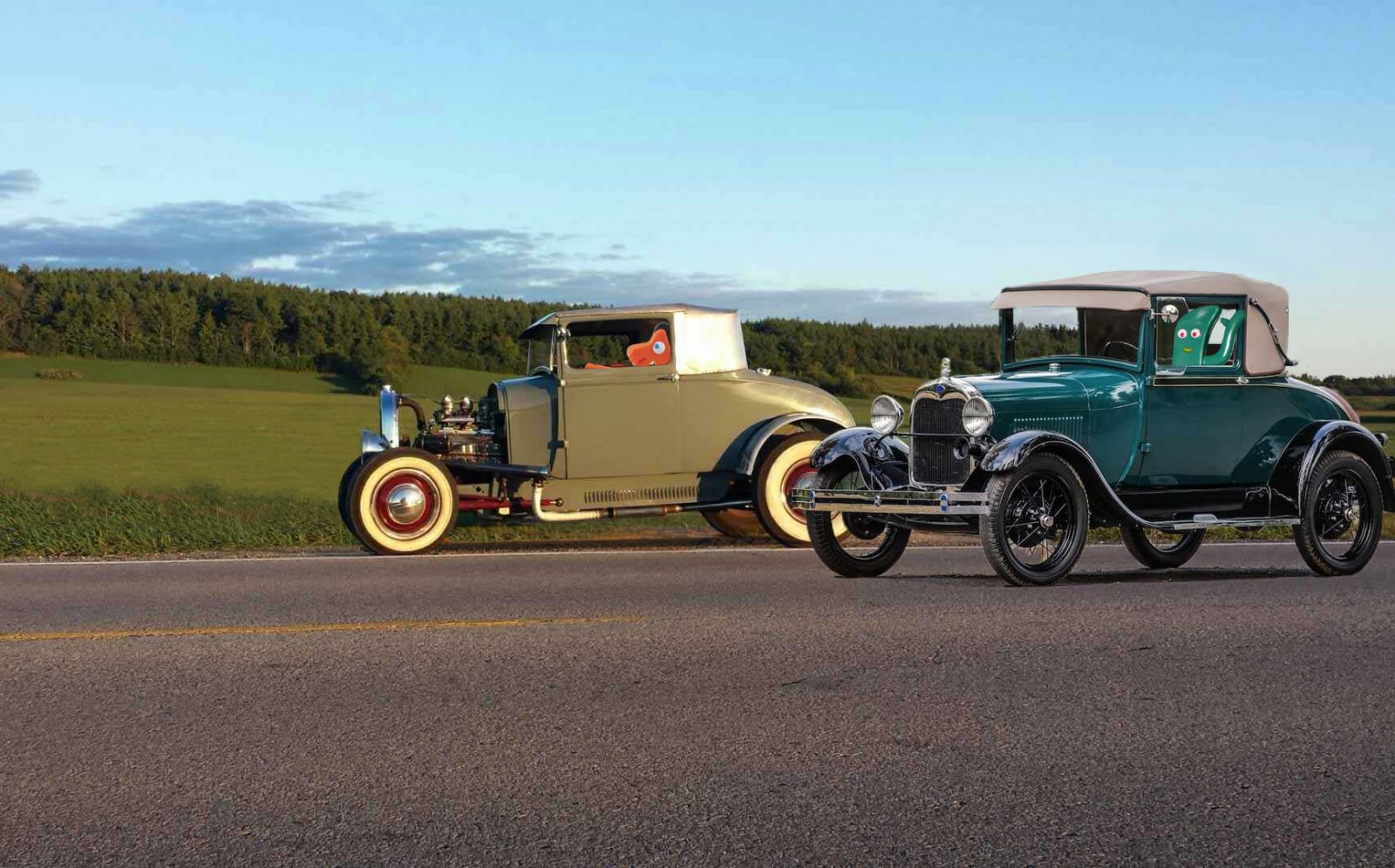

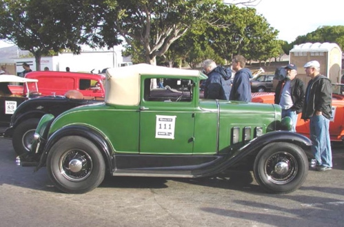

    is that Gumby driving the green sportie ?
    memory says that there was a Gumby cartoon on Sunday mornings, the main commercial on that show was for a Slinky... never got one.

    Yes that would be Him and his sidekick was in my Coupe...AND I even had a slinky...simple but ingenious...

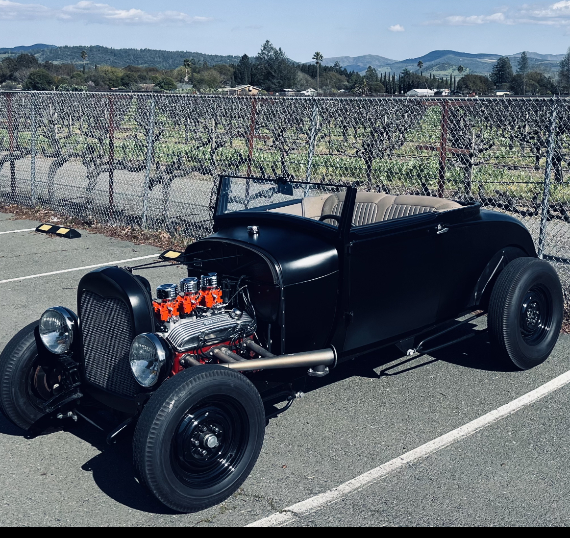

    Long time listener first time caller. Bought this “Coupster” six months ago. The only thing I’ve done is put a Tri-power set up on it. I’m interested in doing some fabrication work on it but would interested to hear any suggestions on whether making into a coupe again would be too much work over doing some modifications to make it look more like a traditional roadster?

    IMHO -Drive it 'til the tires are smooth, replace them and repeat...:D

    This is something I delved into at one point...there are several threads about it...in the end the differences between the 2 body styles are too numerous to make it worthwhile...it looks (hard to tell w small pics) like the builder made an awkward combing around the seat and leaned the posts back a bit
    my take on it would be to shorten the doors tops down to the belt line and put semi round tops (tubing cut in half) and lower that combing using tubing cut in 1/2 (on its side) so it has a rounded profile at rear and sides like orig. rdstr rather than flat as it is now...but @Jet96 has valid point...save it for the winter at least lol

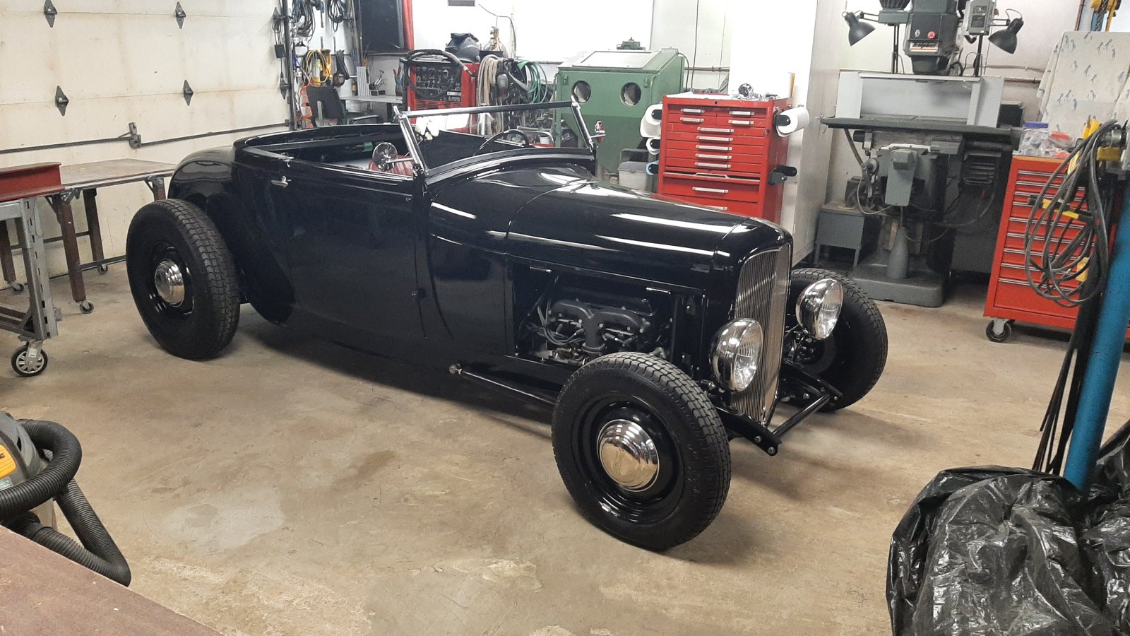

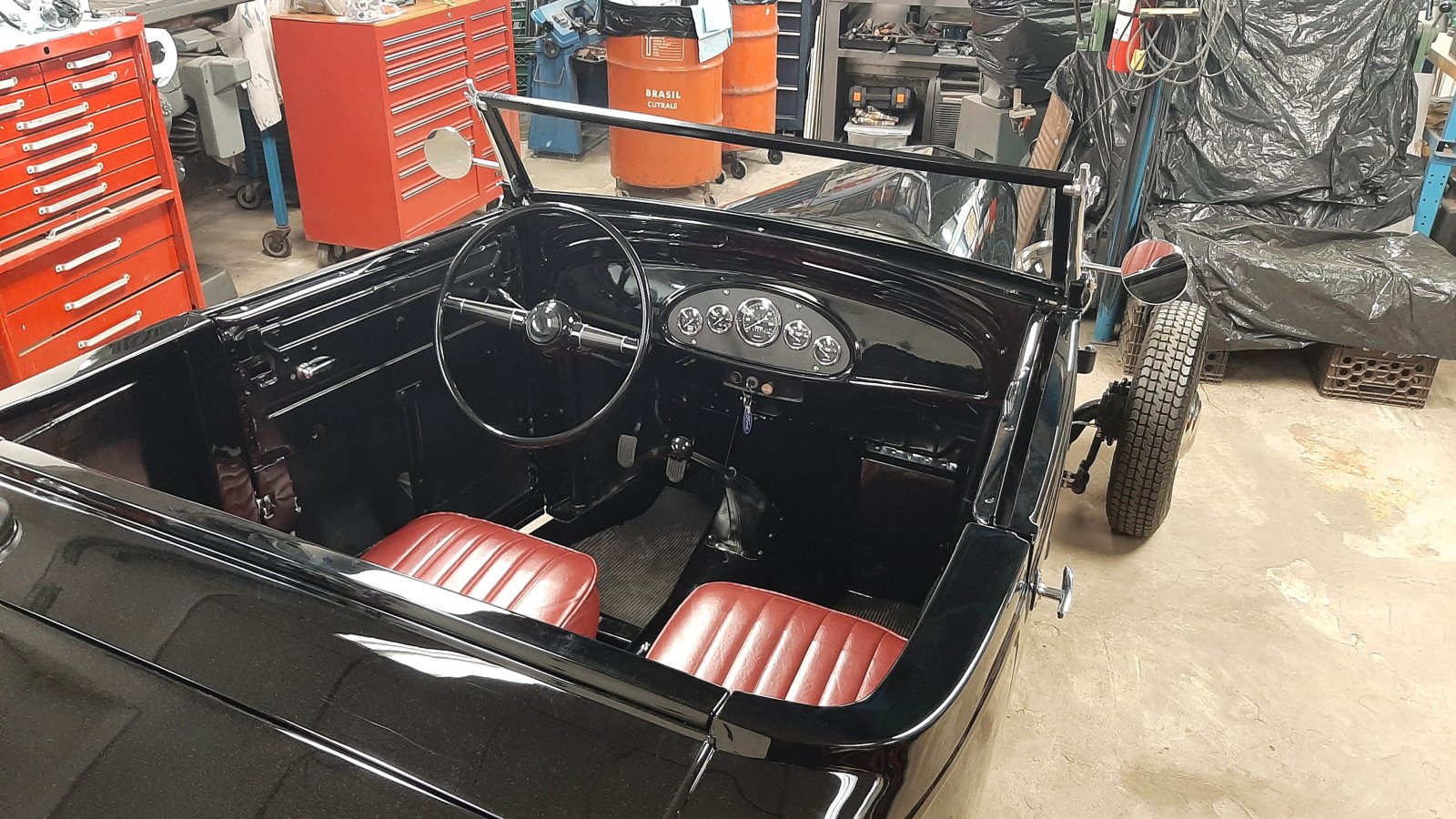

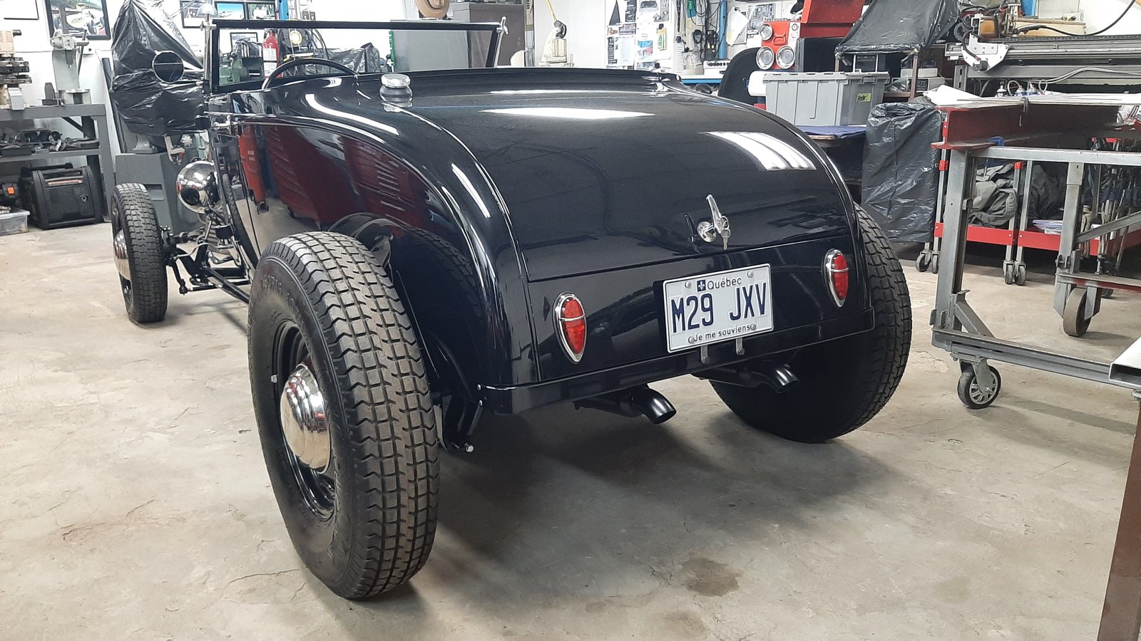

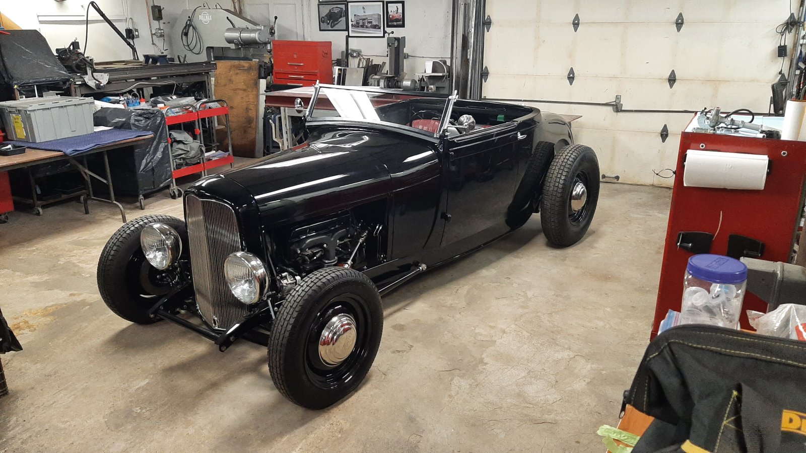

    Good thread. Definitely not easy to de- uglify a Sports Coupe. Especially a 28-29. Quite a few body mods to get it to look ok. We did our best.
    20221112_114601.jpg 20221112_114527.jpg 20221112_114637.jpg 20221112_114806.jpg

    Many thanks! I'm 6'2'' 230 lbs so I didn't want to sit on the car, I wanted to sit IN the car and stretch it out so it doesn't look as stubby. The frame is 32 rails, no channel. 106 inch wheelbase.
    The body mods are as follows:
    - floors welded to the bottom of the frame rails to gain 6" of leg room and to use a proper 17" OE '40 Ford steering wheel with my long legs.
    - flush doors
    - widened cowl.
    - antisectioned quarters to eliminate the after door 'step' and bring them level with the doors, quarter panel bead is inverted at the door band.
    - fabricated tulip panel topper to bridge between the quarter panels.
    - fabricated lower windsheild mounts that mate to the sedan/coupe cowl with orchard upper windshield stantions (sp?)
    - window tracks retained, the car will have roll up windows when the soft top gets done, in the meantime it'll have a tonneau cover.
    Some build details here:
    https://canadianrodder.com/forum/in...-a-sport-coupe-to-cabriolet-conversion.24266/
    The car in motion here. Hood and hood side panels were yet to be added.
    Cheers!

    Thanks for the specs and the video. Beautiful and very helpful! I love the 40 steering wheel. Will that fit on an original model A column with the adapter?

    Thanks! I'm sorry I didn't have a Model A steering column so I don't know. Perhaps the Model A guys could chime in.
    I used an IDITIT Old School steering column ( three bolt Grant pattern) and made an adaptor for the OE Ford taper. Pix here;
    https://canadianrodder.com/forum/in...upe-to-cabriolet-conversion.24266/post-254728
