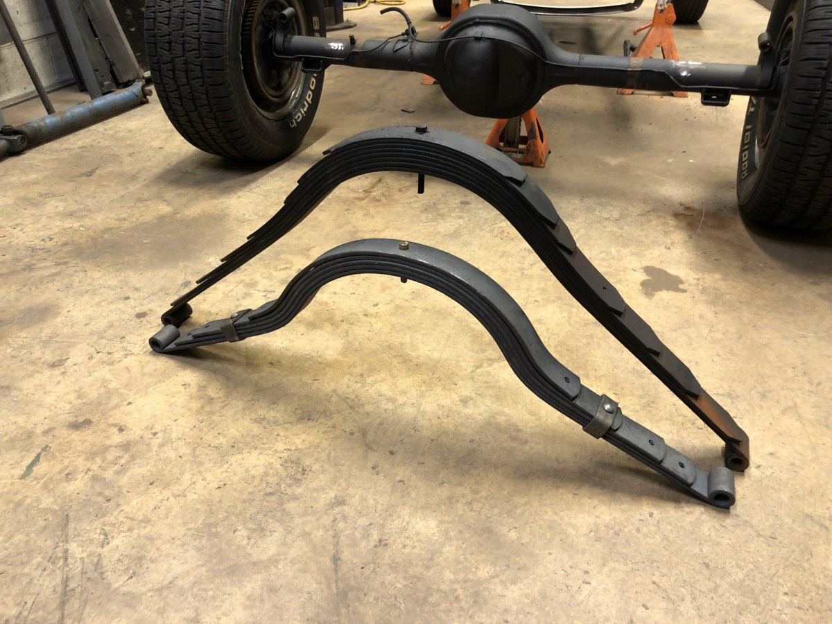

    Before I say anything, ill apologize if this topic has been beat to hell. But I just need to clarify if I screwed up or not.
    So this is the first A i've messed with and want to get a lower stance on it. Bought the speedway reversed eye rear spring thinking, "oh hell that doesnt seem bad" because you know, covid budget.
    Right. So anyway, am I correct to ***ume theres no way this things gonna fit? My perches are 49.25 inches apart, main leaf of spring is 38.5 inches uncompressed. I'm guessing I'm going to have the drop the coin on posies or move the shackles. Pics show the one that came off compared to new, then the new main leaf on axle. I purchased the medium arch reverse eye deal

  2. lake_harley
    Joined: Jun 4, 2017
    Posts: 2,614
    lake_harley
    Is the main leaf sitting on top of the rearend in the second photo the mainleaf from the spring in front of the other in the first photo? What's the higher spring in the back, the "high" arch spring from Speedway, and the one in front the "medium" arch? To me the rear spring in the photo resembles a T rear spring but it looks a lot more narrow eye-to-eye than what I'd think a T spring would be compared to a stock T unit. Maybe I just need to go take another look at the stock T spring I have to make sure my recollection isn't all messed up.

  3. sparky232
    Joined: Jun 22, 2010
    Posts: 79
    sparky232
    Ah yeah I should have specified, I bought the medium arch with reversed eyes. The one pic is comparing new with the one that came off it.

  4. rusty valley
    Joined: Oct 25, 2014
    Posts: 4,512
    rusty valley
    i have to agree, it doesnt look like it would go. so, i measured a stock A rear here, 49ish, and a stock unloaded spring at 41 ish, so it seems short. to install on a open frame like that, use only the main leaf, place a chunk of 2x4 under the spring eyes, hook up one side shackle, then have some one sit or stand on the spring to flaten it out enough to get in the other shackle. then, build the stack of springs on top of the main leaf. you also need to use the very top leaf as it has beveled edges that fit into the cross member radius.

  6. lake_harley
    Joined: Jun 4, 2017
    Posts: 2,614
    lake_harley
    OK. Yes, to use that medium arch spring you'll have to put on some different perches. Honestly though, but not knowing what body is going to be on the frame, it might look a bit odd with the perches in from the backing plates so far if you use the narrow spring. Just a guess, but I'd think the spring perch eyes would have to be ~ 43" to 44" apart for the 38.5" spring, allowing for some "pre-spreading" and a pair of 1.5" schackles.

  7. sparky232
    Posts: 79
    sparky232
    Crusty fenderless Fordor. Planning for wheels to be fairly tight to body, maybe won’t look too bad. Yeah from what I gather, I should be at 44”
  8. alchemy
    Joined: Sep 27, 2002
    Posts: 23,465
    alchemy
    I haven't done it, but it seems all the A guys use a stock T spring for a couple inch drop in their Model A's. They are cheap and there were millions made. It's a little thinner than the A spring, so you will need a couple spacers on either side of the leaf at the shackle. It should fit right into the crossmember with the stock clamps. But, you might need to add a bit of steel to the bottom tie bar of the clamp to thicken it up if it won't reach all the way up into the crossmember to touch the spring.

  9. RICH B
    Joined: Feb 7, 2007
    Posts: 6,298
    RICH B
    If you want something new.
    Old Yankee Speed makes a Model T spec based Model A spring. Matt calls it the AV8 hot rod spring.

  10. I took the easy way out, just bought a reversed eye main leaf and adjusted ride height, not using all the leaves.

    46international likes this.

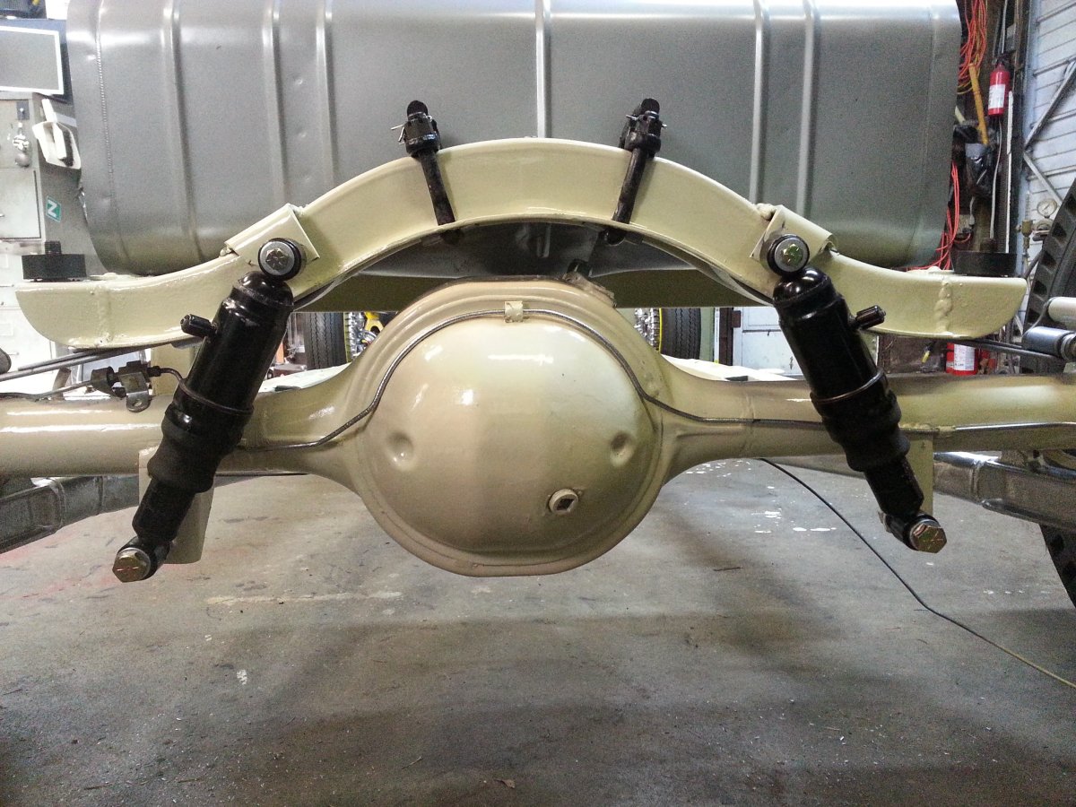

  15. I used a stock Model T rear spring on my '29. I removed the top (shortest) leaf and replaced it with the A top leaf, this will keep the spring centered in the crossmember. As alchemy say's, you'll need a spacer for the T spring at the shackles. I used a flat washers for mine.

  17. sparky232
    Posts: 79
    sparky232
    Boom! That's the route I'm taking then.

    What I’m thinking is this main with a couple secondary leaves from A spring
  27. That is the exact spring spring I put in my A coup. It's coming out this winter. I had to fab perches. It works ok but not enough clearance over the 9" pumpkin. Going to reverse arc it and how to get 2" more clearance. 20150113_114111.jpg
