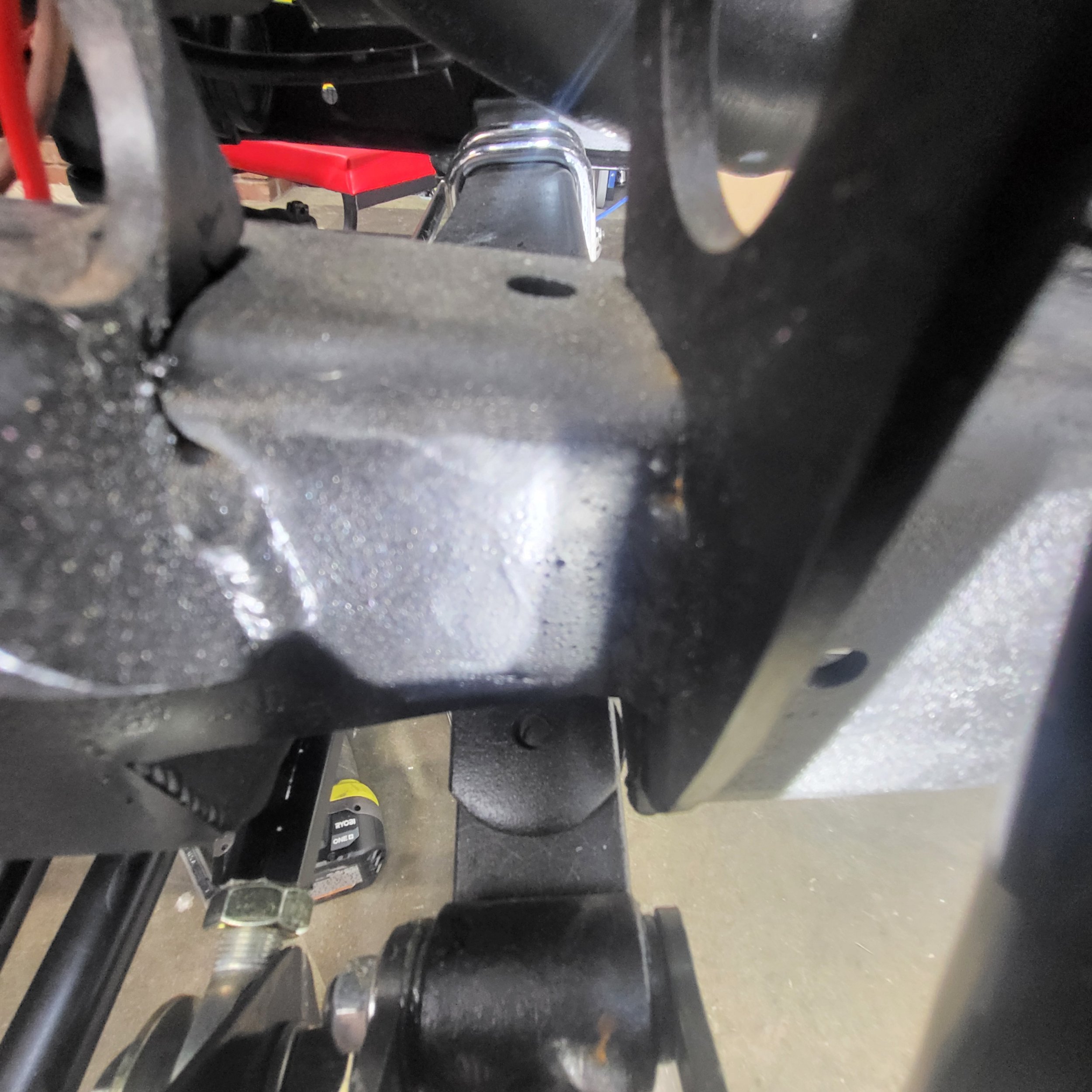

  12. Bikelessbill
    Joined: Oct 1, 2013
    Posts: 186
    Bikelessbill
    Kind of hard to get good pictures ***embled but here you go. 20250803_120208.jpg 20250803_120058.jpg
  13. Happydaze
    Joined: Aug 21, 2009
    Posts: 2,400
    Happydaze
    Why would you need to lay the spring back some when you have adjustable perches? I can see you might need to move the axle, probably rearward, in order to align the spring to the perches in order to avoid binding though.
    Edit. Just seen the pics. The spring needs to go back some. Will slotting the center hole in the crossmember help? You could put a piece of steel stock, 1/4 square on the front of the spring to **** it back, as a test? The hairpins or whatever might need adjusting shorter though.

  19. woodiewagon46
    Joined: Mar 14, 2013
    Posts: 2,536
    woodiewagon46
    from New York
    I see a lot of welds and if I'm not mistaken the crossmember is really leaning back. Have you measured your wheelbase on both sides of the car? I believe something else is going on with your front end. I would step back and start taking some measurements to figure out what is really wrong. A shim is just a band aid!

  21. Bikelessbill
    Joined: Oct 1, 2013
    Posts: 186
    Bikelessbill
    Frame is on stands now and way above ride height. When level crossmember is at 5 degrees . Crossmember is from Welder Series and have about decided it was bent on front side just a little more than should be. Slightly more narrow at bottom than top.

  23. ALLDONE
    Joined: May 16, 2023
    Posts: 4,018
    ALLDONE
    does this look the same both sides??? why does the cross member have such a bow?? if you un hook the wish bone or what ever you have does the problem go away..., to me some thing is pushing the axel too far forward... which would mean hair pins too long, what did pete say?
