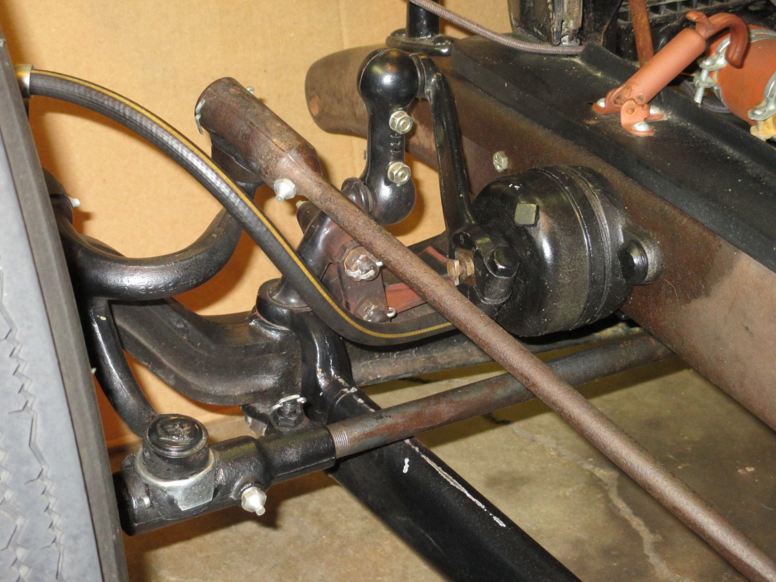

    IMG_0490.jpg You can modify Model A steering arms without heating and twisting 180 degrees. The picture shows what I did on my roadster pickup; cut the old steering ball off, thickened the end of the arm with 3/16 steel cut to match the diameter and welded in place, new steering ball pressed into arm from the bottom with the stem welded on top. No bending no change in Ackerman.

    Oldtmtech

    So you cut the ball off, do you have to drill out the center in order to push a new ball on?

  24. 5280A2
    Joined: Sep 8, 2014
    Posts: 198
    5280A2
    Yes, you do have to drill for the stem of the ball after cutting the original ball off. Rusty Valley is correct about the tapered reamer; that can also be used on the '32-'34 spindles to taper up halfway from the bottom so that the tapered stem bolt-on style balls can be installed facing down. Like the A spindle I showed, that reduces the amount of bending the spindle arm requires, especially with a dropped axle.
    Compare the thickness of the boss on the end of the steering arm in the picture posted by Oldtmtech and you will see the difference made by thickening the boss. I was also able to use grease seals on my rod ends because of the flat area created by making the bosses thicker.
