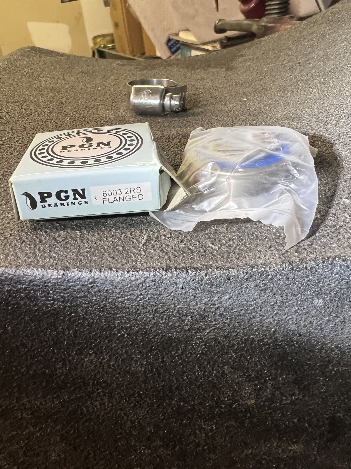

  5. 19Eddy30
    Joined: Mar 27, 2011
    Posts: 4,534
    19Eddy30
    from VA
    I have used both of these
    Slide inside tube , & cut grove on shaft
    Round & DD , grove for Snap Ring
