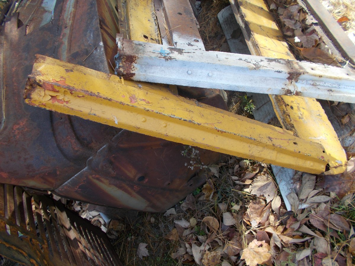

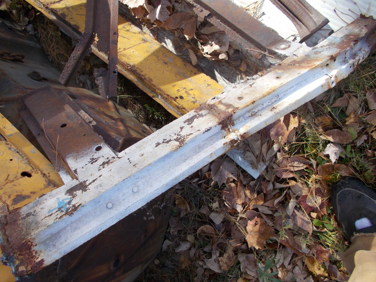

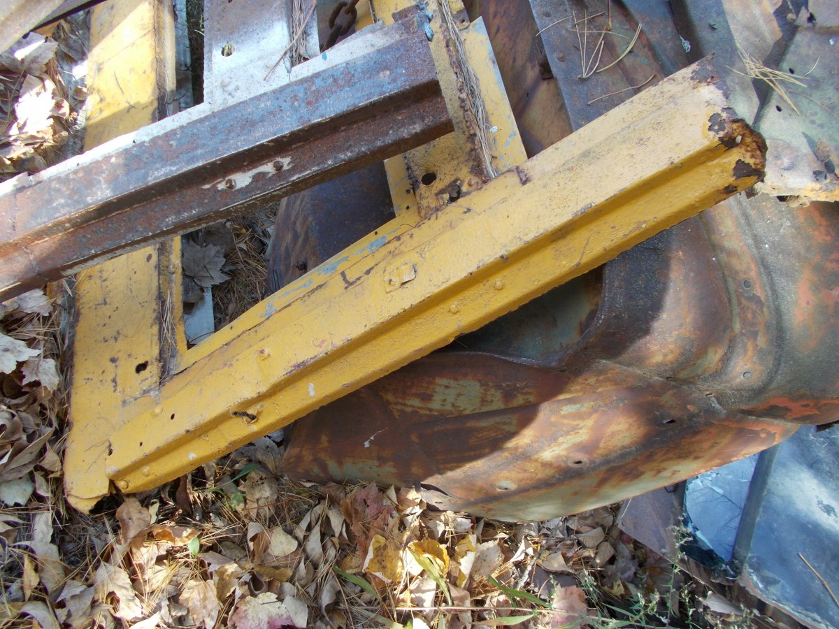

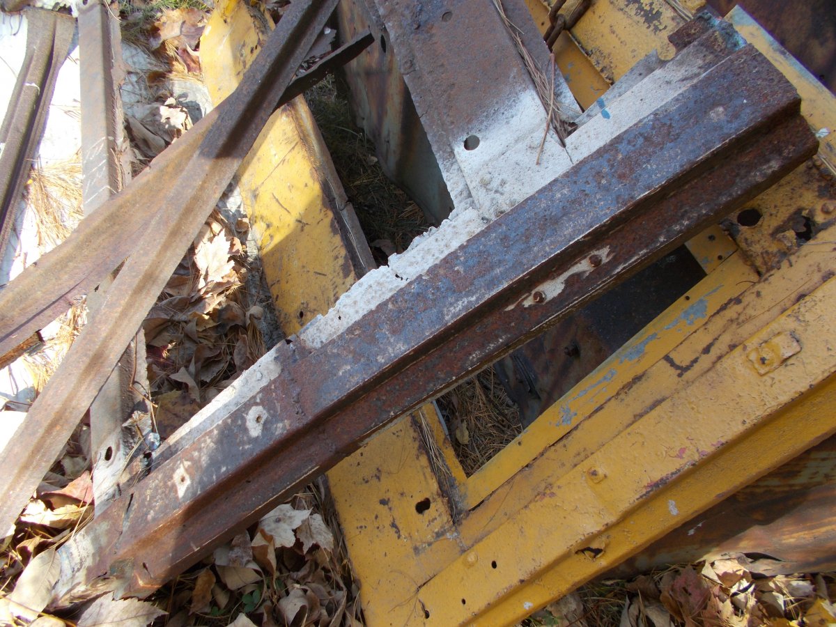

  16. sloppy jalopies
    Joined: Jun 29, 2015
    Posts: 5,256
    sloppy jalopies
    don't want to part with the full length subrails...
    I showed them to give a perspective...
    should find s****s like these close to home..
    .tudor and pick ups have a different angle than coupes [see cuts]...
    coupe doors are 27.5" long, tudor and truck are 29.25"...guess both would fit...
