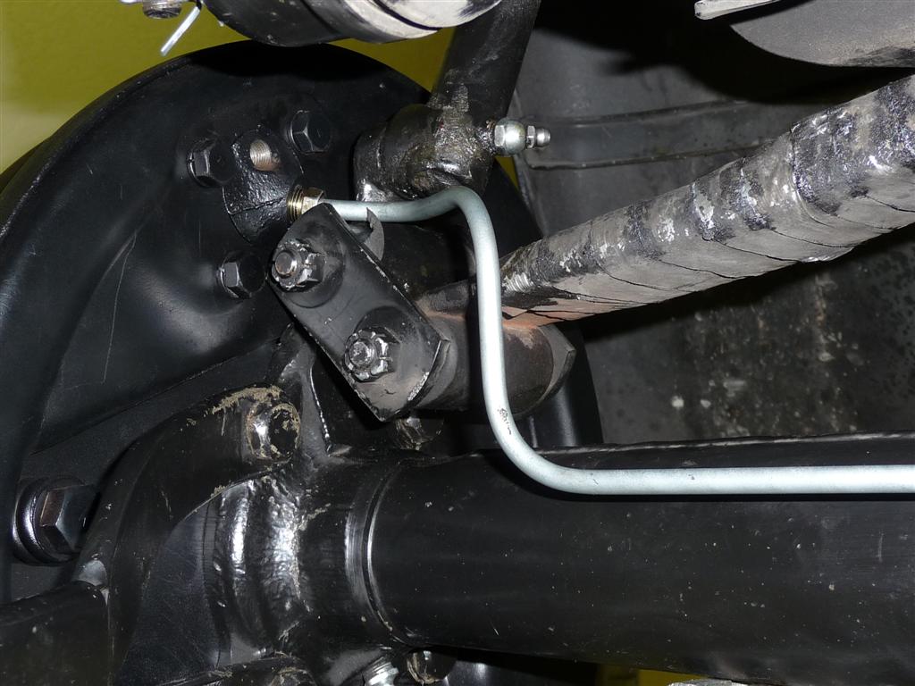

    When I built an A years ago I made a tool to put a very tight bend out of the rear brake line so I did not have to change the backing plate mount.

    from washington
    any pictures, sounds like the easiest way to go except I'd probably screw the bend up.
