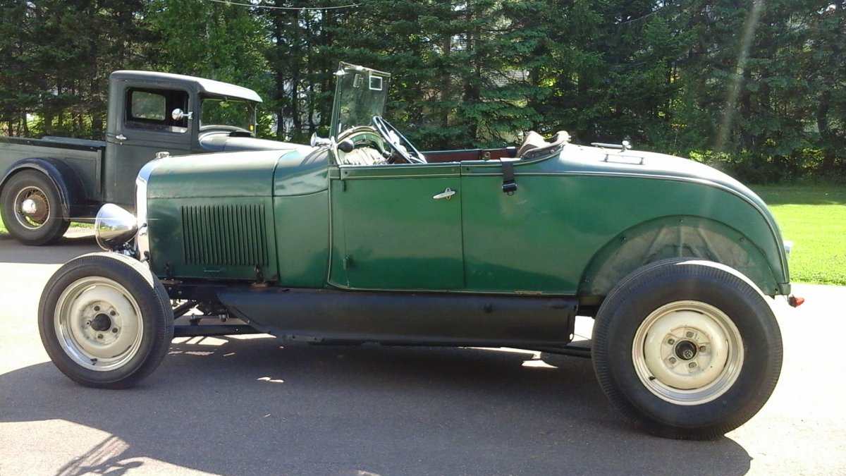

    image.jpg Guys, just wanting some , what would you do input. I blew the engine in my 28 roadster so I pulled it out. I also have a v8 trans to install and quick change rear end so I decided to go ahead and pull the body and work on the frame.
    But before this happened... The rear end I lowered by removing some leaves. Once I got it low enough where I wanted it to be there was not enough support and the Radius rods bottomed out on the frame when hitting bumps and the rear end hit the spring u-bolts. Also when my kids were in the rumble, the frame was bottomed out just sitting. I'm thinking my best option while I've got it stripped is to do the tardel step in the rear and put some leaves back in to get a more solid ride. I don't feel like I'm wanting it too low, 3.5-4 inches from tire to fender radius. Is the frame step necessary?
    Also considered flattening about an inch of the front crossmember to get the front a little lower. Thoughts appreciated

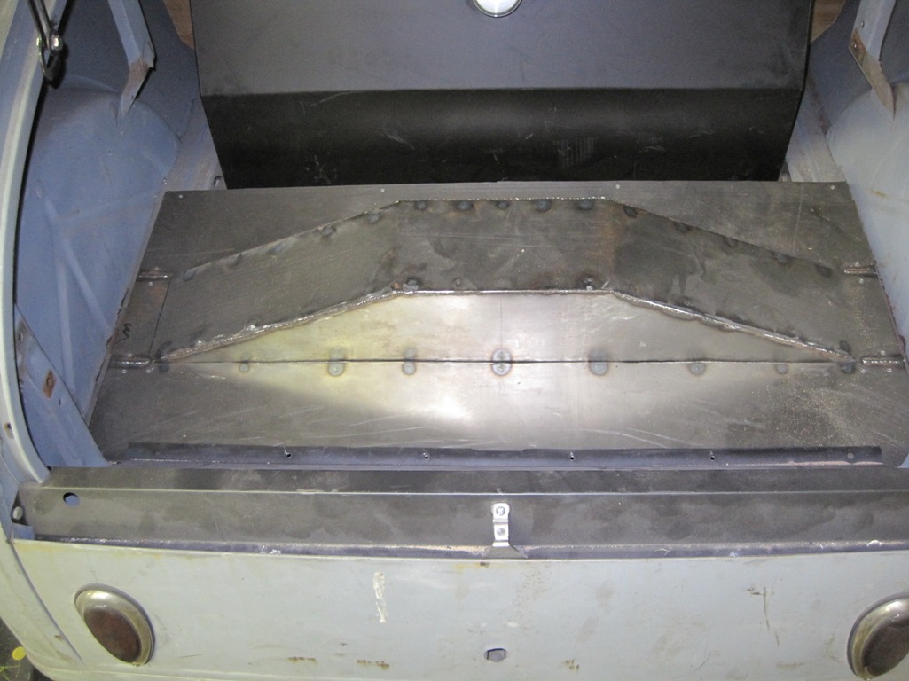

  12. Here is my version. I went far enough forward to clear the radius rods and pinched the rails being I was Channeling the Body. As to the tapper of bottom of frame just keep the top of rail parrell on both sides of step and I welded the box plate at all contact points then caped the ends of frame to the box plate. I then fill welded the outboard seam of the frame.

    I'm conflicted about whether to "Z" or not to "Z"...prefer NOT, but the rear on my '31 roadster is quite a bit higher on mine that in your pic. Anyone know how I can determine if I have the lowest spring pack in place? Purchased work in progress so don't have history. It looks stock but recently examined a bone stock '31 roadster at car show and the top of his rear crossmember was at least 4" closer to the top of banjo than mine and shape seemed much flatter. Can weight on rear really drop it that much? Before stepping the frame I need to make sure I have the right spring pack.

    Looks like you have an 8 spring roadster pack which is right. You can get it lower by taking out some of the longer springs. Looks like the long ones are all still there and short ones moved to bottom. You can get it lower but the ride will be soft I think. If you're not going to have weight in the back or use a rumble seat I think you could get away with it that way and some shocks. To get mine as low as it is in the picture there are only two of the long springs in and the ends are flattened out.

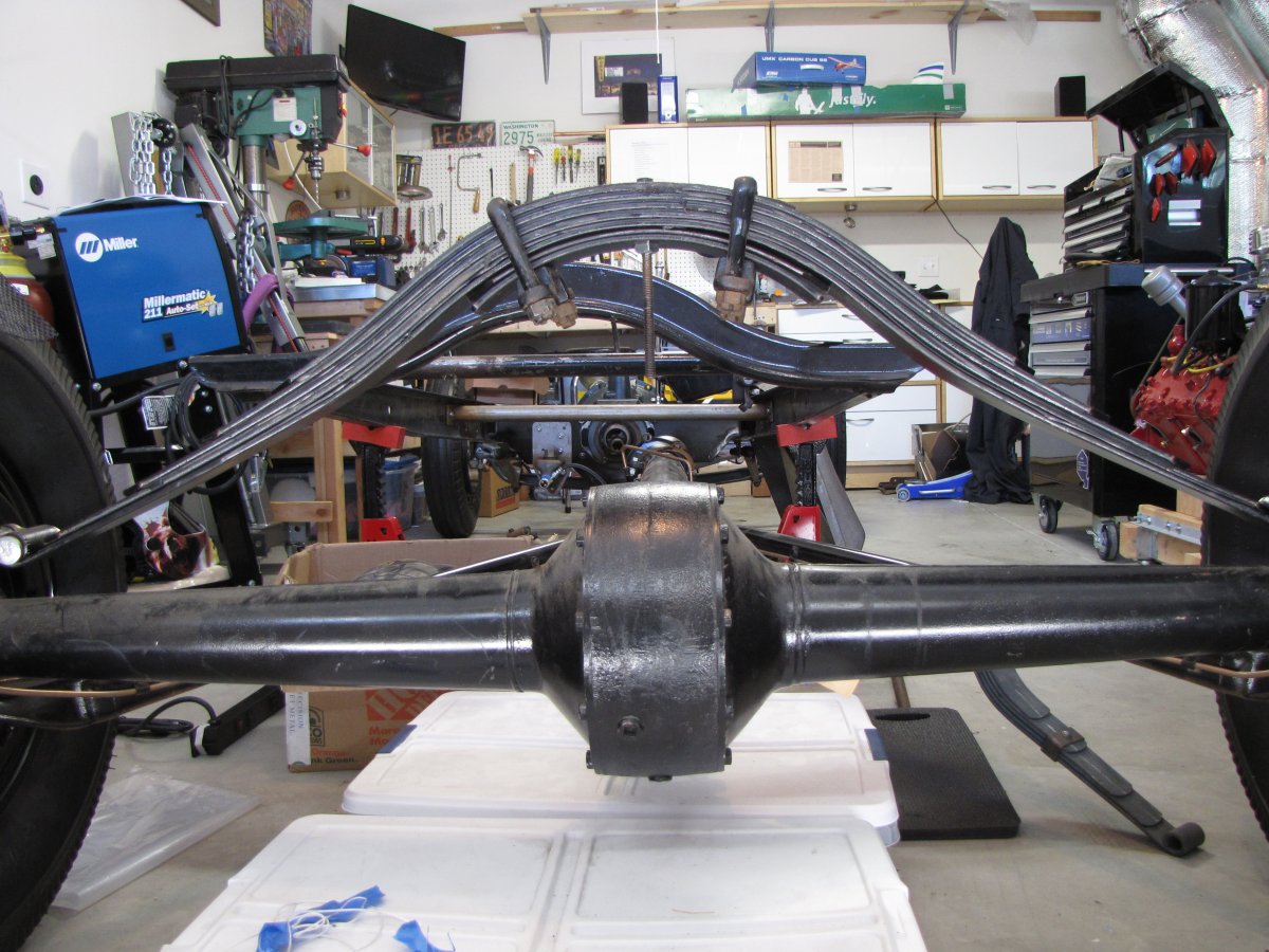

  21. Nov 2011 x 3 002.jpg Test fit #1 002.jpg Test fit #1 003.jpg Test fit #1 004.jpg I wasn't all that impressed with the way things were going after stepping my frame so I built a complete different frame. I used a 36 rear end with a model A spring and a 39 front axle. I had a good front piece of an A frame and a good rear section. My wheel base is still exactly same as stock Model A and I have no step with a totally flat floor except over the tranny. I love the way this one is working out. I now have 3" between top of both front and rear axles and the bottom of the frame rails. You could do this basic change by just extending your frame 6-1/2" and moving the rear corssmember back and re hanging your stock spring. All you would need to do to your floor is extend the window for the crossmember cover.
    F.Y.I. That is a 36 Ford X member.
