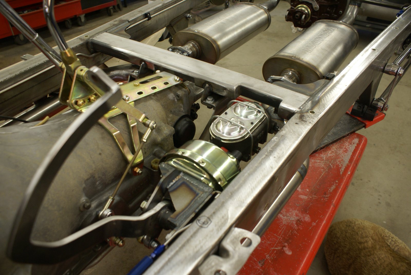

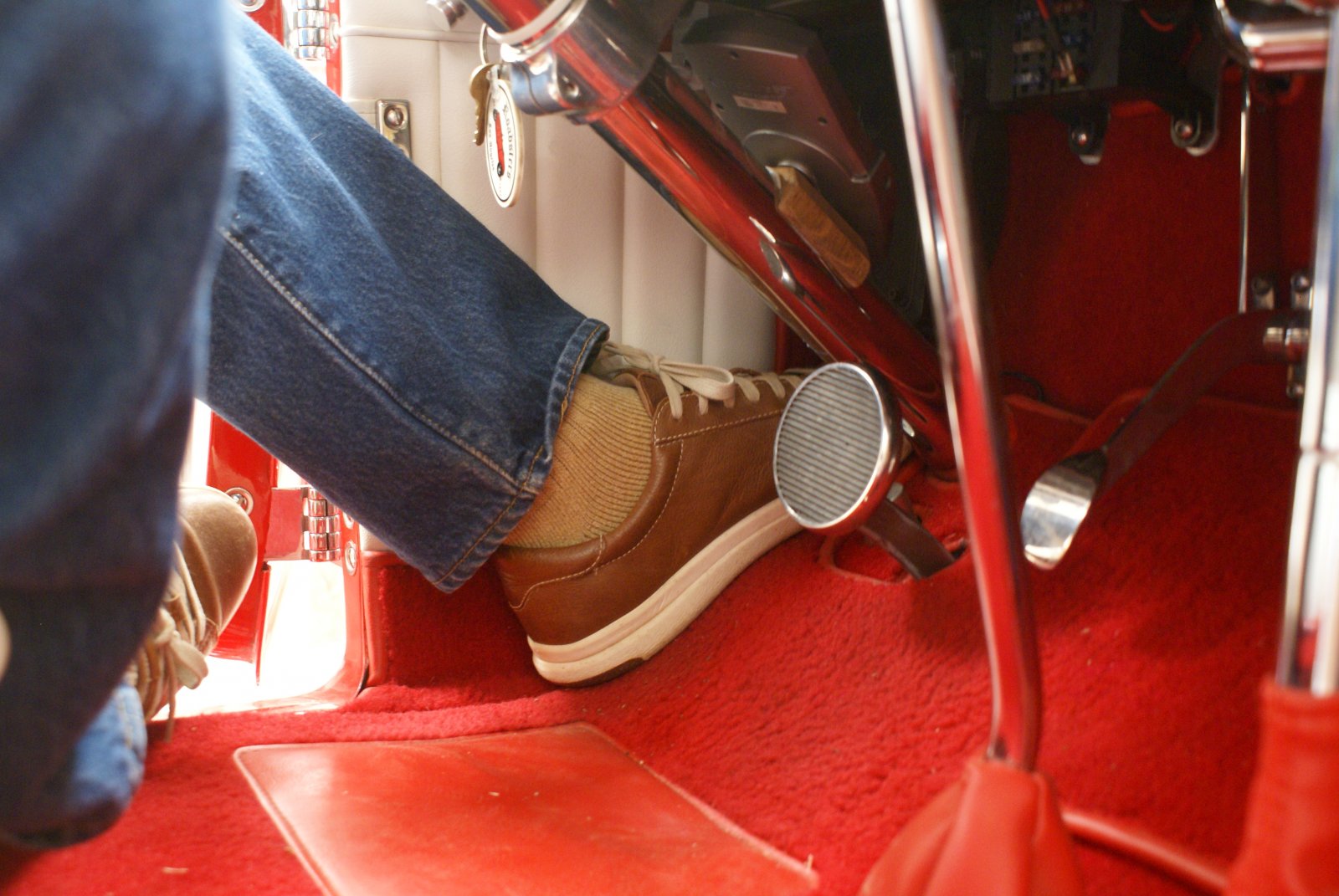

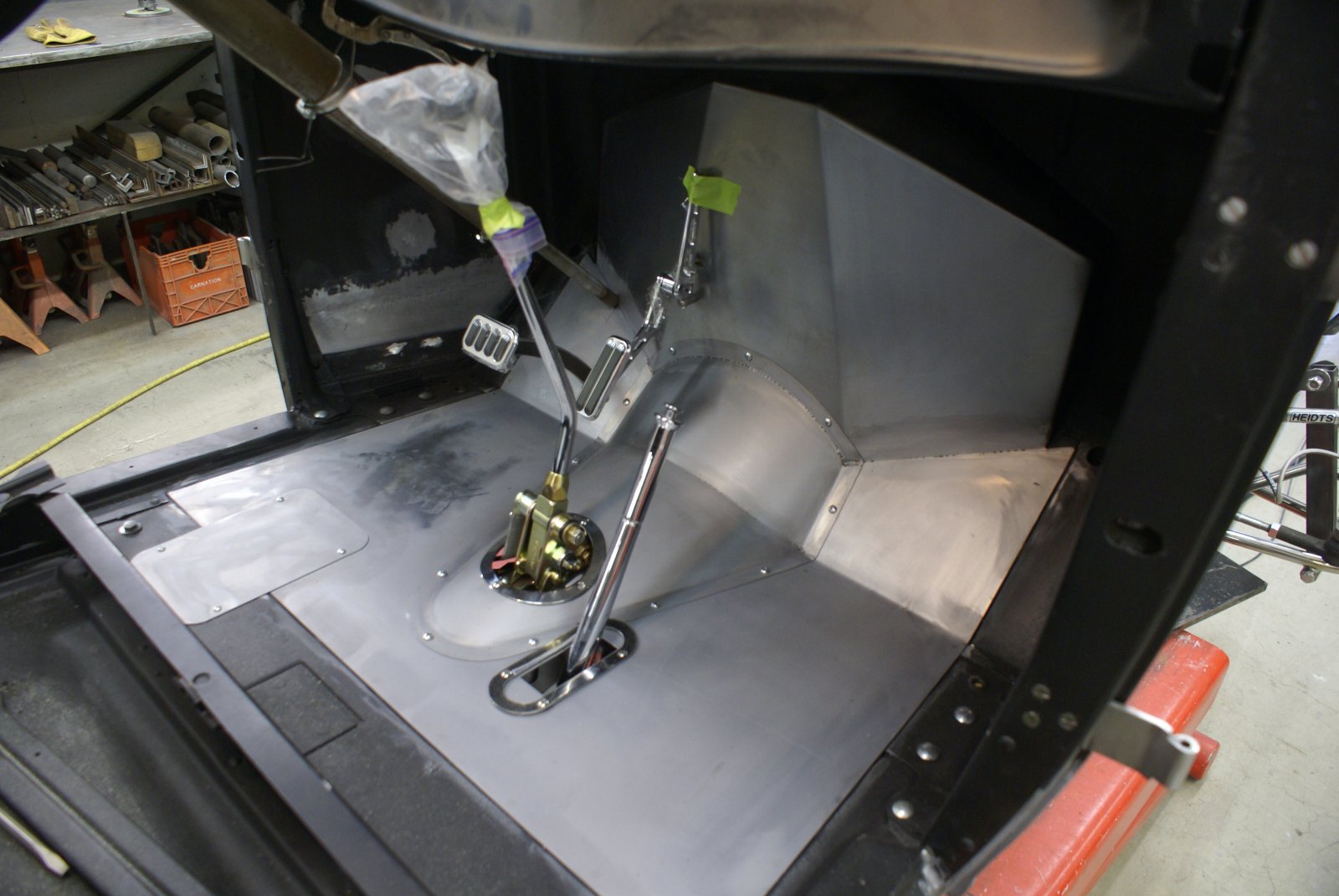

  4. Blake 27
    Joined: Apr 10, 2016
    Posts: 1,568
    Blake 27
    This car isn't channeled but you can see where the toe boards start in relation to the door opening.
    Positioning them as far forward as possible will give you more leg room needed in a channeled car.
    The final pic shows the brake pedal location. Fabrication by my good friend Joe Brusaschetti. 1.JPG 2.JPG 3.JPG DSC05749.JPG

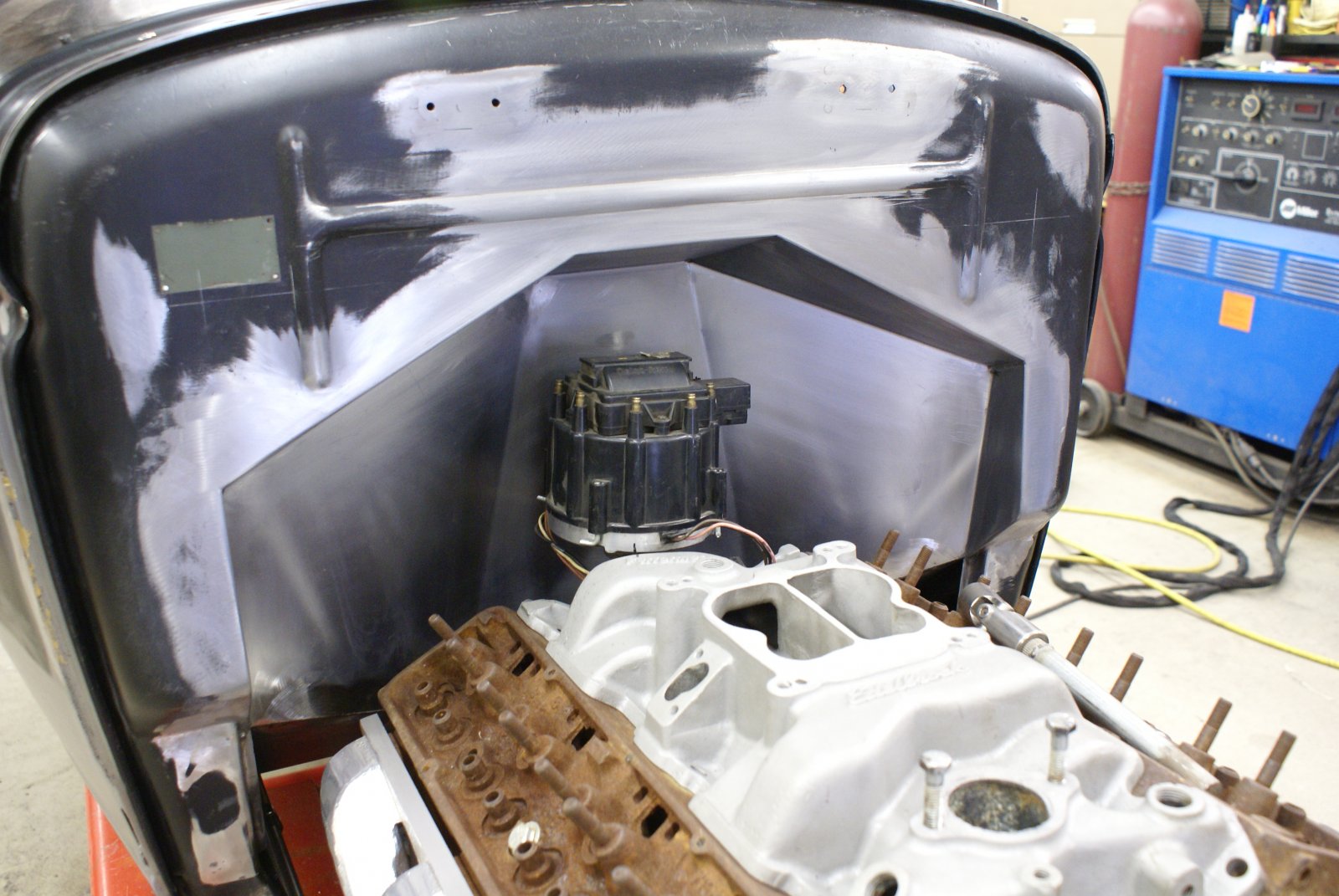

  10. WhyW8
    Joined: Mar 3, 2022
    Posts: 57
    WhyW8
    from Sun City
    Agreed, layout the seat, pedal and steering column and you will have a good picture of what little room you have left. Here some pictures of my 29 with a 3" +/- channel

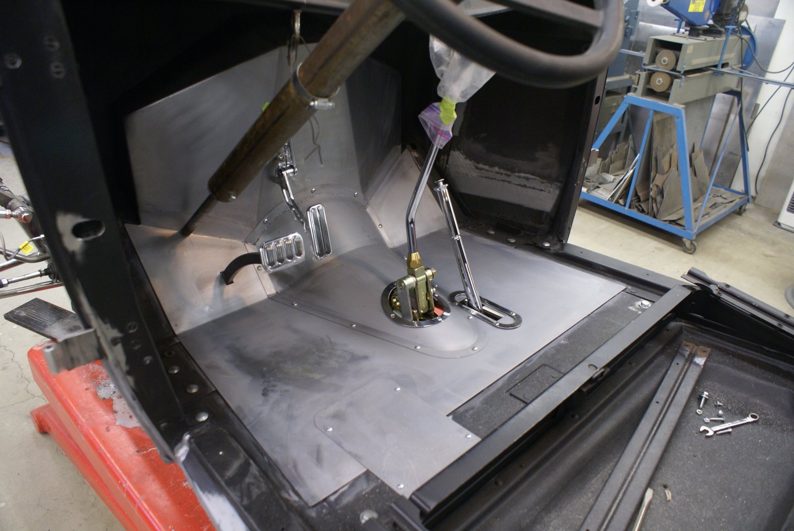

  12. nochop
    Joined: Nov 13, 2005
    Posts: 4,730
    nochop
    from norcal
    Here is how mine shook out. But you results will vary….

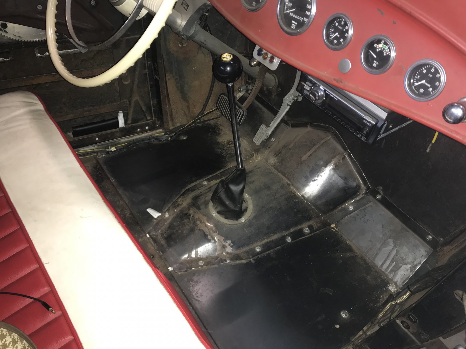

  14. sparky232
    Joined: Jun 22, 2010
    Posts: 79
    sparky232
    Thanks for all the suggestions, huge help. Thinking I'll start with getting the pedals set first and go from there. Dont think the seat I was planning on using will work out, it's a tad tall. This might be part of my issue? It's a back seat from a 63 Falcon and was going to shorten the width. Looks cool though IMG_5376.jpg IMG_5378.jpg

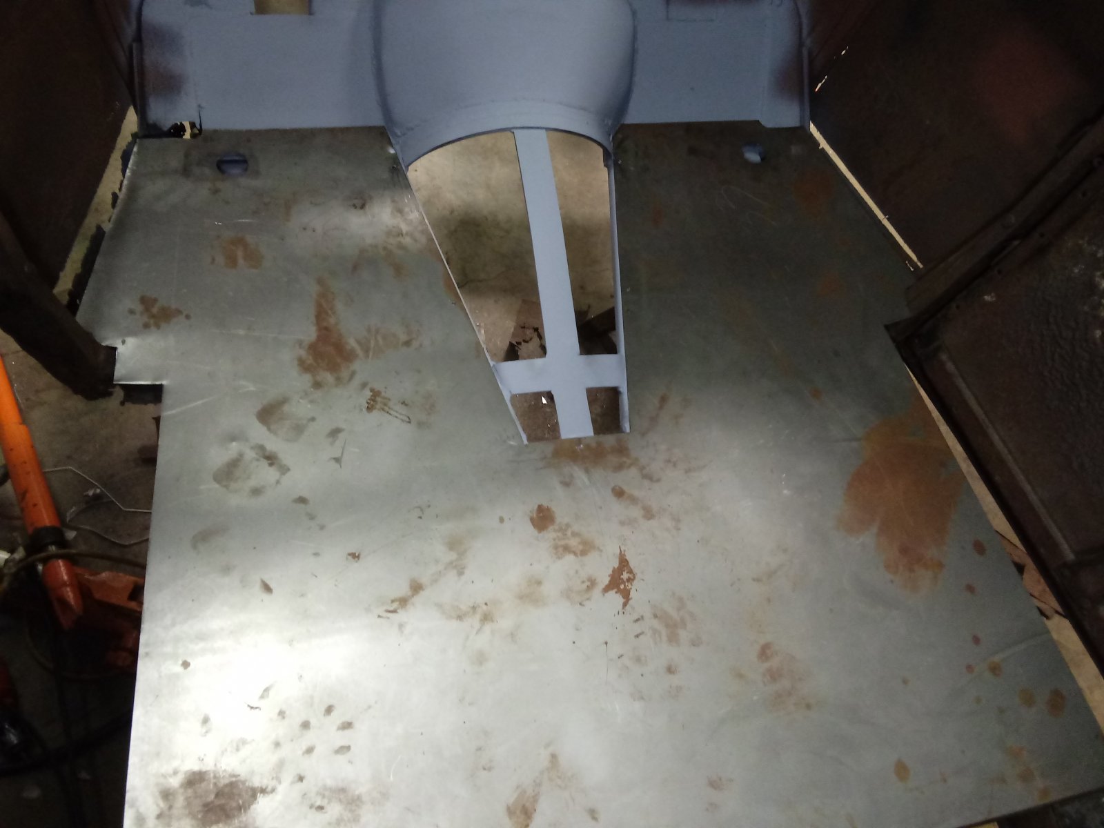

    Don't know if this will help or not as your car is channeled and mine is not. The previous owner of mine did a recess in the firewall and made up the floor to fit what he had done. Which worked fine for him as he was treating it as a rat rod and did't care how it looked. I used as much of what was there as I could and adapted it so it would work without reinventing everything from scratch. I had my pedals and steering column in which makes this whole exercise a pain in the *** by the way, but set my seat in place and got my basic controls laid out and then determined if it would all work. together and it does. Then adapted some of his not so good sheetmetal work to finish the floor. I built a transmission hump from scratch. Here is a pic. A little hard to see as one pic is taken from the trunk looking forward into the ****pit and the other is from the p***enger door area.

    Maybe a partial toe board for your left foot. The gas pedal acts as a board on the right. DSC03530.JPG

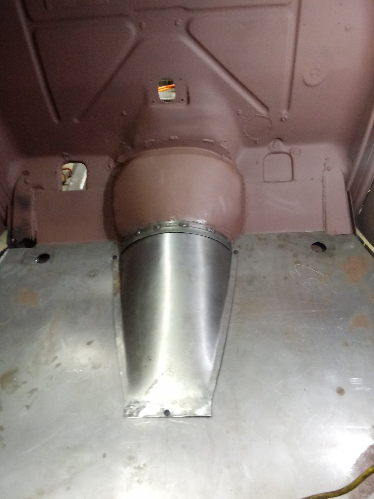

    Joined: Oct 13, 2013
    Posts: 3,900
    lostone
    from kansas
    20210721_204630.jpg 20210713_195831.jpg On my 31 tudor I channeled it 3". I ran the floor out to the cowl and rear quarters on the sides and created "pockets" for the doors to close into.
    I followed the original angles of the original toe plate to the floor. Just in mock up the angle feels good. The upper section of the trans tunnel is welded solid to the firewall and the lower section fits into a slot I built into the upper section and bolts to the floor. With the slot the lower section fits in tight and I don't have to worry about screws running into the trans nor do I have to see any running thru the outside the firewall.
    When I'm done I'll put a strip of caulk into the slot and seal the lower panel with that.

  29. lostone
    Posts: 3,900
    lostone
    from kansas
    If you look close at my photos you'll see that half of my toe plate were gone and I added metal there. It molded in good enough that it's barely visible unless you look for it and of course once there's carpet it's not a problem.
