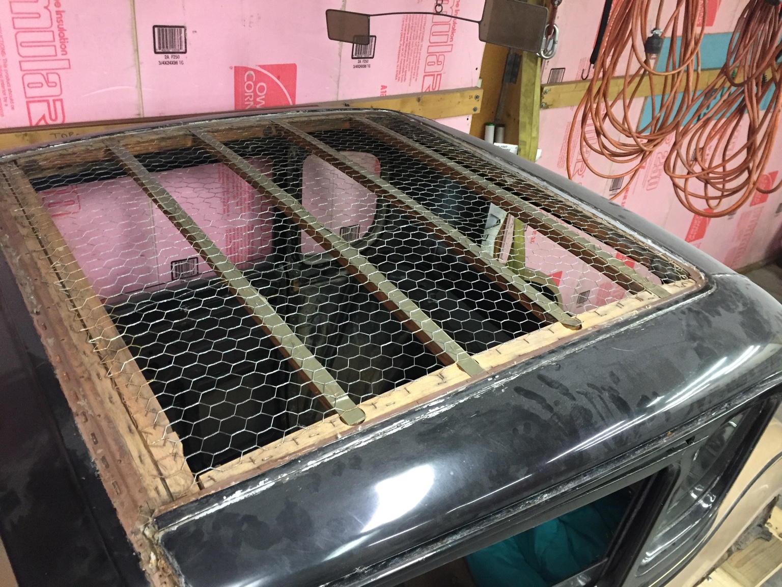

  2. If you google it you'll find a tutorial I am sure but the gist of it is that you fill the void with chicken wire and batting between the wood and the rubber/vinyl top. The actual top material if you are going for the stock look is rubber with an embossed grain.

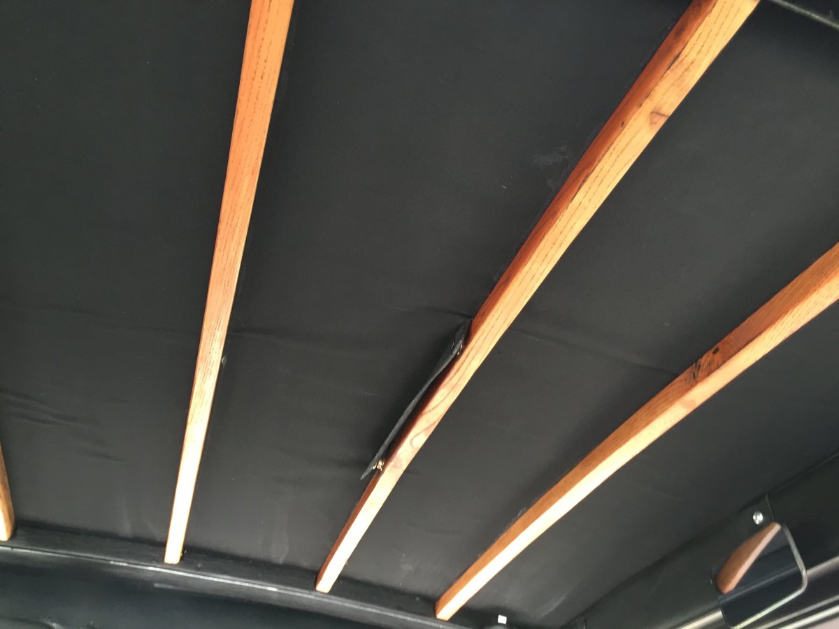

    Coupe ? This is "stock" padding and vinyl over that. All nailed or stapled into the wood. [​IMG]

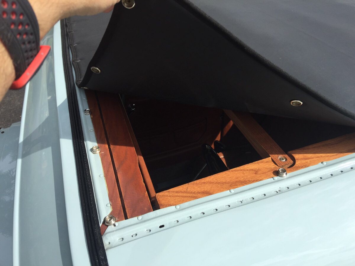

    Here's how Hilton solved that,

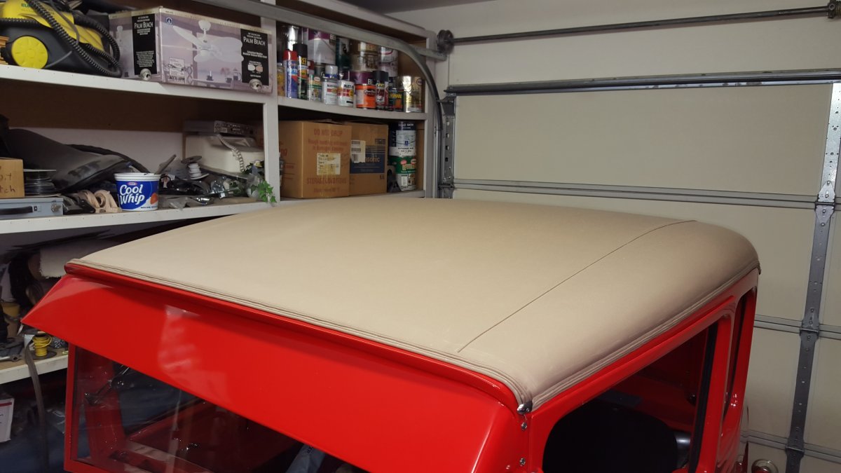

    Here's what I did with my closed cab pickup, which is similar to your coupe that not quite the same thing. I wanted a removable top for those times when I wanted to cruise with it open, so this was my answer. (note, my pickup had the original wood bowes, which I retained). I can remove the top in about 2 minutes, and reinstall it in about the same amount of time, piece of cake. But to be honest, I've only removed it a few times, most times it is far more comfortable to drive it with the top in place. Best time with it open is at night, with warm clear weather, and a full moon. Daytime I'd rather have it in place, and it makes a huge difference in improving the comfort on a hot day. There are a couple of things I'd do different, if I was to do it again, but overall I'm very happy with it.

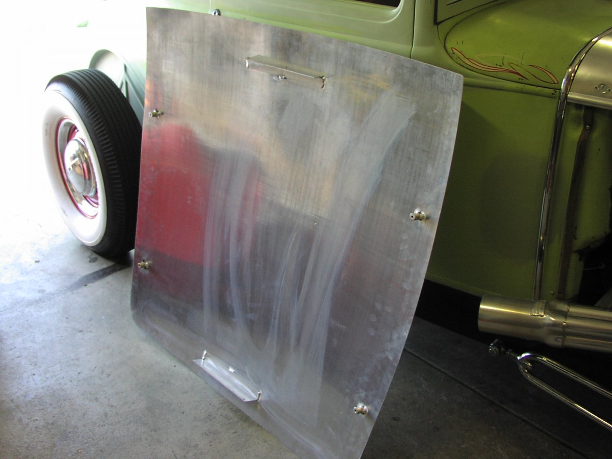

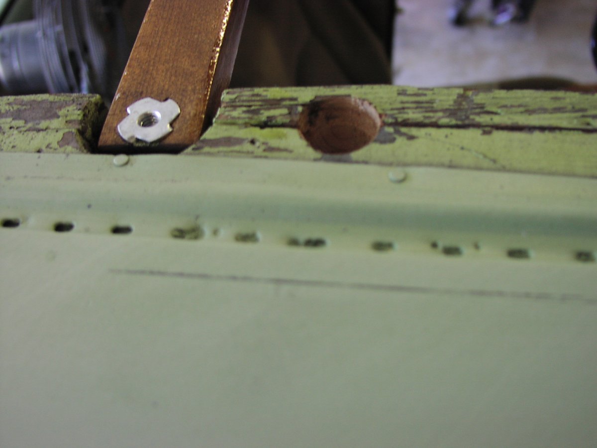

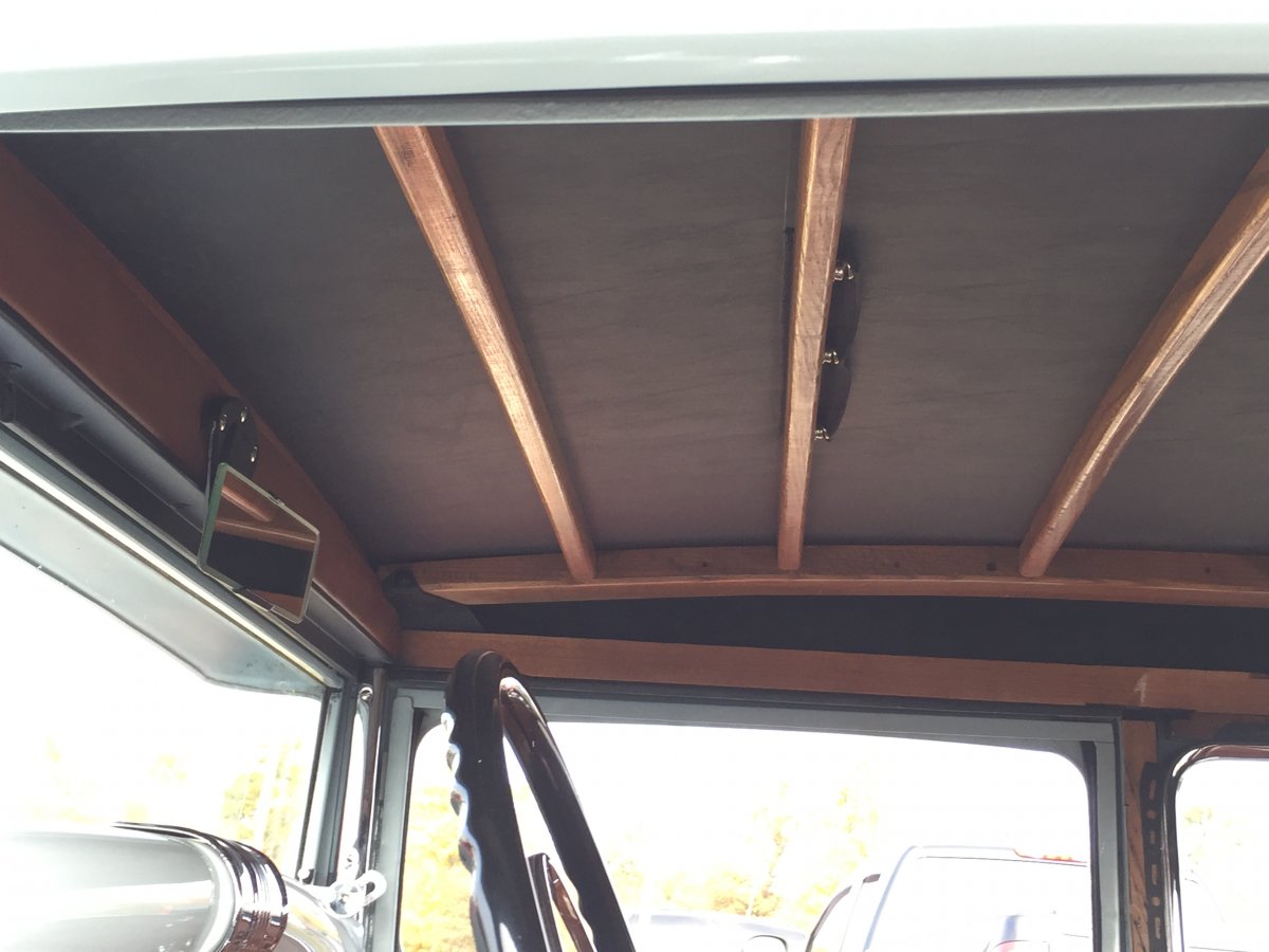

    Like you, I wanted to keep the top opening on my coupe somewhat stock looking, and wanted to make it easily removable instead of semi-permanent. My original top wood was OK for 85-year old wood, but I don't think it would hold the nails required to tack down a stock-type fabric top.
    Here's what I did: I sanded and varnished the top bows, and they came out looking pretty nice. I sprayed the rest of the wood with Zoloztone since it was aged and paint-oversprayed. The top insert is a piece of aluminum rolled out on an English wheel so it has a compound contour that matches the rest of the top. There are 4 aluminum "bungs" and 2 angle pieces welded to the underside of the aluminum top for attachment. I used a speed bore bit to make the holes in the original top wood for the "bungs" to fit in, and the aluminum top skin can then be bolted on. I took the top skin to an upholstery shop where I had it covered with fabric. The top can now be bolted in place and it can be quickly and easily removed if desired. Note that the top insert is larger than the original top opening, so it is no longer really an "insert". This was done because it's much easier to go over the original opening than to try to fit it dead nuts. It still looks close to a stock fabric top, and I think it fills the bill nicely. Hopefully the pictures will show what you need to see. 9-14-09 004.jpg 9-14-09 009.jpg
    millelacsrick and Blues4U like this.

    That is really nice! I like that a lot. I like the way it fits, very clean looking. Thanks for sharing.

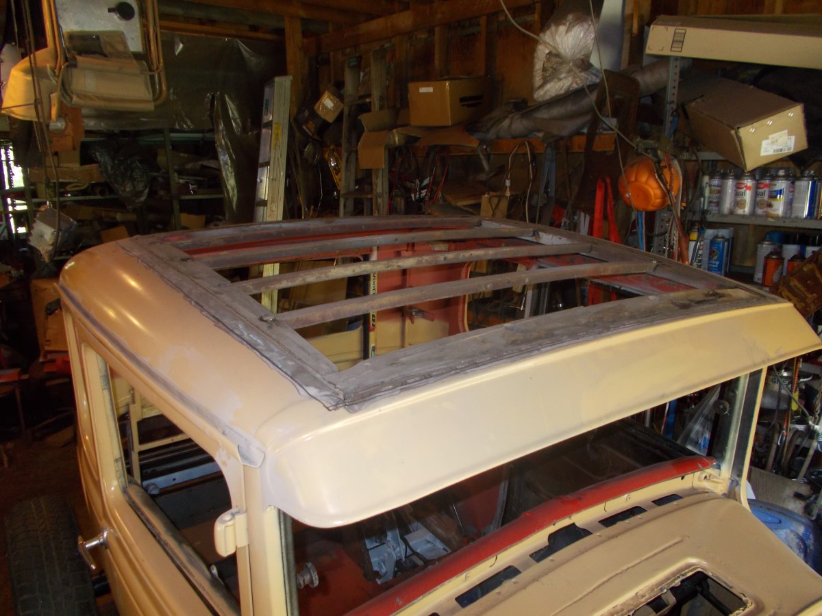

    25+ years ago I used boat upholstery to cover my top. Although certainly not in daily use, it's held up well. I believe it is also is available in a wide range of colors. Sedan Pix .jpg
