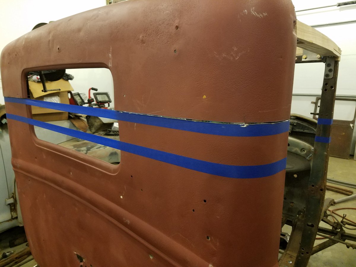

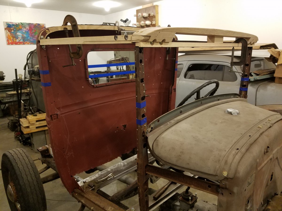

    Now that the wood is in and the cab is fairly rigid, it's time to start making this thing interesting.
    The first thing on the list....chopping the top. I actually spent a lot of time debating how much should be taken out. I wanted an aggressive look but still be proportioned since the cab wasn't channeled. After doing a ton of searches here and on the Googles as well as looking a countless pictures, I settled on 4".
    The chop on a Model A is pretty straight forward. I marked the rear off on the flattest and straightest section. For the A pillars, I decided to cut below the windshield swing arm mounts so that I didn't have to re-position the studs.
    After about 15 minutes of cutting, the cab was back into pieces...

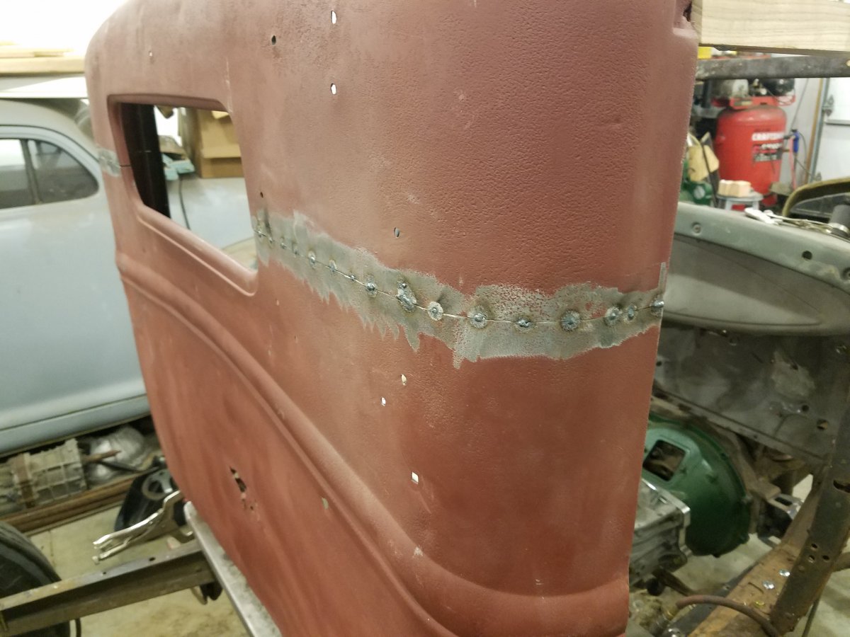

    A little bit of fitting was required to get it all to line up. I was then able to start tacking it back together.
    The back was pretty messed up with dents and rust. It actually warped and bowed in when I cut it apart. You can see this on the last picture right below the belt line. Since I have to replace that area anyway, I didn't get to overly concerned but it is going to take some work to get it right.

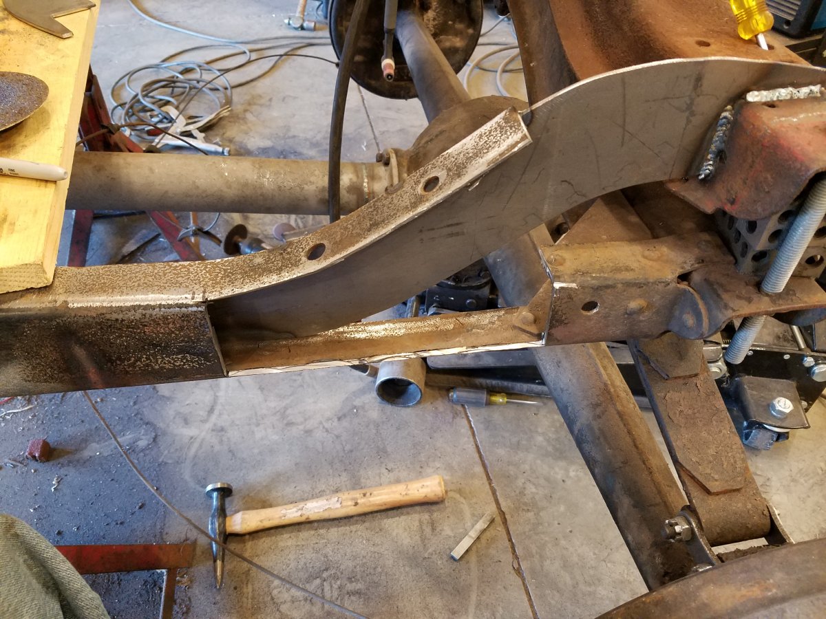

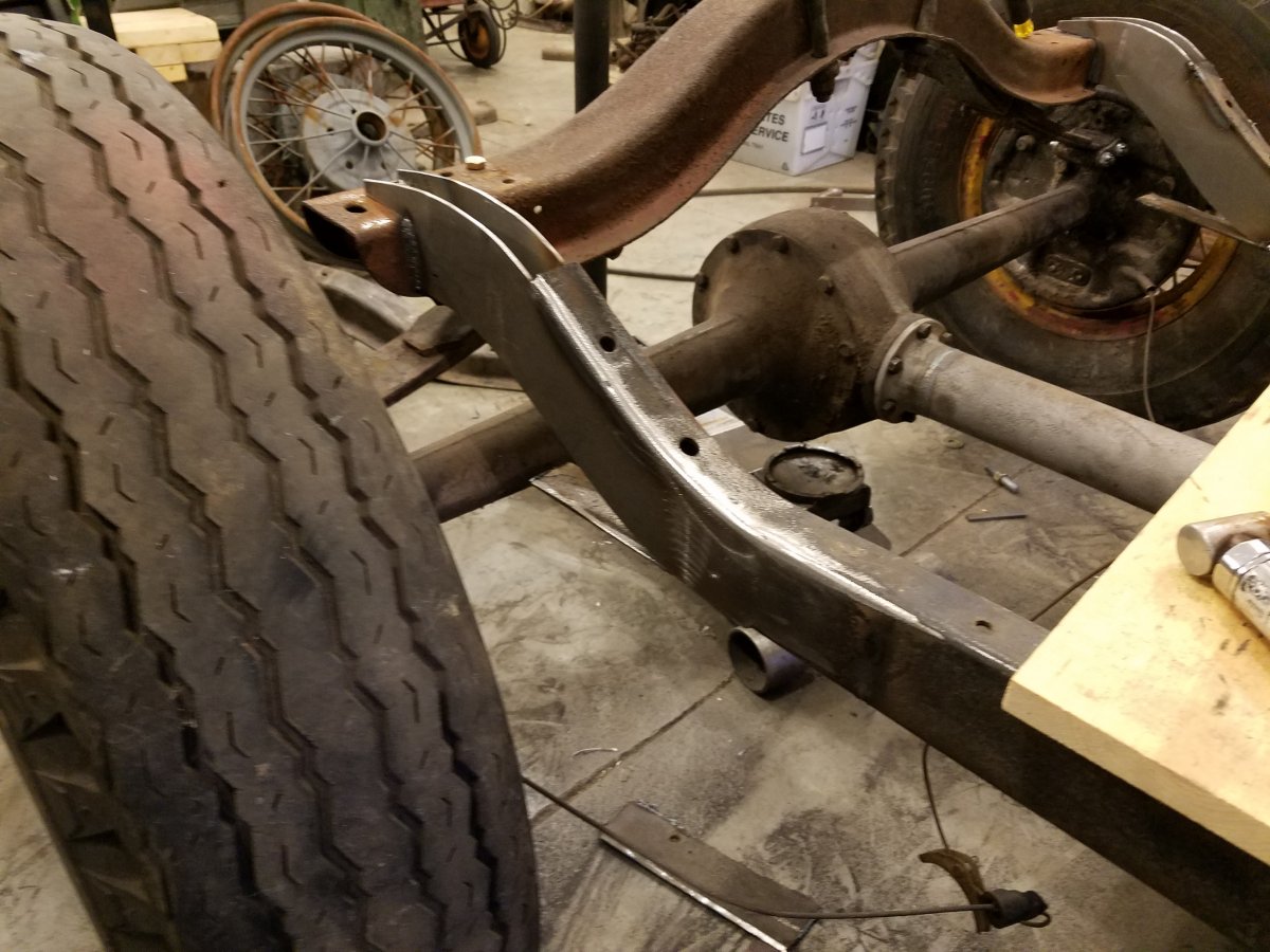

    With the body most wrapped up and needing a change of pace for myself, I moved onto the ch***is. The plans are to run a 4" dropped axle up front so the rear needs to be lowered about the same amount. I do not have a frame table, so I kinda had to fudge my way through this...
    I had another rear cross member that I bolted to the original one with 4" spacers in between.
    I then cut out 4 "S" shaped pieces out of 1/8" steel that would eventually become the inside and out side of the frame. The frame was leveled and supported with jack stands and the rear end was unbolted and supported with a jack. A ton of measurements were taken to make sure everything was level and square before any cutting began.
    I first cut the top of the original rail and bent it up to get it out of the way. Then, I welded in the inside "S" piece. The top was brought down and welded to the inside "S" piece and the outside of the original frame was cut away. This made room for the outside "S" piece which was then welded in. Checking the measurements, everything seemed to stay nice and square...surprisingly.
    The remaining areas that are open on the top and bottom will be completely welded and ground down.

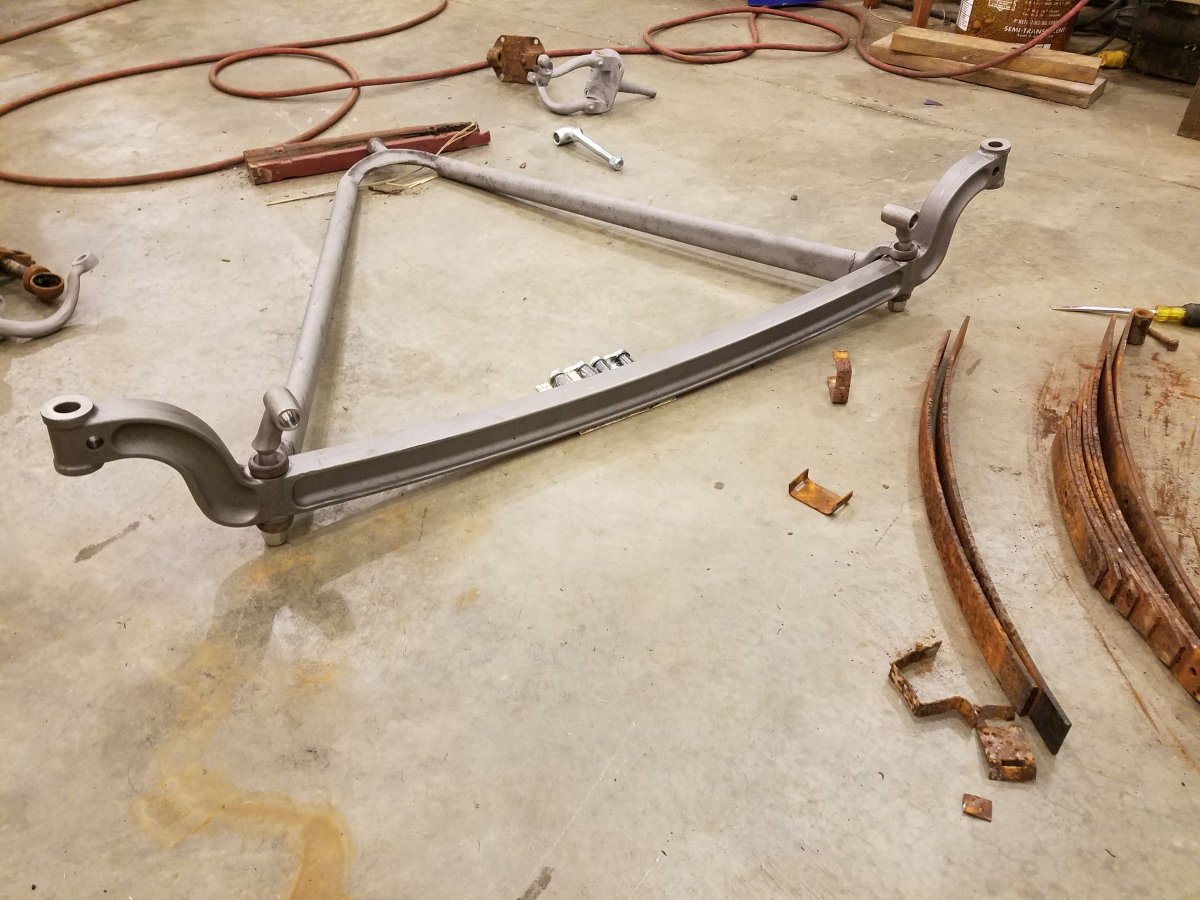

    For the front, there was a little less fabrication involved. I ordered a So-Cal 4" dropped axle and used an original A spring with 3 leaves taken out of it. I am planning to use '32 spindles but they just barely interfere with the kingpin boss on the axle. They should fit nicely with just a little grinding.
    It's getting closer to actually looking like something...

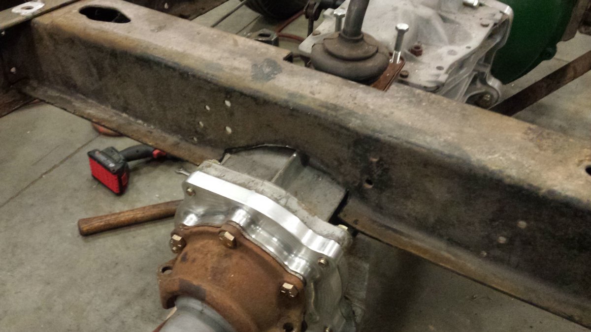

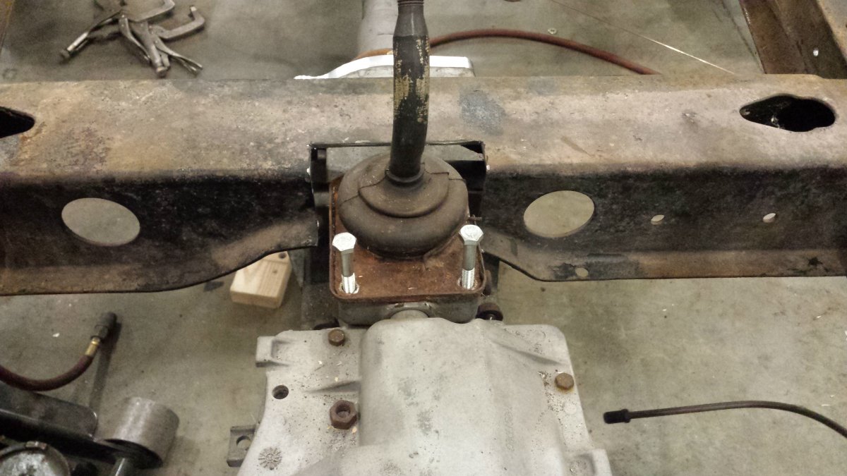

    Binger, I actually use the AA bellhousing, it's about 2" shorter. If you are running a stock cross member, it doesn't have to be cut as much. I use a standard S-10 clutch disc. Napa part# ND-4201. Here are the pictures of what has to be cut on the original cross member when using an AA bellhousing...
    With that being said, I initially looked into using the stock p***enger bellhousing. I was going to make a collar that pressed onto the T5 that allowed you to use the stock clutch disc.
    The internal splines were the 1"x14 T5's and the collar would have pressed onto the pilot diameter. I actually 3D printed one up to ***emble everything for mock up and it seemed like it would have worked well.
    Since I do not have the capabilities to do the internal splines, I sent it out to get quoted by several different gear cutting companies. The best quote I received back would have made the price of just the engine to T5 adapter kit around the $500-$550 range. I didn't think there would have been much of a market for it at that price.
    I certainly can take another look at it if there was enough interest.

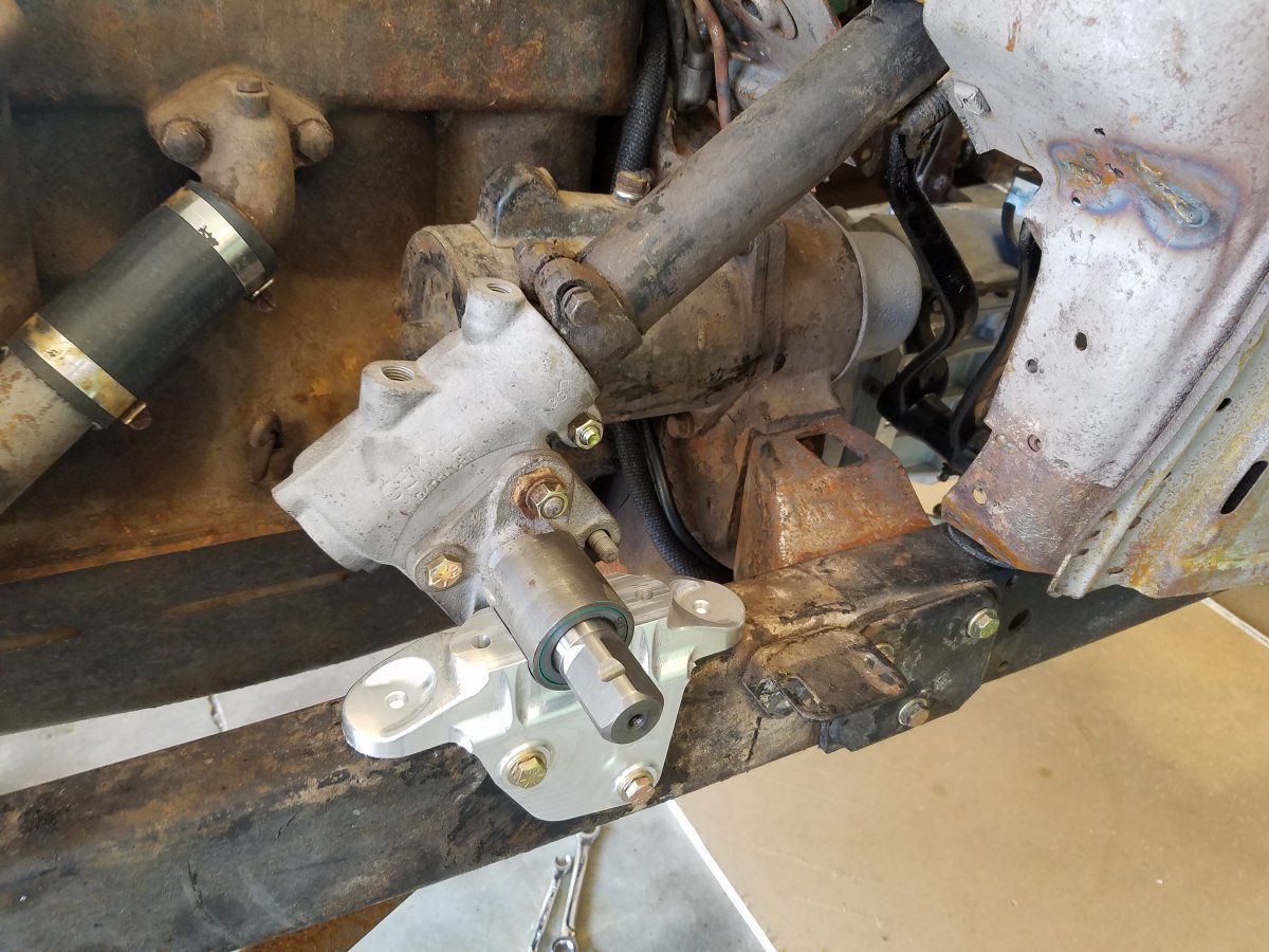

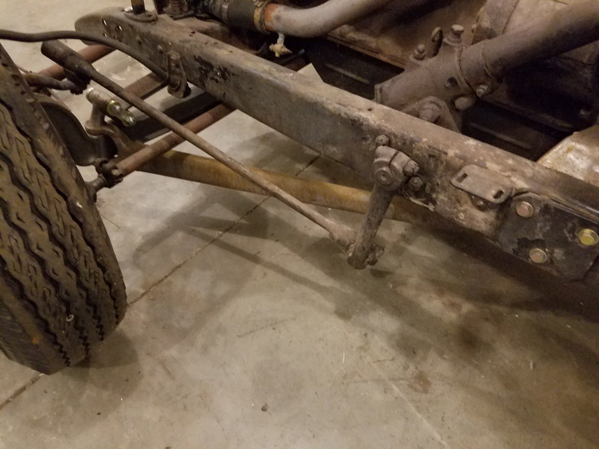

    Another area of concern was the steering box and drag link. It has always bothered me when I see a Model A with a dropped axle, stock steering box and the drag link is forced to run sharply up hill. To reduce bump steer, the wishbones and drag link need to be parallel and the same length. I understand that this isn't really practical but at least let's make an attempt. As the axle swings through an arc, there is fore and aft movement. If the wishbones are long and horizontal to the ground, this movement is minimized. Same applies to the drag link. However, if the drag link is running sharply up hill and is shorter than the wishbones, then there will be more movement relative to the wish bones because it is swinging on a completely different arc. This relative movement will cause the wheels to turn...hence bumpsteer.
    So, since I used a 4" dropped axle, I essentially need to raise the rear of the drag link 4". Snyder's sells a 1"ish shorter pitman arm than stock. This not only helps the geometry but makes turning easier. So to make up the rest, or at least as much as I could, the steering box is being moved to the top of the frame. Also by moving the box, it helps reduce the angle of the steering wheel which I have always felt a bit uncomfortable.
    To start, I took a stock Model A 2-tooth box and cut the mounting flange off. The housing was then turned it down to where it was mostly round. I drew a mount in CAD that utilized the original mounting holes and 3D printed it as a mock up just to make sure everything was correct before I started whittling away on a rather expensive chuck of aluminum.
    This mount moved the box up about 2-1/2" which when combined with the shorter pitman arm is fairly close to where I wanted to be. Is it perfect, no, but it certainly is better than what I started with.

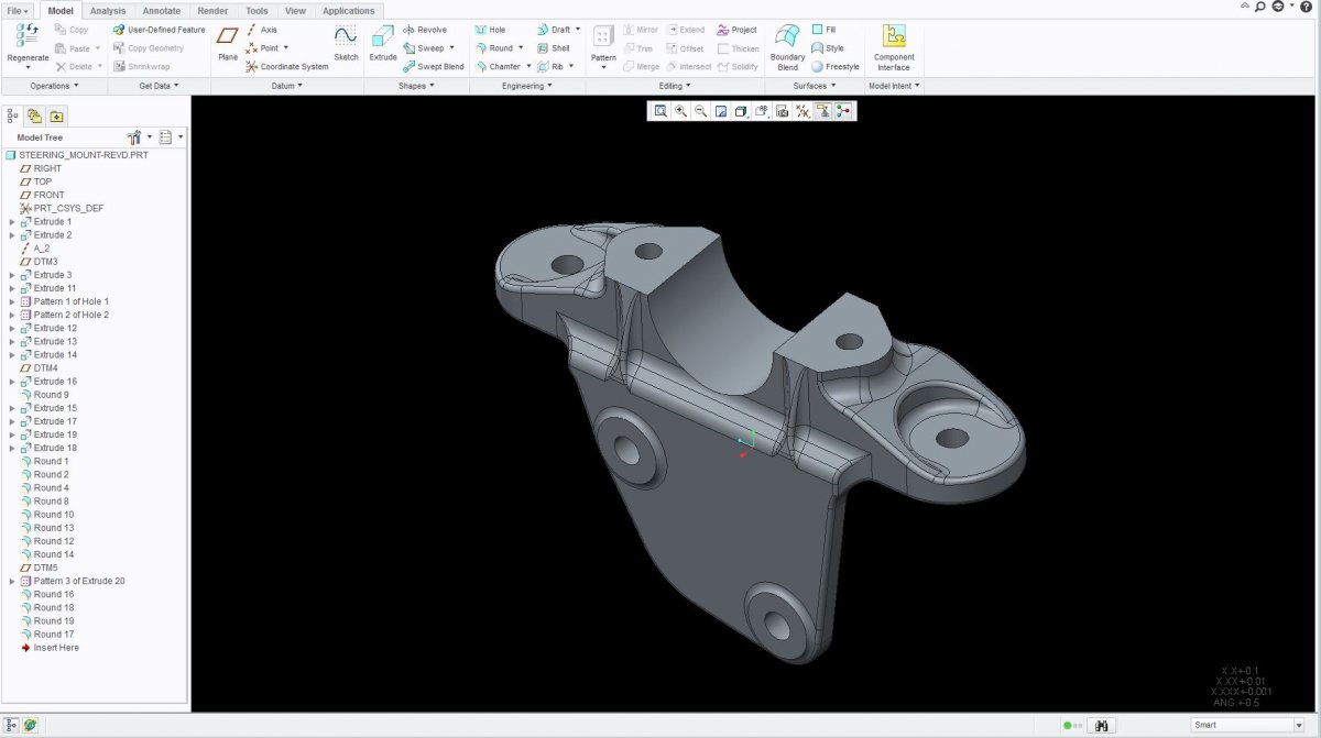

    I started machining the steering box mount. I don't think I could have made it much more complicated but a CNC with a 1/2" ball endmill and an evening's worth of time can whittle most anything...
    Eventually, it will look like this:

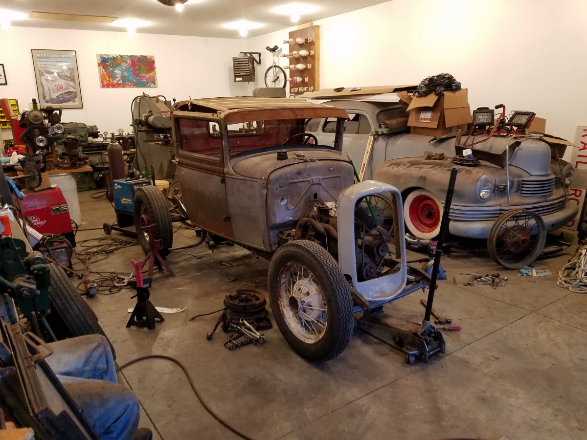

    Once the wiring was complete and some stock fuel lines were added...

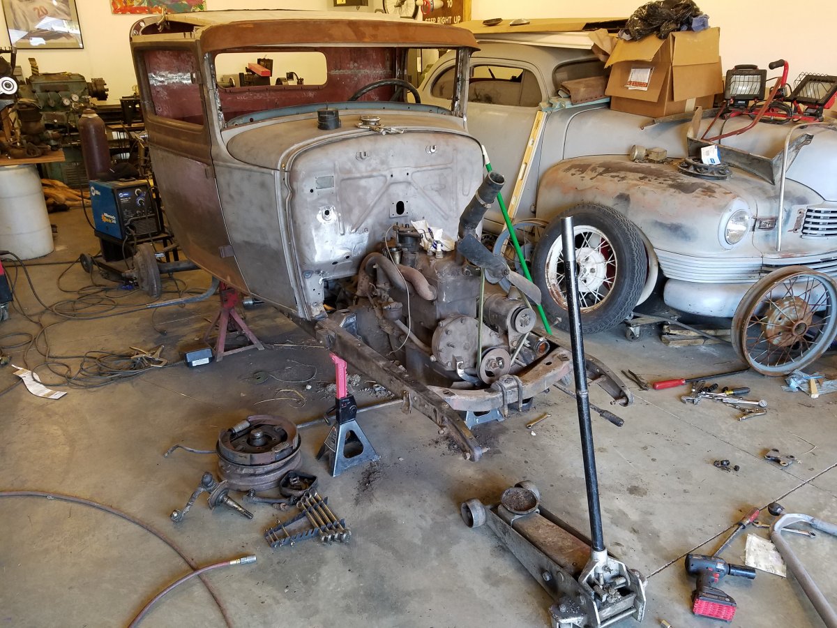

    So now that it runs and technically will move, I should probably focus on being able to steer it. I mentioned in my earlier posts that I wanted to raise the steering box up to the top of the frame to help address the drag link angle. After a couple of mock up designs, I started machining a mount. Now, don't worry, I do not plan on leaving this a solid shiny chunk of aluminum. I want to grind, sandblast and paint it to look like a cast piece. After a couple hours of programming and machining, here it is...

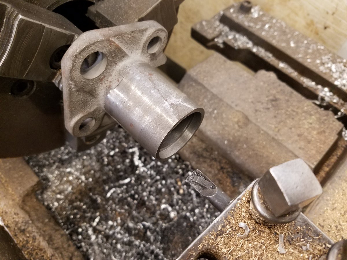

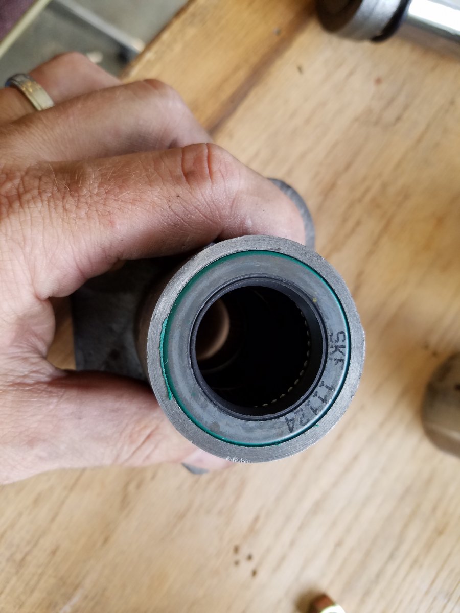

    Since the box is going to be clamped in the mount, I had to machine the original mounting flange off. I also installed needle roller bearings and seal kit from Synder's.

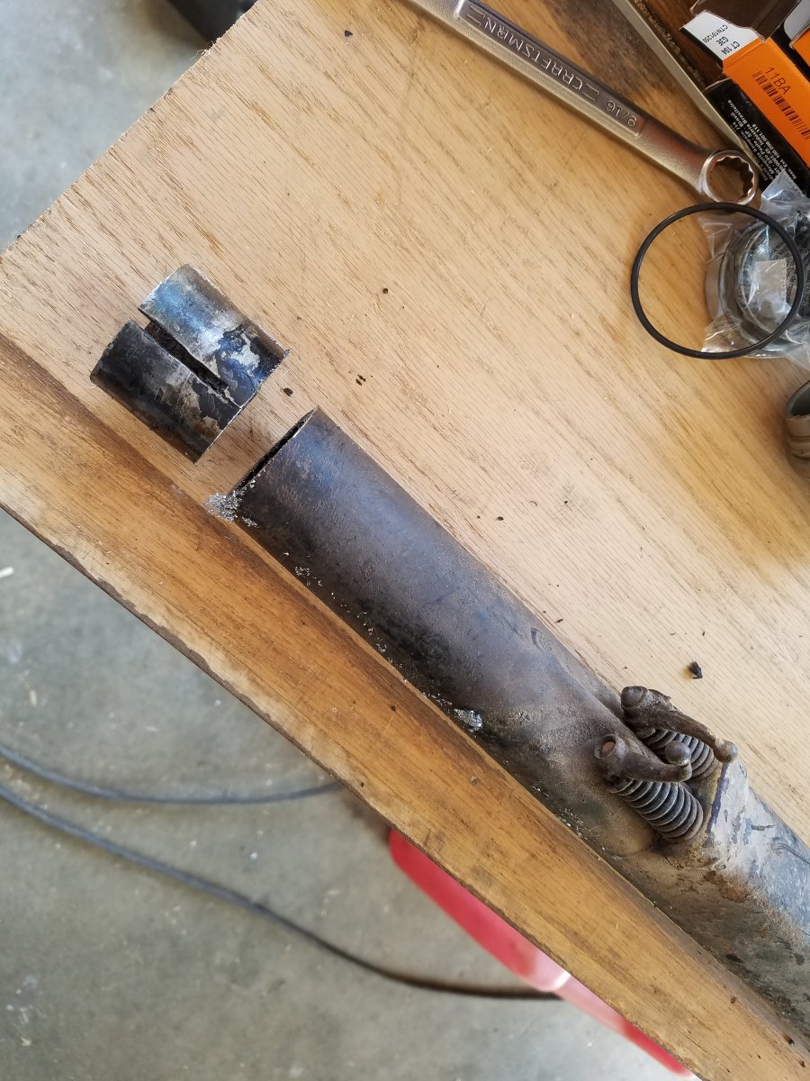

    Because the box moved up, the column had to be shortened. To place the control levers in the the same approximate position, it turned out to be 1-1/2" shorter. I ended up shortening the worm gear end as I originally thought it was simply a straight shaft with a key way. I soon found out after a went to press the the worn gear on that the shaft is actually necked down.
    Once I was ready to put the box back together, I was a little apprehensive of how to properly adjust everything. After a quick search on the internet, I found this site: http://modelabasics.com/twoTooth.htm What a great explanation and thorough descriptions. It turned out easier that I anticipated.
    Onto the brakes next...
