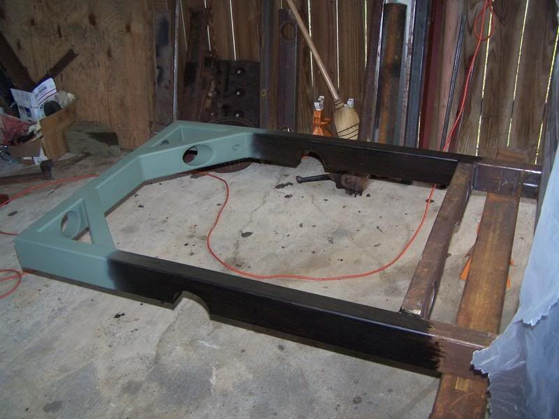

    This is my first build, I'm trying to build a little Hot Rod.

    Oh man your welds look so good, wish mine were 1/2 as nice...

    Hey Jason very nice project and excellent craftsmanship.
    Please make more posts on the project progress.
    Can you tell me/us where the pickup box came from or did you make that also???
    Thanks, Russ.

    Very cool!! I like the holes in the frame for, I assume, exhaust. Keep us posted.
    Awesome build for your first. do I see a T5 behind that Flattie in post #12???

    The bed came from Last Refuge ,I had to assemble it. It's a really nice bed and easy to put together. The tranny is a T5 out of an S-10 the rear end is also out of an s-10 the wheels are wide 5's and the adapters are homemade. I cut the centers of the wide 5's and put them in 16x7 rims so I can run the 8 inch cheater slicks. The holes in the frame are for the exhaust to pass. I channeled the boby 4 inches and z'd the frame in the rear 5 inches. The z is inside the cab, I also double offset the frame so it runs parallel with the bed.
