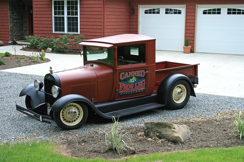

    Mine of course is a 34. Original frame, lowered 4" front axle and
    (oh my god coilovers) attached to the banjo rear. That one has 16'' under it. Really 16's look great with fenders and the larger ones look great without fenders. No rubbing here.
  5. I'd say this truck has a pretty good stance. Kinda makes me wish I had fenders for mine...

    Those huge 16's in rear have an interesting effect on stance...they nicely match tire size and fender opening size, giving the car a very solid and together look back there.

    Thanks its a wonder they don't rub.
    Here's the unsightly coilovers..... Work well, I might add.
  8. sinticket
    Joined: May 6, 2006
    Posts: 580
    sinticket
    That is a beautiful truck Petejoe! I have alot of 16s laying around here...hell i might use them. I love trucks with fenders! what size tires are you running on front...back? Thanks for the info!

  11. Petejoe
    Joined: Nov 27, 2002
    Posts: 12,545
    Petejoe
    from Zoar, Ohio
    Yes, The old mags have them. Usually adorned with cotton at the wheel wells at a show. Never had I seen one on the streets in Ohio in the late 50's and early 60's.
    Tire size?? mmm I'll have to check...pm me if I forget.
    Banjo year? beats me. That came with the truck and had been chromed from the early years.
