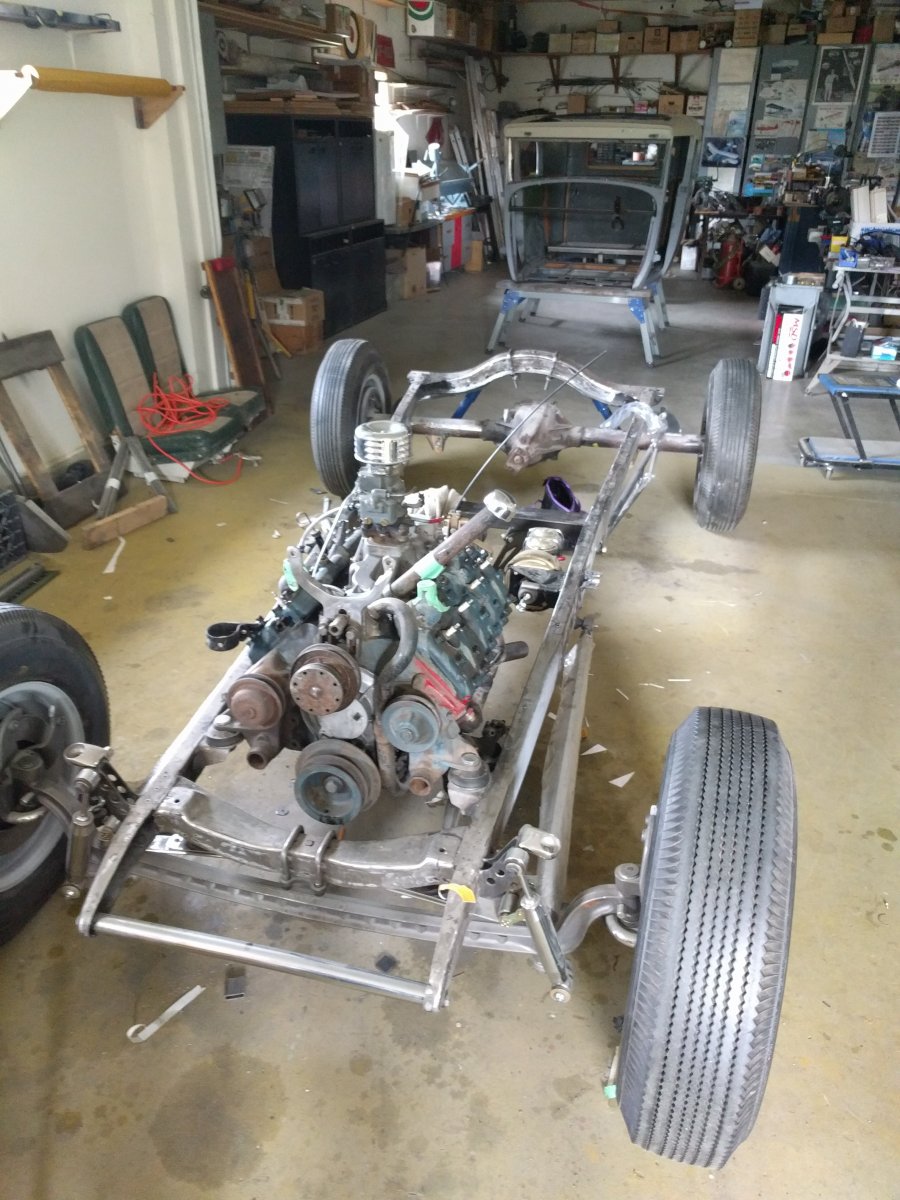

    It's been a long time since I've updated, we've finally got things pretty much all built for the 1st time, now we're blowing it apart to finish/paint the frame, engine, suspension. Then onto the body work and paint. It's been a long road, but there might just be a light at the end of the tunnel.

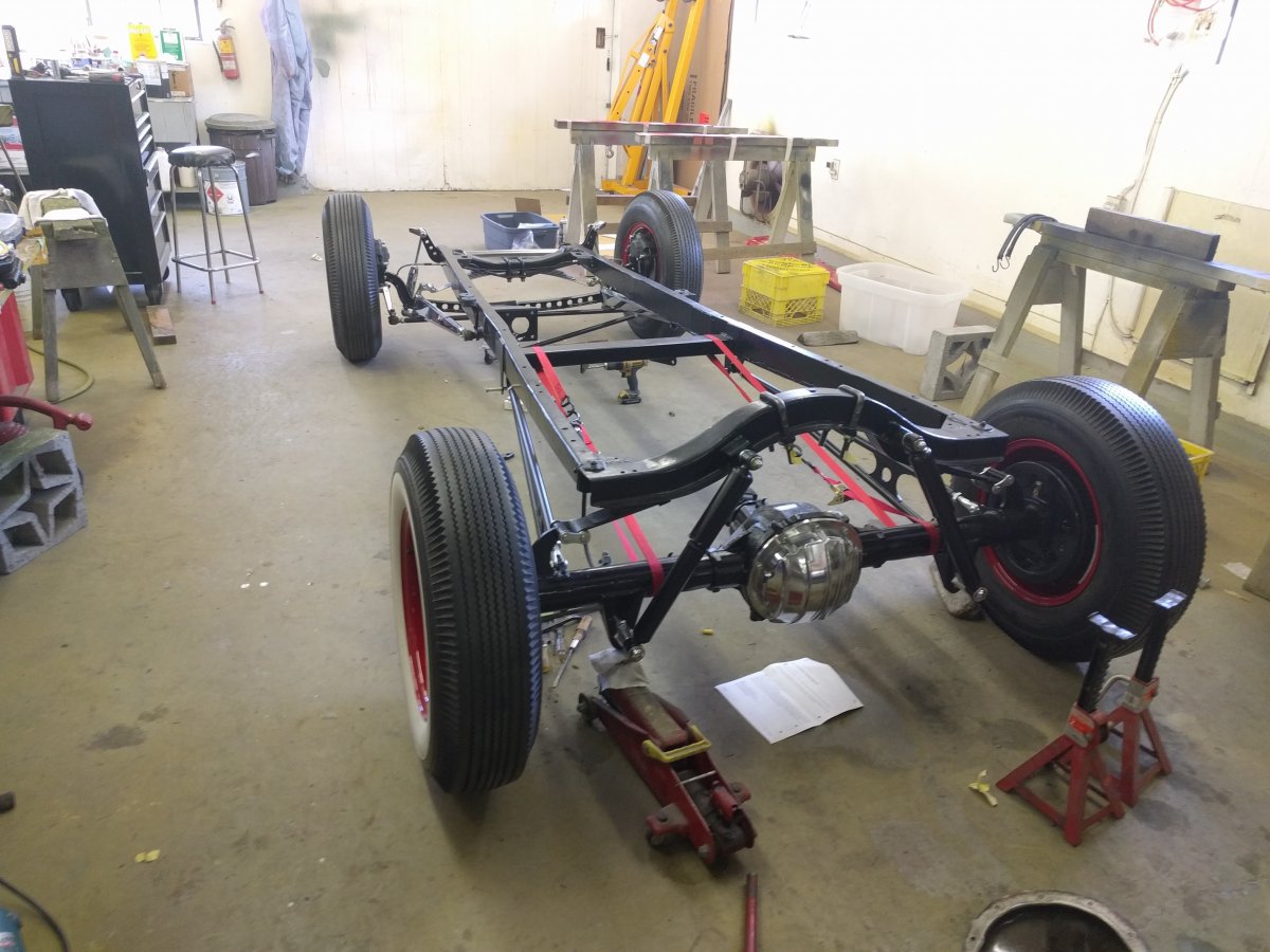

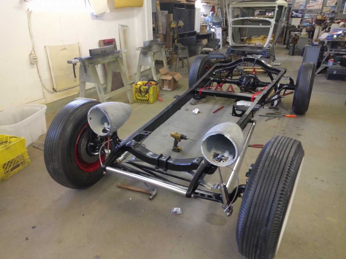

    Here's a couple new pics, doing final assembly on the frame, suspension, etc IMG_20170624_154554.jpg IMG_20170624_154823.jpg
  13. rgriesbeck
    Joined: Oct 23, 2013
    Posts: 82
    rgriesbeck
    from Vancouver
    I need some advice on my front calipers...
    Where do you guys recommend I mount them? In this position, they hit the kingpins, should they rotate 1/4 forward or backwards?
  14. If go a 1/4 turn "backwards"

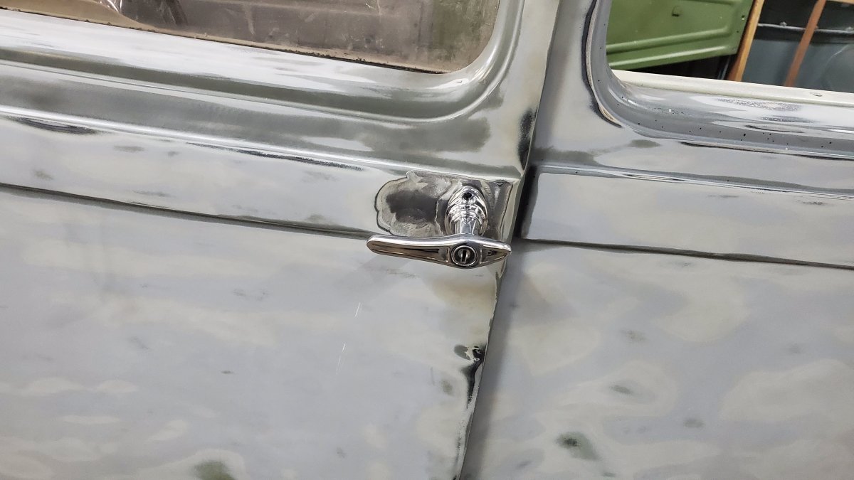

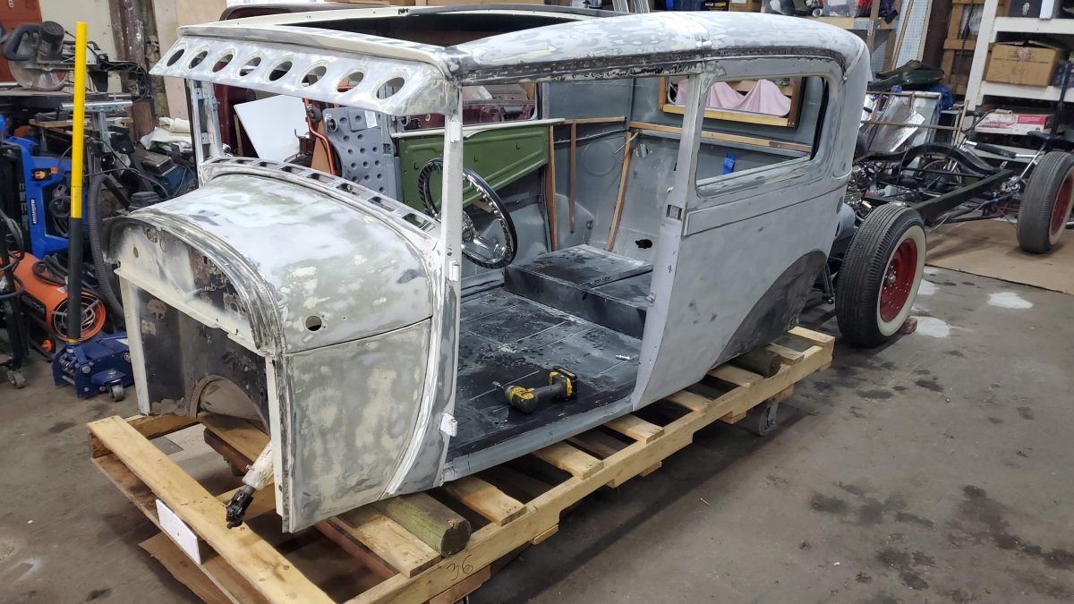

    20191207_135023.jpg 20200421_143222.jpg 20200421_143132.jpg 20200421_172619.jpg 20200421_172627.jpg It's been a LONG time since I've updated things. It's no longer a father/son project, as I've taken it on myself.
    Complete flathead rebuild, most mechanical done, body work time now. I've cleaned the filler out of the drip rail channel and bent up new ones. Also, removed door poppers and installed handles

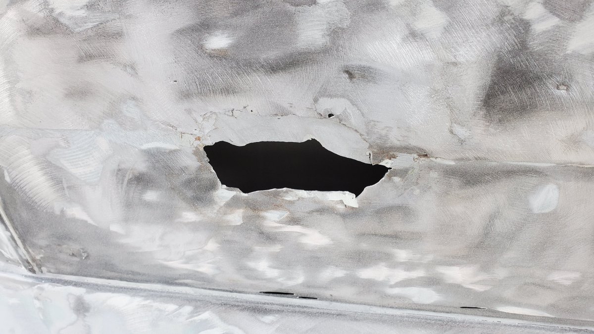

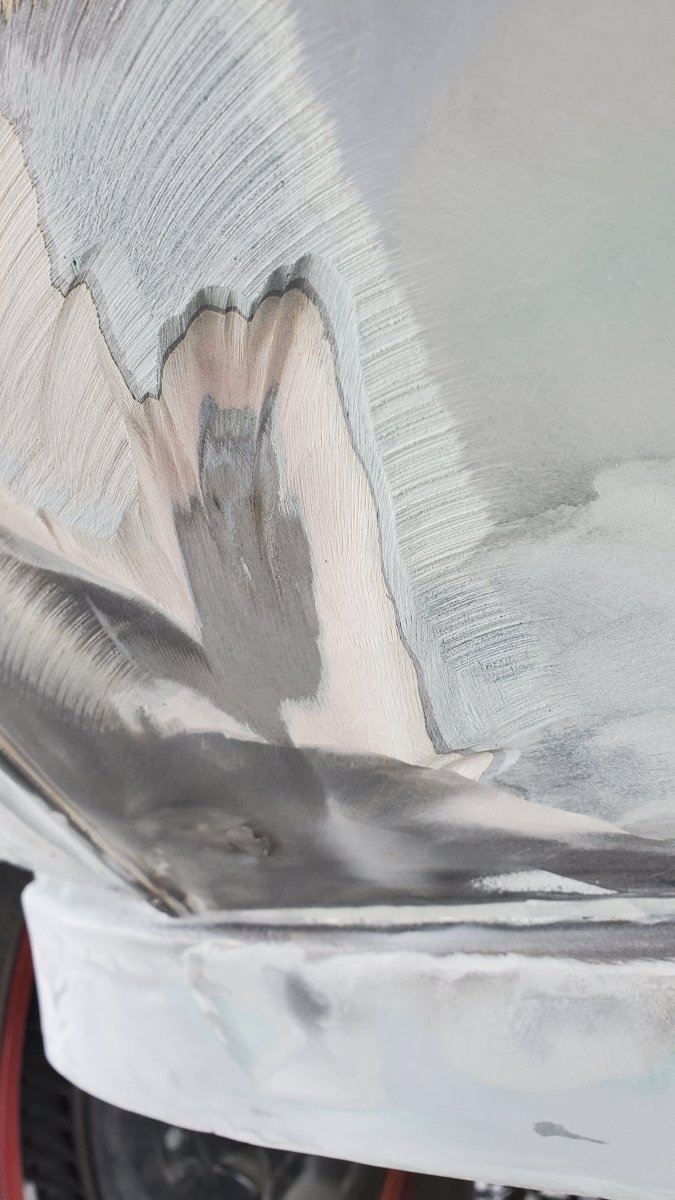

    20200414_142618.jpg 20200414_142625.jpg 20200414_145027.jpg 20200414_145032.jpg 20200414_145228.jpg As I didn't know what kind of primer was on this body, I was advised to sand it off and do it right. Most of it went really well, until I found about 1/2 inch of filler in the back end.
    Took the flapper wheel to it... I guess I found where the lights used to be...
    I've got a new patch panel on order...

  17. Blues4U
    Joined: Oct 1, 2015
    Posts: 8,058
    Blues4U
    from So Cal
    I agree with getting that dried up mud out of there, but I don't understand the reasoning for removal of the primer. I guess unless you were looking to find all the areas of poor body work and/or rust, than yes, by all means go ahead and strip it and start over. But just sanding down the primer because you don't know what kid it is, that doesn't seem right to me.
  18. rgriesbeck
    Posts: 82
    rgriesbeck
    from Vancouver
    I have a friend who works for PPG. We weren't sure if the primer was epoxy primer as it wiped off a bit with thinners. So to avoid the chance of bad primer shrinking or reacting against the new PPG epoxy, we figured safer to sand it down....

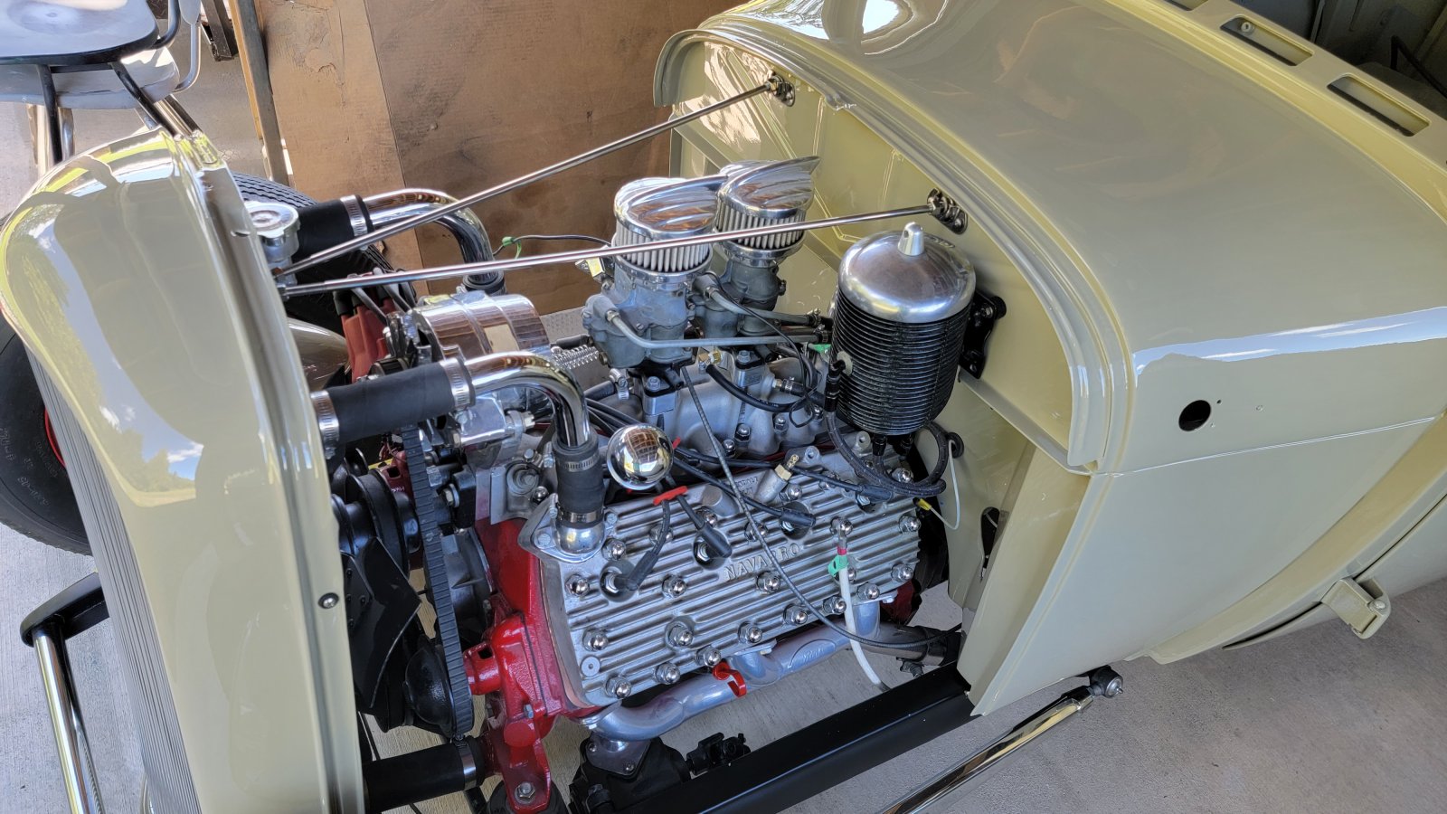

    20210906_152200.jpg 20210906_152149.jpg Finally got the car painted and I'm starting final assembly!
