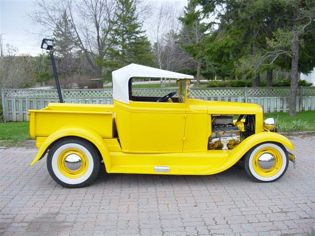

  9. I have considerable experience with this. I built my roadster pickup from a 2 door model A. If you plan on making a phaeton, it is even easier, because you don't have to mess with the body subframe, nor the rear door jambs. The biggest issue you will face is that the sides of the body from the doors on back get really floppy when you cut the top off. You will have to have some good welding skills, and some good panel making skills to fabricate stiffner panels to weld around the inside top edges of the body to finish it off properly. and to give it strength. This is definately not rocket science, and this type of conversion has been done numerous times. If you have any questions, PM me.---Brian
