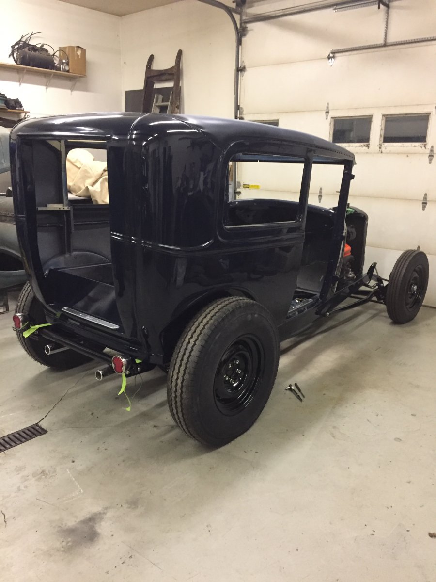

    IMG_0183.JPG IMG_0178.JPG We just did my 30 sedan about 3 month ago. It's a ton of work to do it right. Gibbon Fibergl*** used to make kits for 28-28 tudors. I believe that we did it better than an original.

    IMG_0024.JPG IMG_0024.JPG painted rear.jpg Since then we added a very cool drip rail. and some interior sheet metal. We painted a very cool dark blue, almost black.

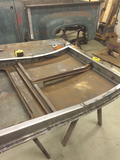

    sorry I double clicked the full size ****on. But it's come along way in a year. By the way, we cut the back out and used it for the door. 1/2 inch of metal was added back to the body all the way around the door for the correct overlap. Gary

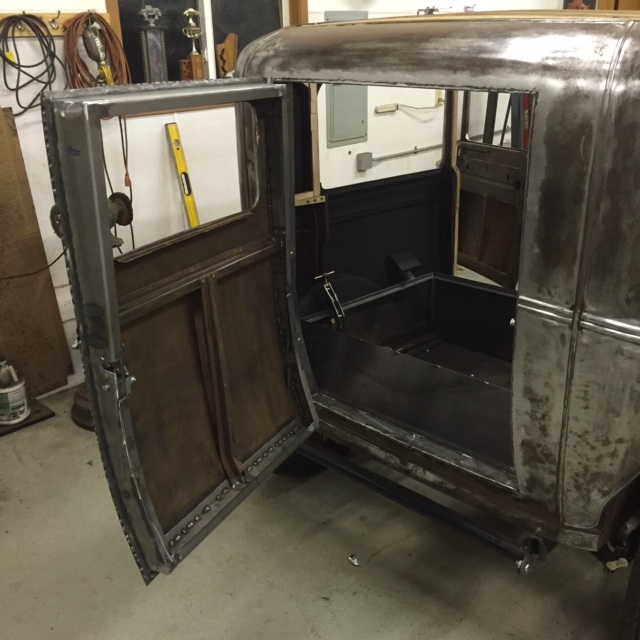

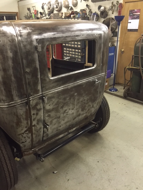

    HINGES-1.jpg HINGES.jpg Here are some pictures of the hinge area. We used Speedway Builders Series (economy) hinges and they worked great. You just have to keep the hinge pins on the same angle. We used a long piece of all-thread to keep everything line up. I plan on installing all the gl***. My seat will be set back a little bit, so I don't want a huge blind spot.

    I guess in Australia they call this style a "Tudor Delivery". It took guts to cut the back out of a very nice Tudor body. We had to stare at it for a couple days. Gary IMG_0372 (1).JPG
