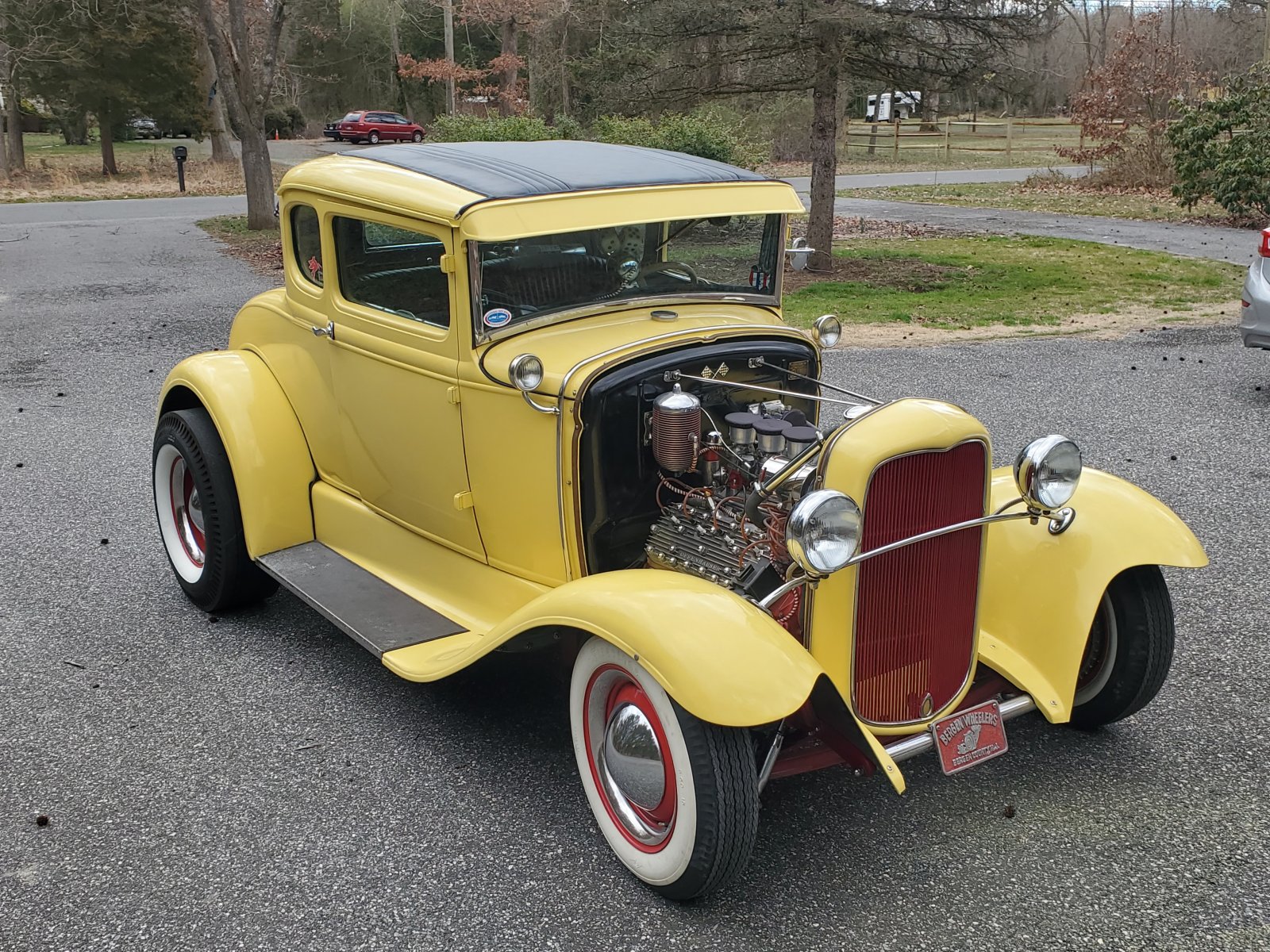

    What exactly do you want to know? This was my dad's car, it has a '32 K member with legs and the torque tube, 8ba, mechanical fan. Firewall had to be recessed a tad. This is running split wishbone up front. 20230304_103721.jpg

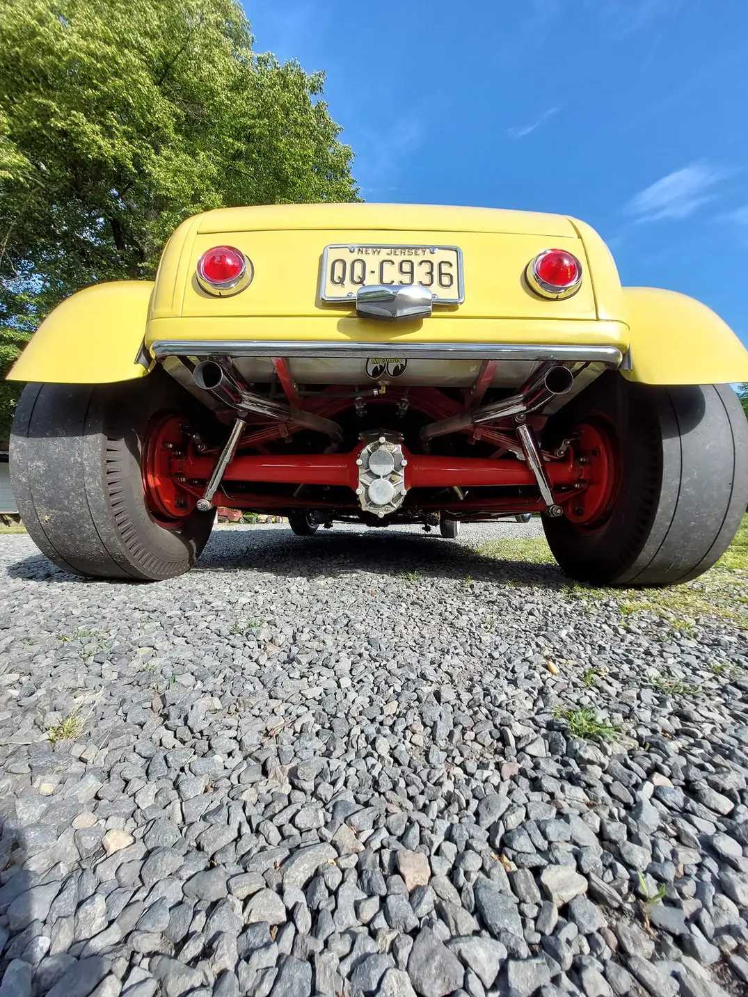

    Beautiful car: What does have for rear suspension, frame kicked up or reverse spring eyes etc?

    Thanks Steve, it's 40 rear with pirches welded on top. It's got a posies reversed eye spring in it, the narrower version. Frame is stock. It had a stock A rear spring in it for a while but it was a little to high in the back, and the spring would bottom against the welded on perches on bumps, so the inch narrower reversed eye fixed both issues. 1685381911512.jpg
