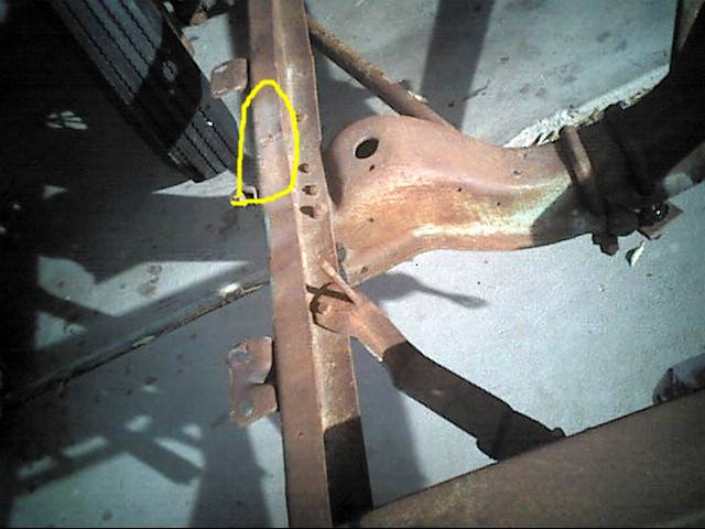

    All model A's,were stamped on the frame left side,under where the cowel
    bolts on.If you find a number on the frontof frame by engine,someone else
    put it on there not ford.Replacement engines came with no no's so you
    cant rely on eng'no'.The whole thing is big bag of worms.

    When I first started boxing and working on my model a frame I looked everywhere and could not find a serial # under all that rust even blasted and could not find it.It was pitted too. Just stamped #'s that match the ***le in the frame. Mine was pieced together hard to find out what went with what. Its a 80yr old car, you will be lucky if you have ***le #'s matching stamped frames or motors if not. Use your imagination and you can get it ***led.:D
