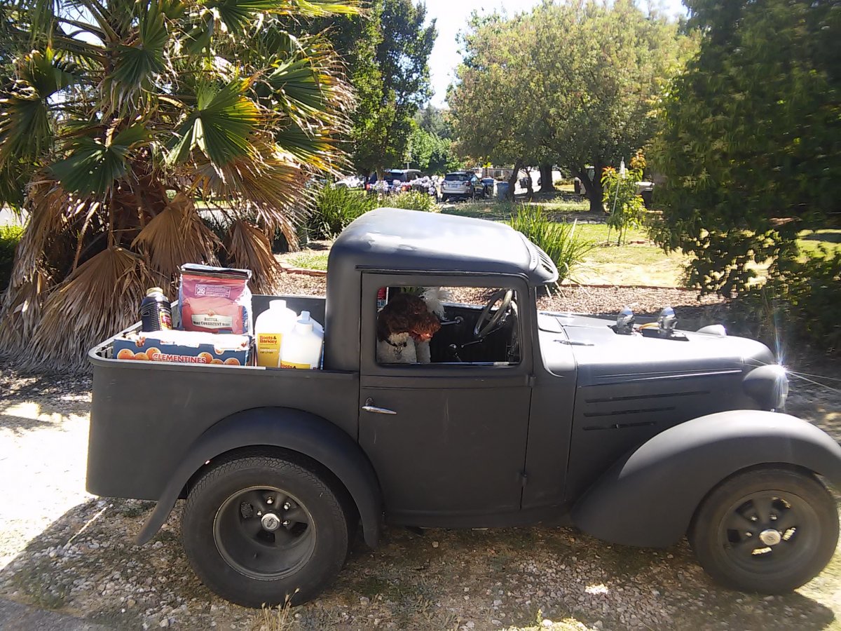

    That's what I use mine for, seriously. I used a hole saw but on a drill press. Would be a bear on the car since it's not flat, lotsa snags for hand drilling.
    kiwijeff likes this.
  14. Blowby , what kind of truck is that ? Very cool !

  16. blowby
    Joined: Dec 27, 2012
    Posts: 8,664
    blowby
    from Nicasio Ca
    Thanks! American Bantam.
    kiwijeff, Fern 54 and ABONES like this.

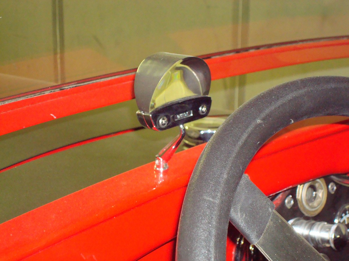

    I use this gadget on my '29 CCPU with the stock visor to see traffic lights. Works great DSC02715.JPG
  18. Yea those have been around for a long time, I think I have one someplace. Just that I could never see any other use for "speed" holes other than to see out better. :D

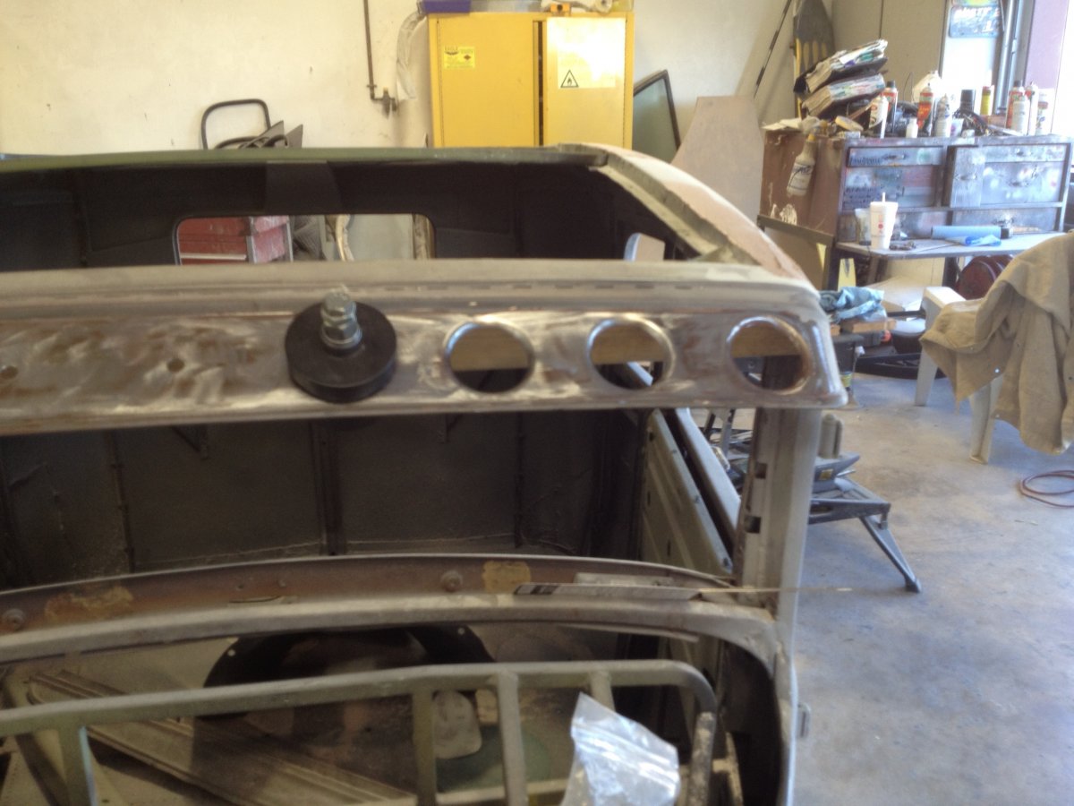

    Punch and flare on the car isn't hard. Drill a pilot hole and then just screw the die till it pops the (flared) hole. DSC02407.jpg DSC02409.jpg IMG_1401.jpg IMG_1402.jpg
