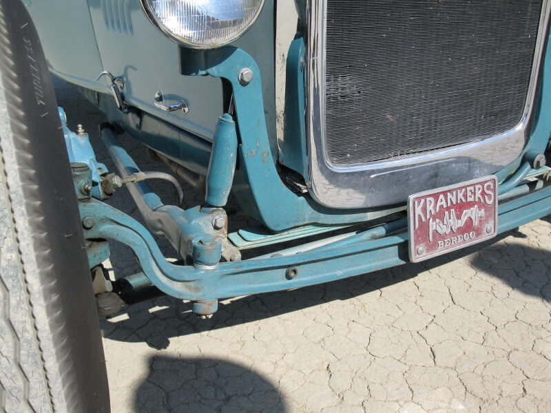

  11. A Boner
    Joined: Dec 25, 2004
    Posts: 8,137
    A Boner
    image.jpg image.jpg With a model "A" frame you can also do a Rolling Bones style front suspension like on this car to get the front low.
  12. Stock Racer
    Joined: Feb 28, 2010
    Posts: 1,344
    Stock Racer
    Thanks for posting the pics. I was really trying not to hang stuff off the bones but obviously this has been done successfully. Another thing to consider.
