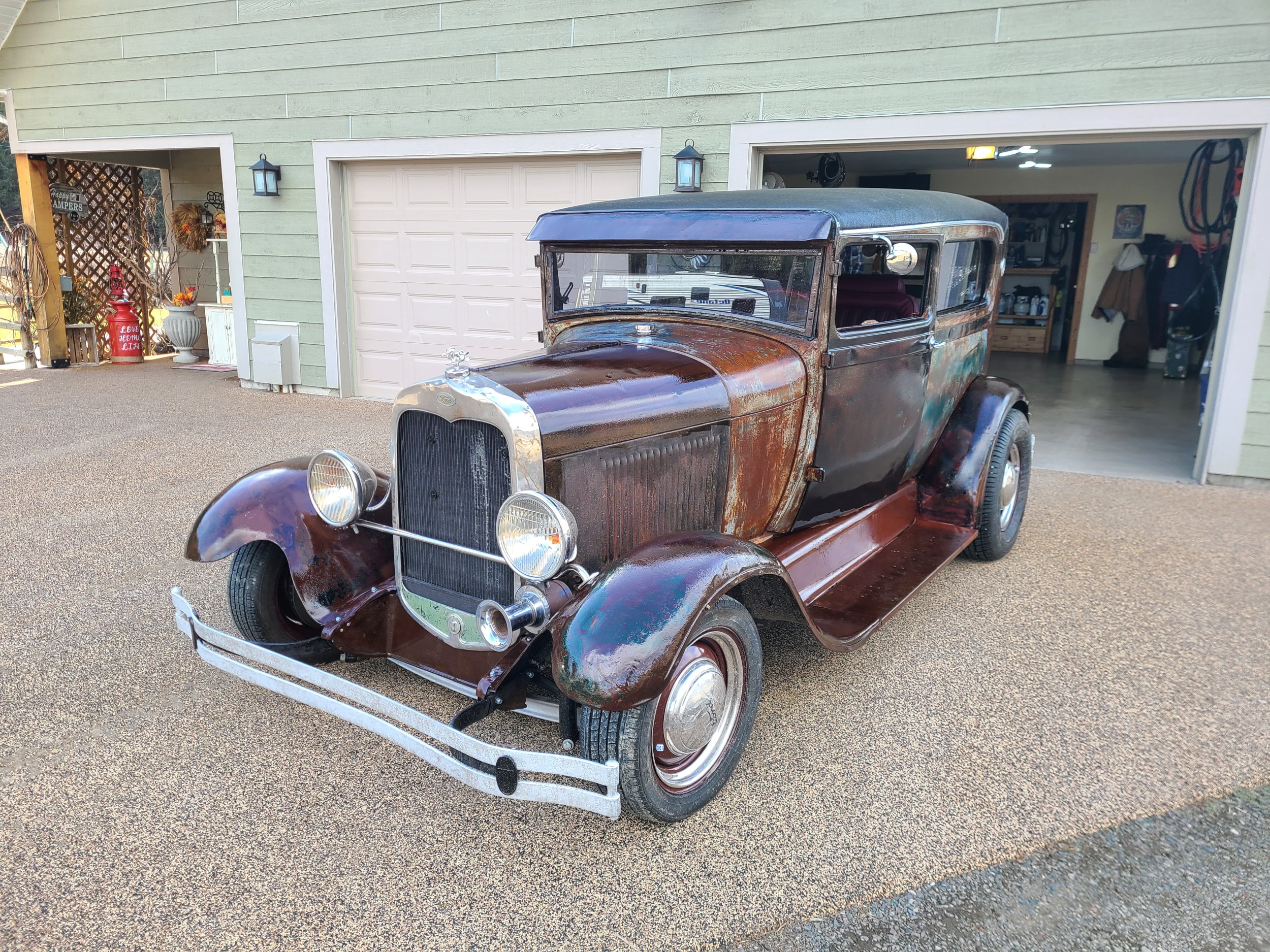

  1. Okay, so it's been a long, long time since I've posted anything. But I'm looking to get some information from people smarter than me. I know there's lots of them here. My latest build, the 1928 sedan. With the usual four inch drop axle, Vega box etc etc.
    No different than any other Rod I've 20250308_144155.jpg built before. The problem with this one is it really likes to wander. Anything over 50 miles an hour on the mildly twisty road and it hunts all over the place. I've done the wheel alignment three times. (Caster) The last time with the wheels off and angle iron bolted to the rotors. Running approximately 1/8" toe in. Put all new tires on (radials) steering is tight and responsive regardless of speed. But anything over 50 miles an hour and it's both hands on the wheel and white knuckles.
    Any ideas?

  6. All good questions. Try to answer as best I can. A different road. Great idea. Not. It has split bones front and rear with a triangulated setup as well on the rear. And a panhard bar. Caster is currently at 5°. Positive. Frames stock, boxed, no kick up in the rear.

  19. I can't thank you guys enough for all these replies just in the last couple hours. Sometimes you need somebody looking from outside the box. This is not my first build but it's my first build with a problem like this. And I think some of you are absolutely right. I've just been lucky in the past by not having a panhard bar in the front. I'll be making one tomorrow.

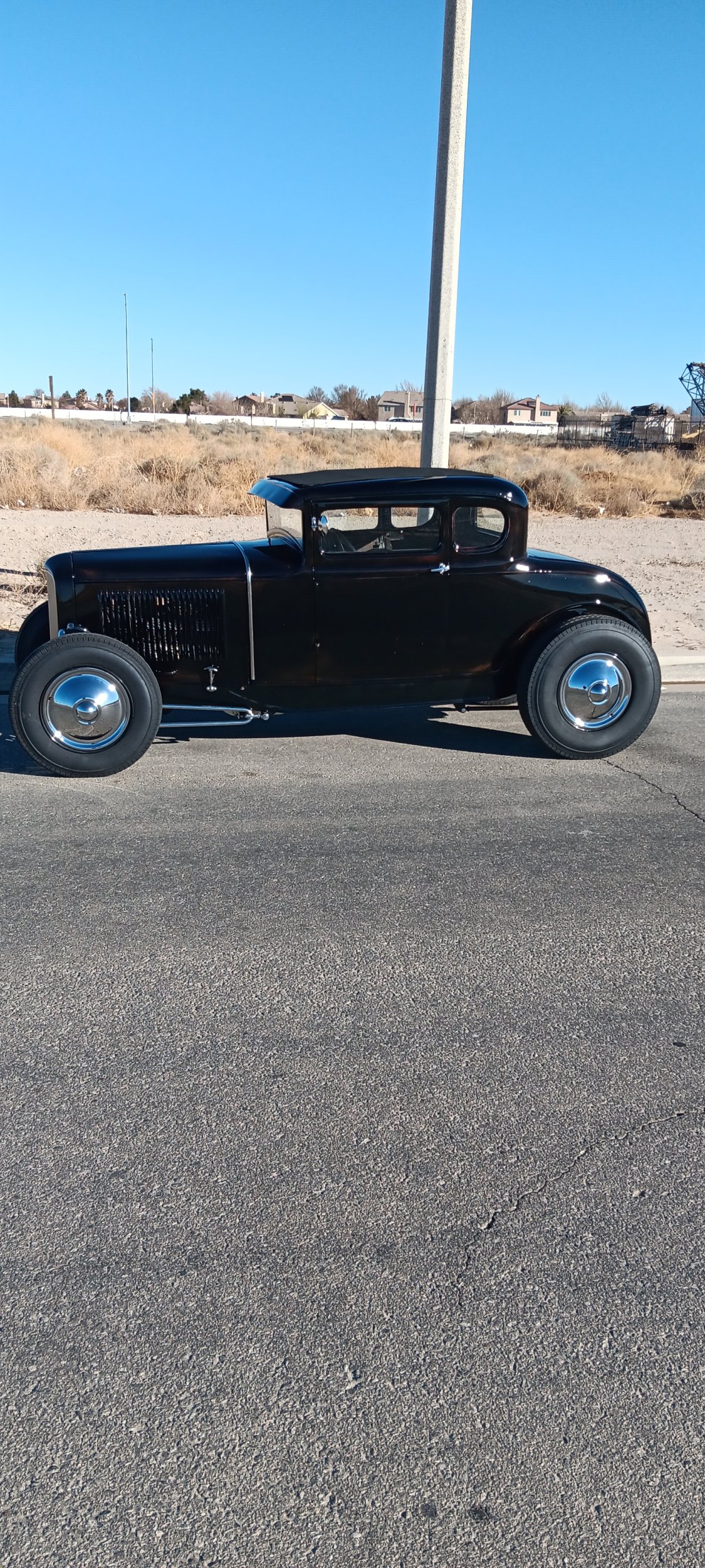

    On the front of my roadster I put a dead perch on on side and have a panhard bar in the rear. It drives like a rail and corners great. Gary cold or wet.jpg original d.jpg

    The reason I'm asking about how your panhard bar is anchored (I thought it had one on the front too), is a friend learned the hard way that it matters where it attaches to the axle. The panhard should attach to the ch***is on the same side of the car as the steering box (driver's side), and attach to the axle on the opposite side (p***enger's side). If it doesn't, you'll get some real bizarre bump steer characteristics. Keep that in mind when you're building your bar.
