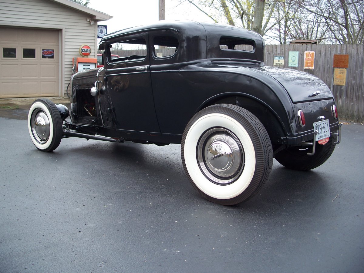

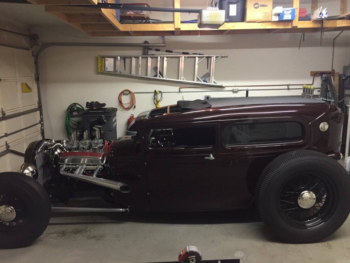

    I’m just starting my 29’ Model A sedan project. I’m planning on a 6” chop, 3” channel on a double z’ed frame. I want a big n little look but nothing two radical. I like the look of the photo attached. Can anyone point me in the right direction of the wheel and tire size I’m looking for? Thank you. IMG_4317.JPG

    7.50x16 on the back. 5.50/5.60x 15 front
    Dino 64, Just Gary and 51 mercules like this.
  3. Tim
    Joined: Mar 2, 2001
    Posts: 20,630
    Tim
    from KCMO
    Could be 450x 16 up front they do look smaller than a 500/525x16 though
    wheels are likely ford 40-48 and 16x4.5 give or take half an inch. Looks about the same regardless of the extra width

    @travisfromkansas took the photo he may be able to tell you who’s car it is as it’s slipping my mind at the moment and you could ask them

    Thank you guys for all the feedback. This is my first pre war hot rod. Mainly been into Tri 5 Chevys up to this point. I appreciate the advice on squeezing into the car with a 6 inch chop as well. I’m 6’3” so not too short.. Planning on an auto ******. I will definitely be seeking advice from you guys each step of the way, this is by far the best group of hot rodders out there in my opinion. As far as wheels go I just ordered a set of 35’ Ford Wires from a fellow H.A.M.B. member. Can I run a 7.50 for the rear on the 4” inch wide wheel?

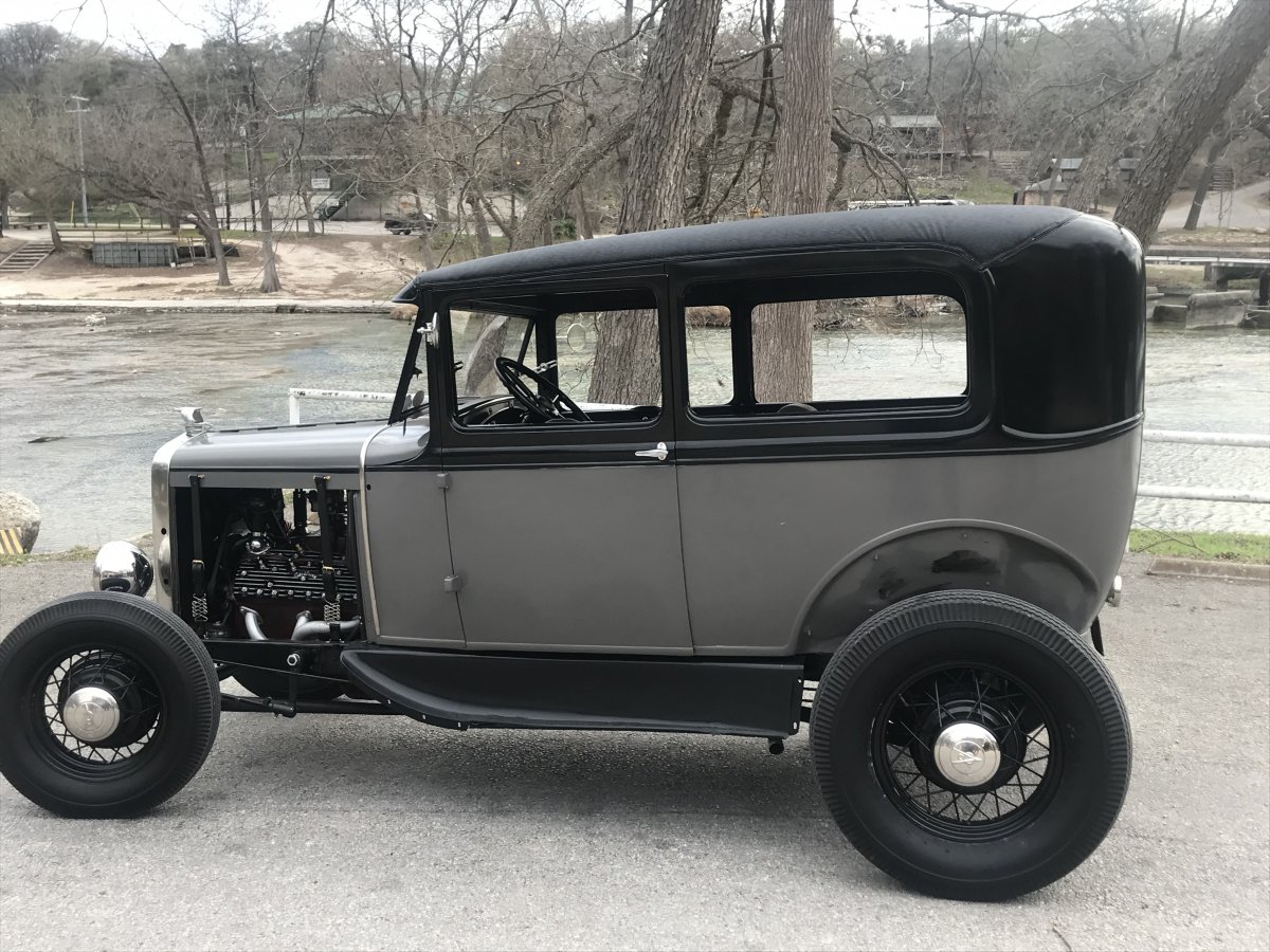

    4.50/4.75x16 and 7.00x16.. **clic pic** 100_3565.JPG 100_3582.JPG 100_3581.JPG

    Sweet looking cars Ron, I was definitely thinking that I was gonna have to run the seats low. Probably bombers or something along those lines.. Hopefully something that can be somewhat comfortable.. Excited to get the wheels here hopefully next week and then get them out to be powder coated. Going with Firestone’s for the tires, 7.50 in the back and leaning towards 5.00/5.25 in the front but still torn there.. I will keep you posted as the progress continues. Been focusing the majority of time so far on rebuilding the engine and rear end.

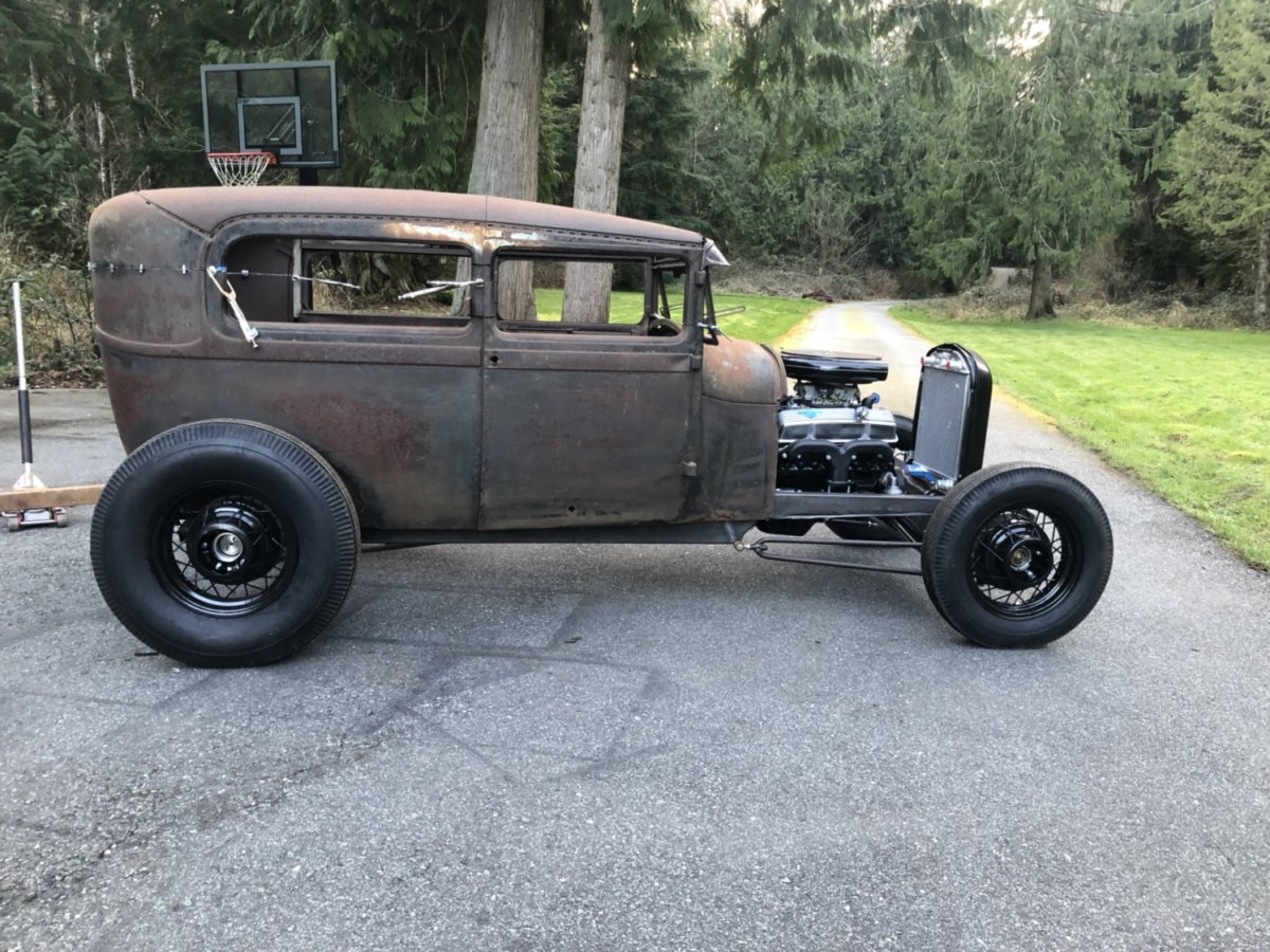

    Thank you again everyone for the feedback.. I ended up going with 7.50x16 in the back and 5.50x16 in the front.. gave me the exact stance I was looking for. I also took the advise of not chopping the car as severe, went with 4 inches with no channel. IMG_5448.JPG
