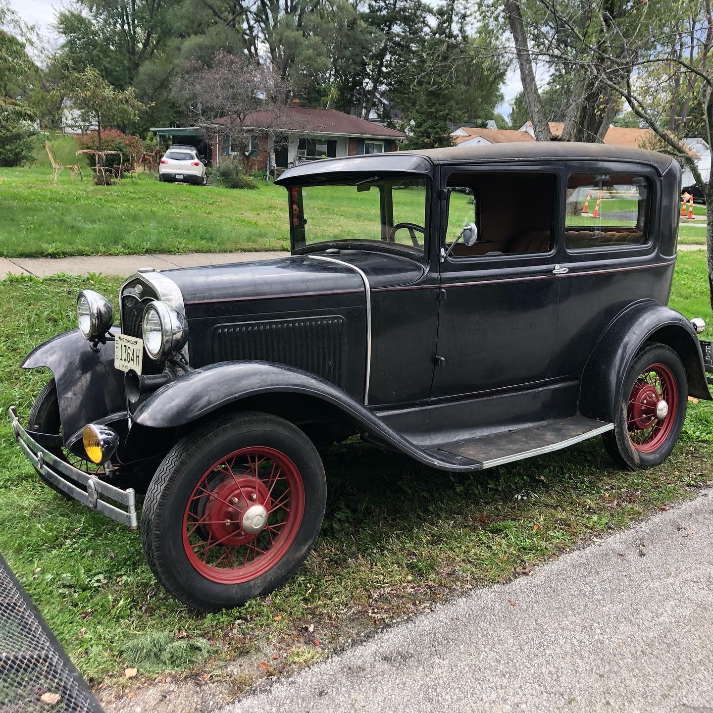

    I have a 1931 Tudor sedan that’s bone stock. I have an av8 ch***is I’ve been building and it has brand new firestones on it in 7.50-16 and 6.00-16 size. What do I need to do to safely mount the 1940 wheels on a stock
    Model A. I thought it was as straight forward as bolt on a go but I was told it is not. I’ll search for some 16” Kelseys if I have to but I like the 40 wheels better and I already have um. Just trying to enjoy it a lil bit while I finish up the av8 ch***is

    I mean this with no disrespect to the knowledgeable older fellas on this site but the only issues with the stock wheels are well…..they are grandpa-ish. That and I have brand new bigs and littles on my av8 ch***is. I’m gonna eventually av8 the car but for first year or so, I wanna take the bumpers off, reverse the spring eyes and do the wheels
