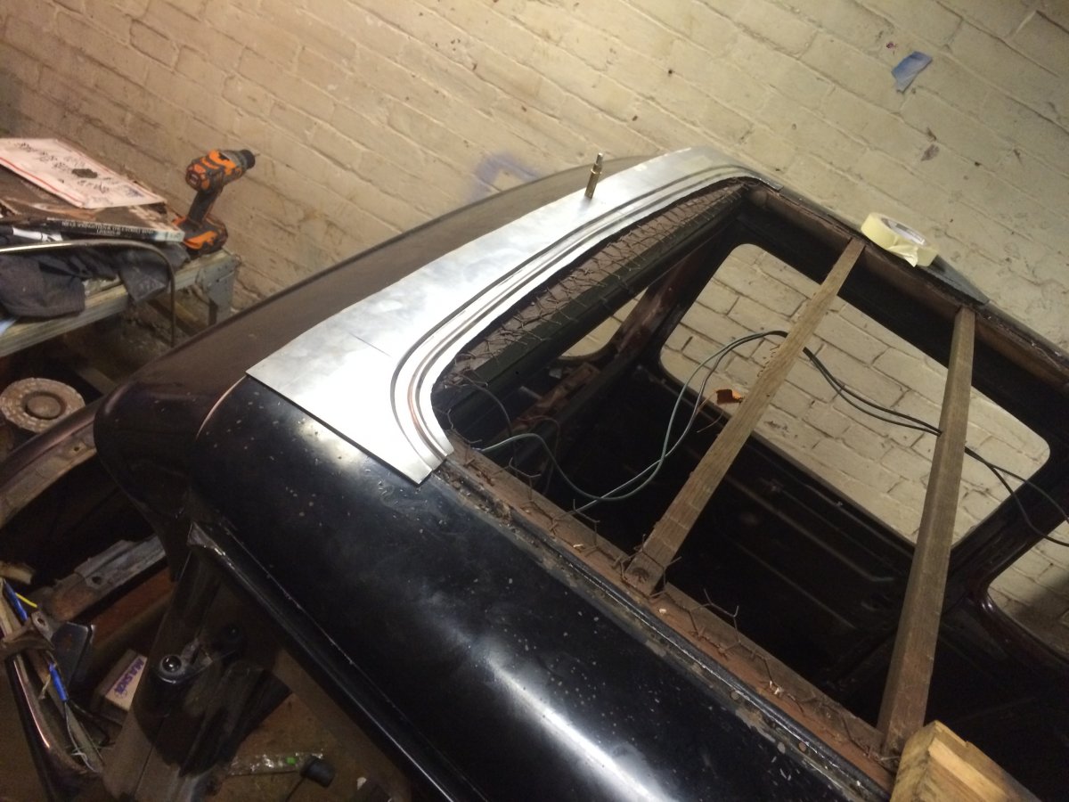

    Don't know if you saw this, on the 3W conversions thread? Meant to be a Vicky cowl and doors on a coupe body.

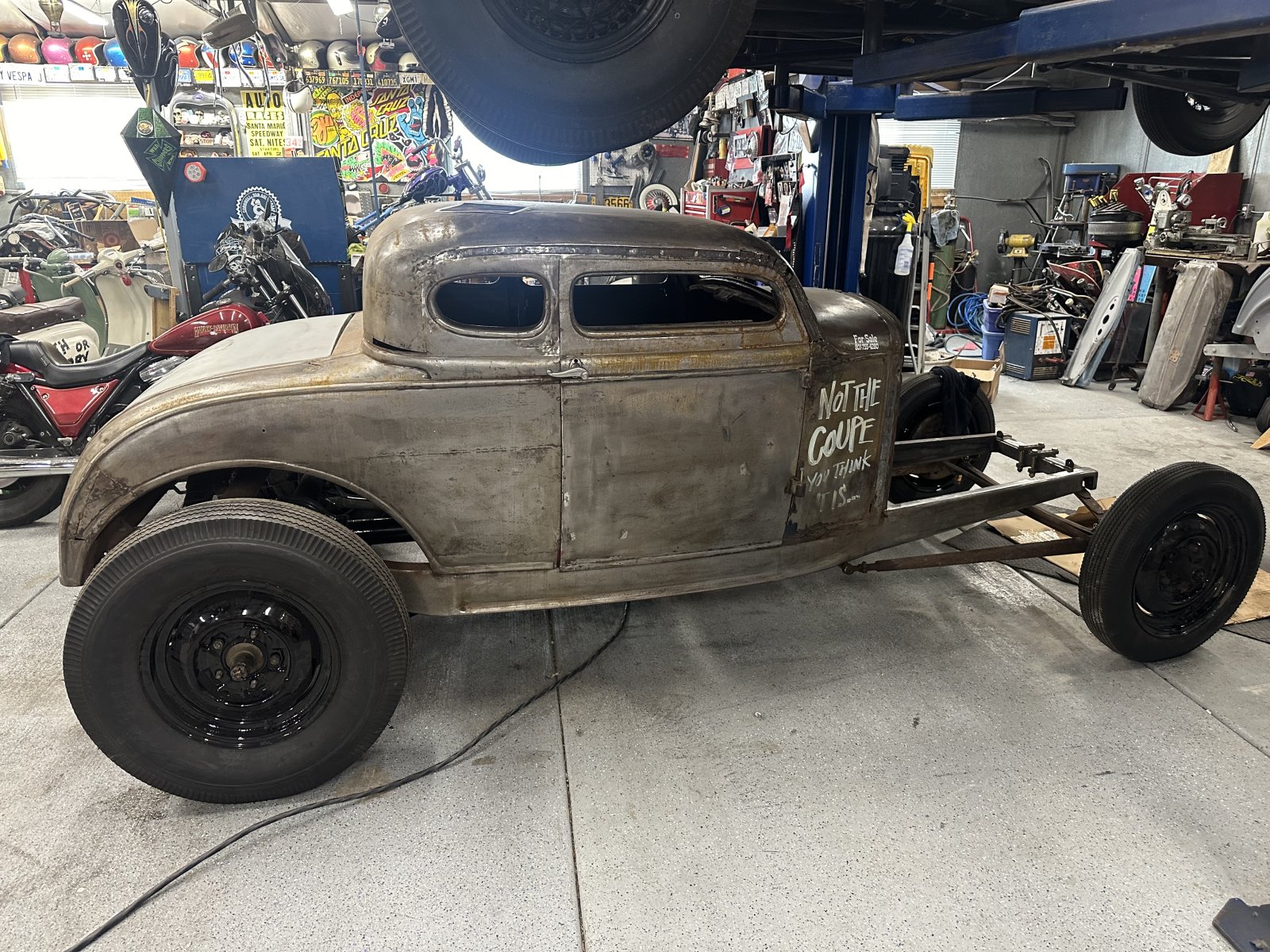

  10. This one was for sale here on the hamb. 598B879E-D570-40D6-8633-3B937A04A70A.jpeg
  11. WOW:cool:!!

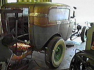

    I sorta 32-ized my '31 Ford Slantwindow 4 door turned Sedan Delivery.
    -Rolled/rounded roof over the windshield and rounded the corners of the windshield frame.
    -Welded 1-1/4 inch strips of metal over the 2-line beltline of the Model A to make it more like a '32.
    -Chopped it 3" in front and 3-1/2 in the rear and leaned the A pillars slightly farther back.
    -Built a flat "32 like" firewall.
    -Welded in a '32 Ford cowl vent.
    - '32 commercial grille shell
    I originally built it on a Model A frame and ran it for a year. I later bought a set of ASC '32 frame rails and added/grafted them from the cowl back to give it a more '32 look...so it actually had 2 frames under it. 0.63.jpg 0.69.jpg 0.67.jpg 0.65.jpg 0.66.jpg 0.64.jpg 0.68.jpg
