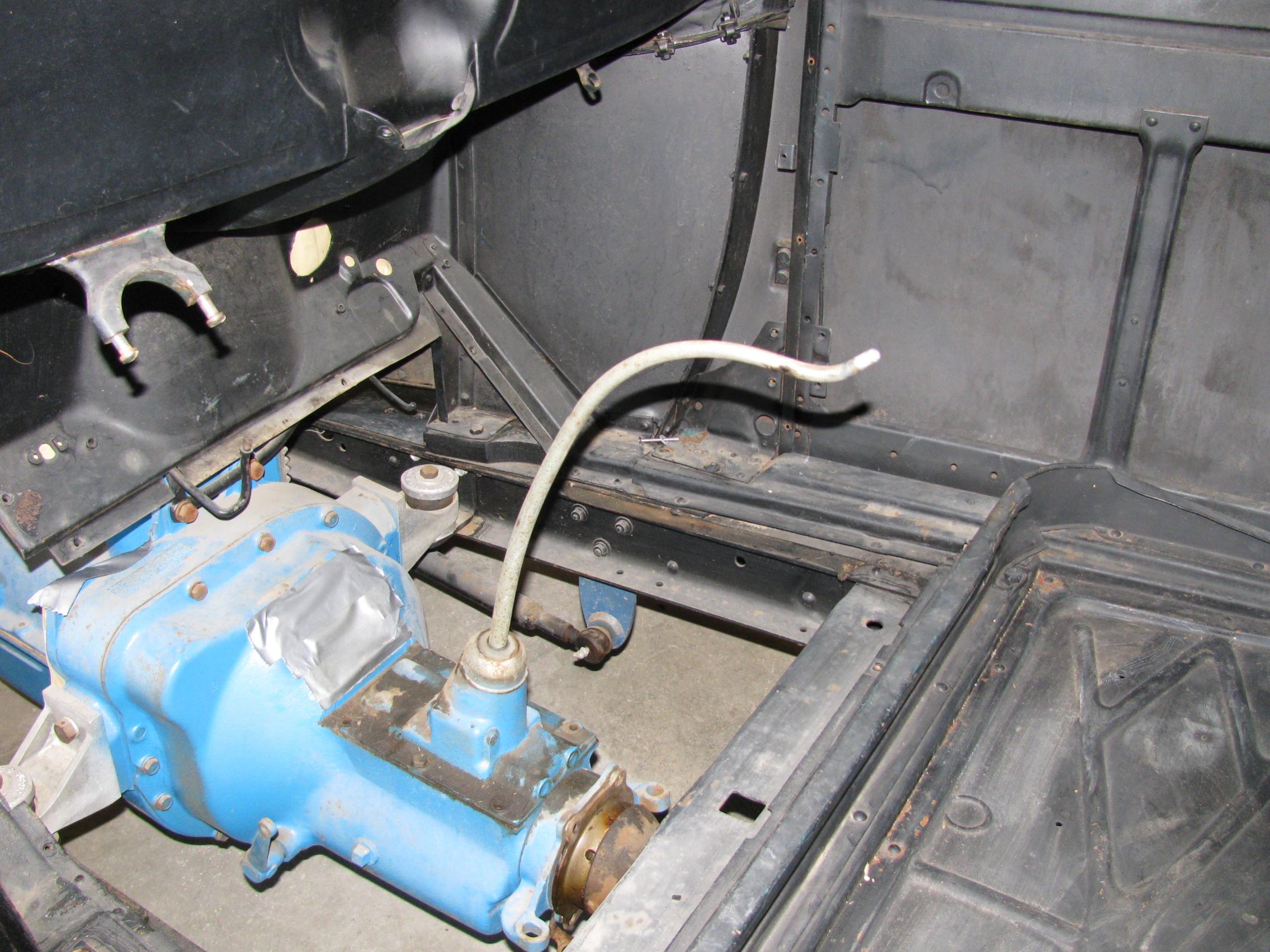

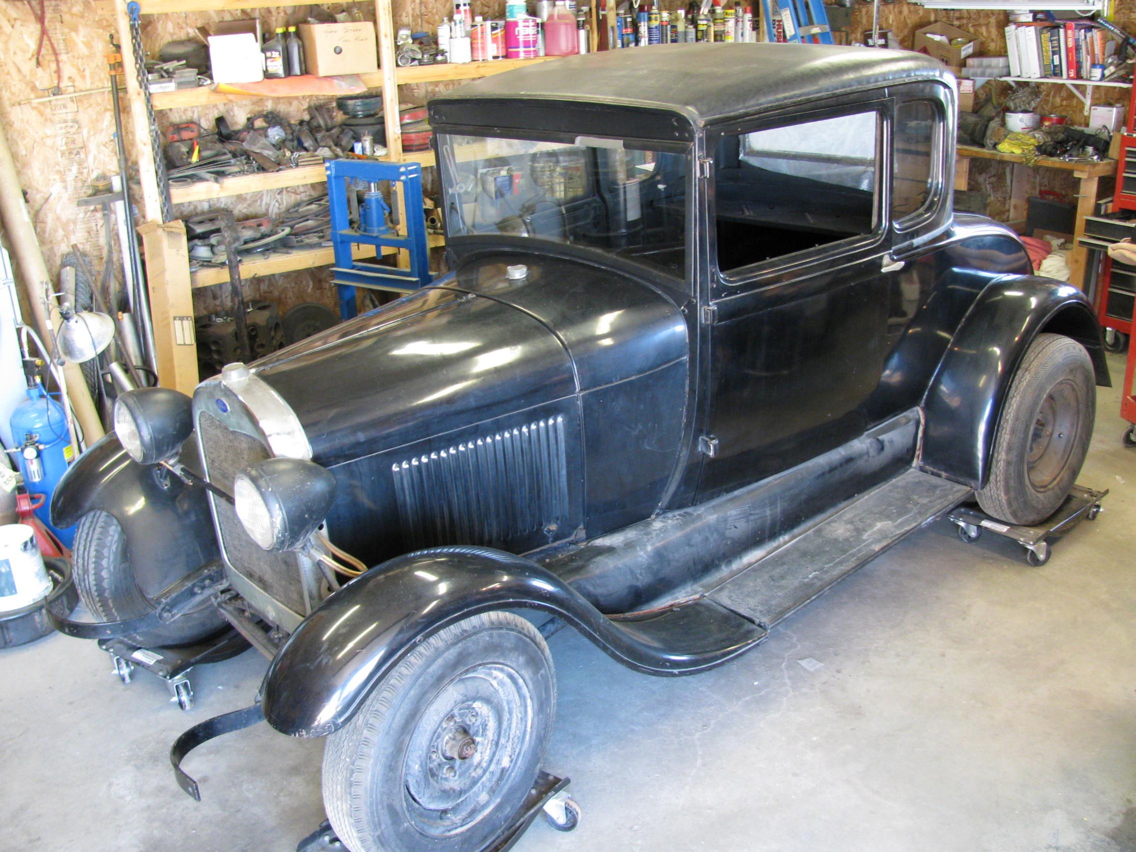

    Pictures of Model A with B engine

    What a find! Love that banger and the vintage goodies!

    That car looks like quite a find. My little brother would have it clean in no time with the drool he'd drop all over it.

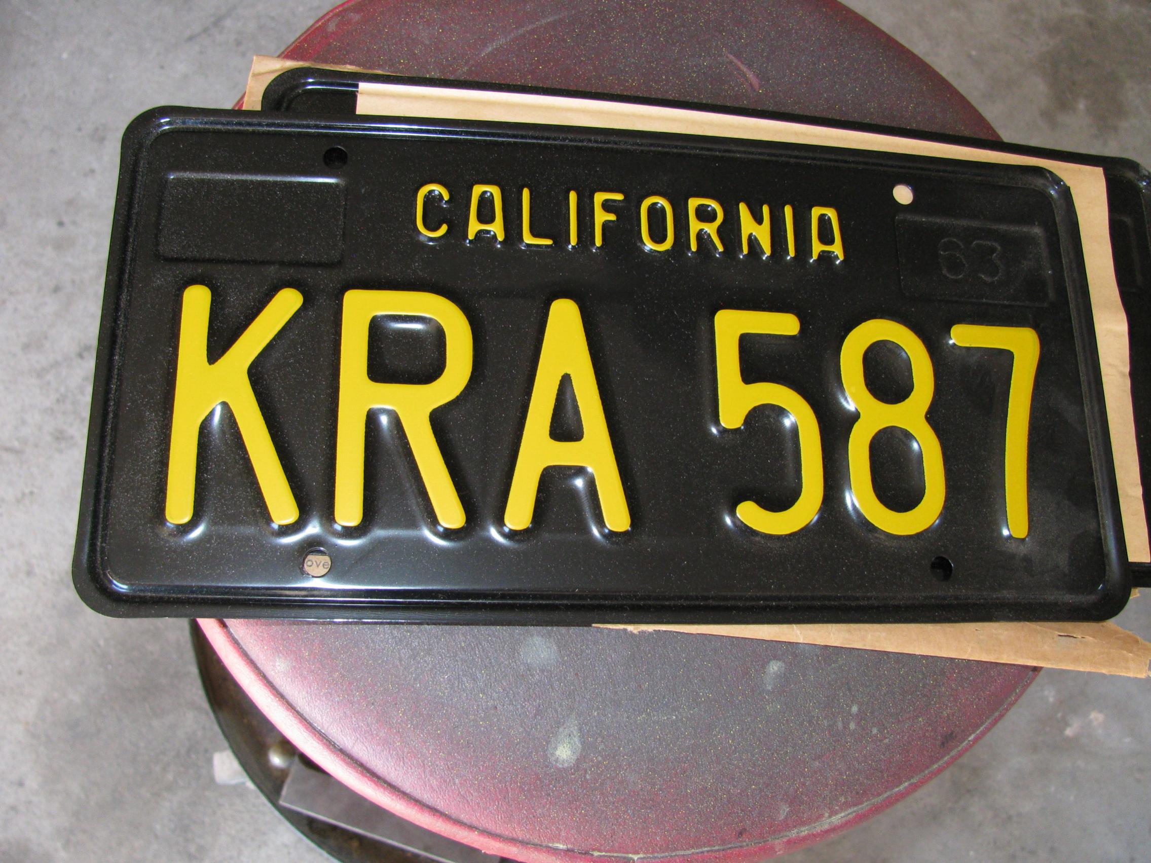

    ooh... looks like NOS 1963 California plates... do you have a ***le with that plate on it? even then you may not be able to run them if the car is out of the system. good trading material for 28-29 plates you could run on the car.
    looks ike a great car.
    EDIT: looks like you are not in California. sell those on ebay for big bucks.

    Wonder if Joe Gemsa built that motor? NICE FIND! It has a b transmission too, most peopke cut the back off a B pan and use the A trans. It would be a great ide to take it apart and inspect and re lube things. Bob

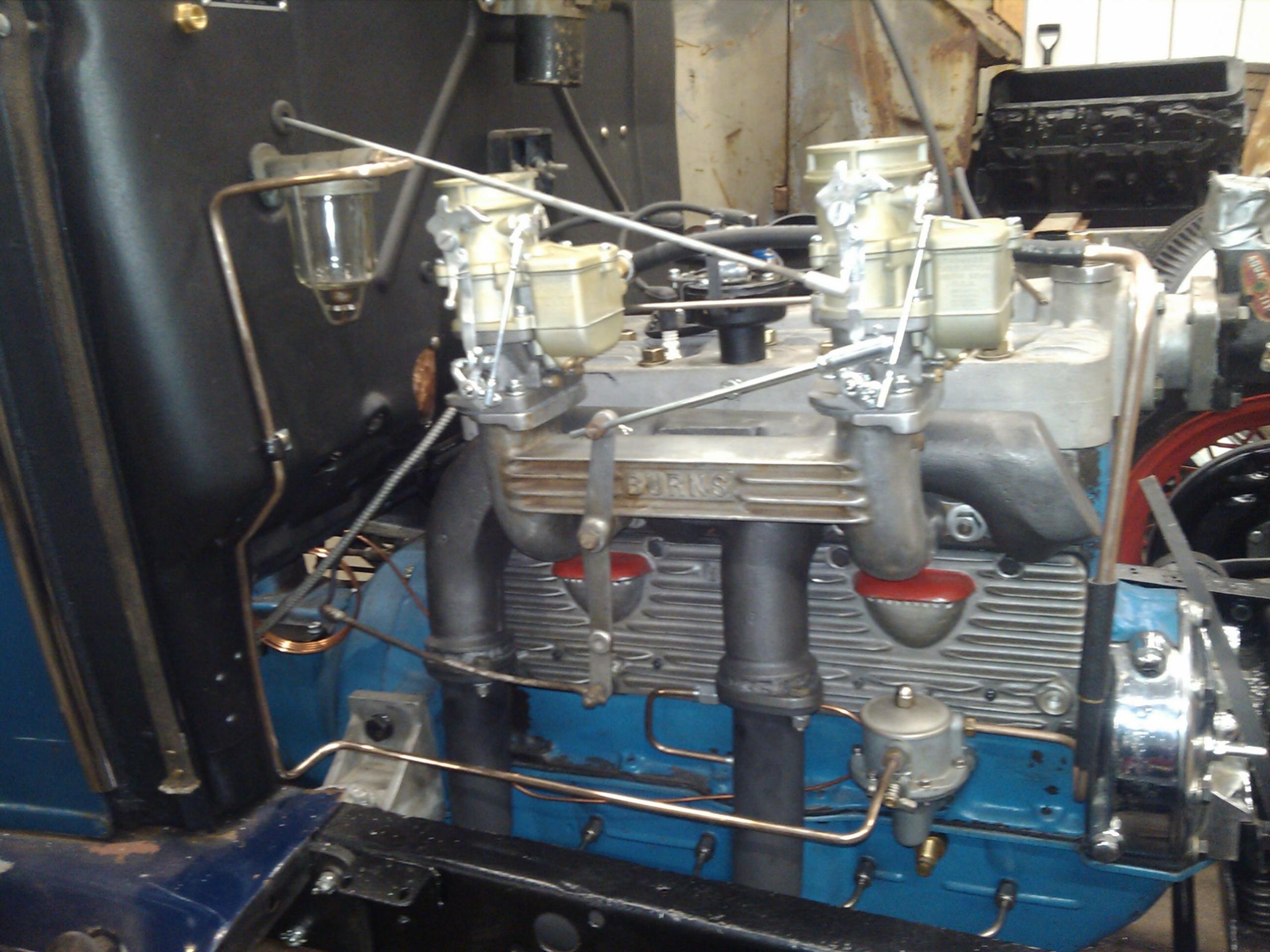

    Here's a update to this thread. I bought the engine from Larry about two years ago. It is FINALLY, running and driving after over 50 years! ResizedImage_1415904520817.jpg .
