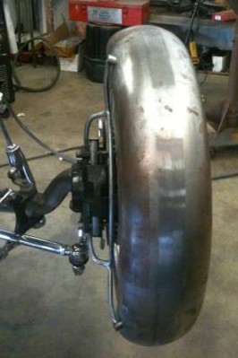

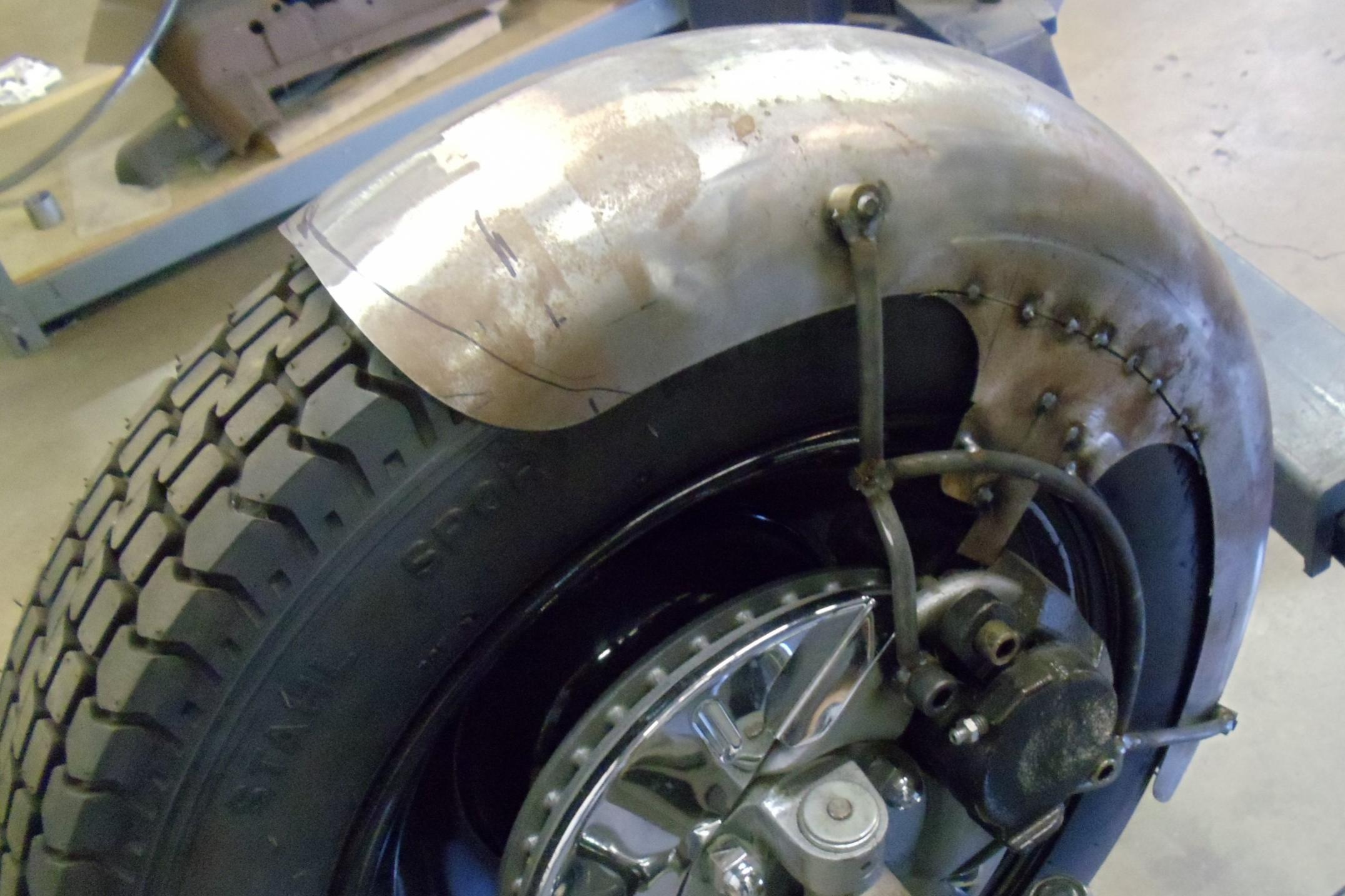

    The Montiac has done a great job designing this fender mounting system.
    Next the back.
    Then off to the chrome shop!

    They look pretty great, are they tube or solid stock? If they're tube, they'll crack and break over time, I had no luck at all using tubing, solid stock works best, nice job.
  10. 63dan63
    Joined: Jan 10, 2008
    Posts: 395
    63dan63
    solid stock. We had to think long and hard to design something that did not look like 10 pounds of structure holding a feather.
