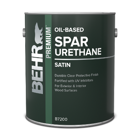

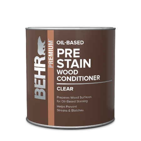

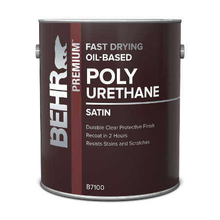

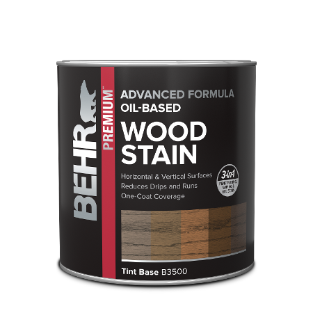

  16. 1Nimrod
    Joined: Dec 11, 2018
    Posts: 720
    1Nimrod
    behrdotcom_standard (3).png behrdotcom_standard (1).png behrdotcom_standard (2).png behrdotcom_standard.png
    We use Behr products on all our T1-11 outside Barns, they have a Paint Stain we use it was a 20 year 3 coat type, it's still working great on our three Barns today, it's been 24 year's.
    Behr has all kinds of excellent wood protection Paints and Stains for outdoor wood products, boats,wood furniture, home's, Barn wood siding, and much more, I use the clear stain sealer (below in pic, Green 1 gallon can) on our 12' X 16' Shed 12 year's ago, I live in the Snowbelt of Michigan and it's still like new.
    Check Behr Products out, no mixing if the store mixes it up for you, (unless it sets for a month or two then remix it again), you can apply it with a brush, roller,or spray it on, I like using a roller on the Barns and sheds, but a brush force's the liquid into the wood better, three coats or more if you want, let set and dry in between each coat, then the finally coat let it set until completely dry and your good for many many years of protected beautiful wood.
    Hope this helps as well...
    1Nimrod
    (Dustin) behrdotcom_standard (3).png behrdotcom_standard (1).png behrdotcom_standard (1).png behrdotcom_standard (2).png behrdotcom_standard.png

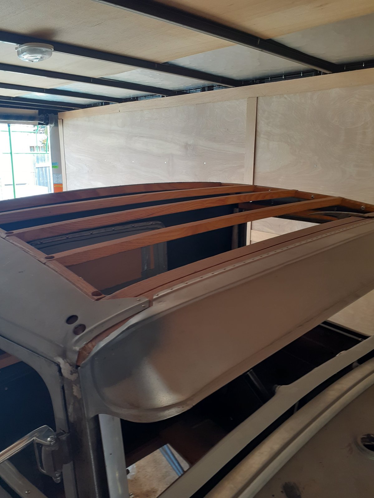

    This is what I use on a wooden gate in my yard, I reapply it once a year, that gate should easily out live me. I also used it on the top wood in my A, it's not exposted to the weather, but it still looks the same a couple years later as it did when freshly applied.
    Something I like about using the linseed oil/turpentine mixture vs spar varnish is when it needs to be applied there is no need to s****e and sand the wood the remove dried flaky varnish, just a quick brush with a steel brush to remove built up dirt and contaminants, a quick wipe down and brush the fresh oil/turpentine mixture on and let it dry. Good stuff.
