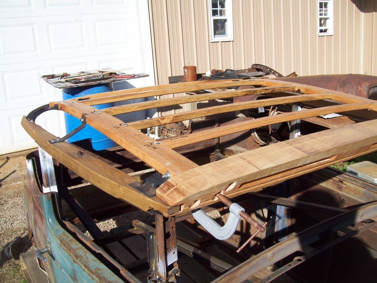

    I just did it. It seemed daunting when I had the entire roof off and thought I had ruined my truck. The ***embly was pretty easy, mine needed minor grinding in a few areas. The wood fit great! I got it from mikes a fordable. I don't have that many pics but would be happy to answer any questions you have. God bless flathead screws!
