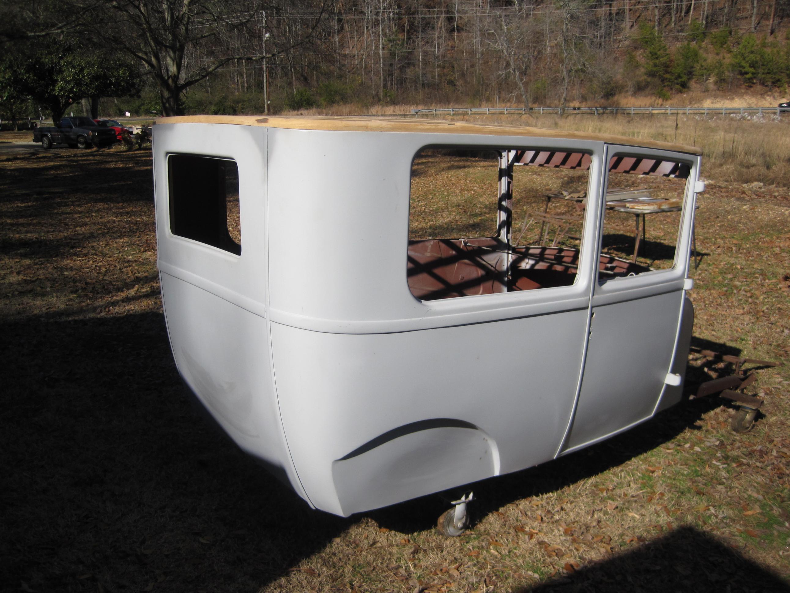

    Intersting build! Do it like you want! Just a thought, good friend (old time hot rodder) that has a thing for "square" roofed car started a build of a T sedan. He had the body work done and then the car has been in his shed for ten years. He is 80 this spring and realised he will not finish so it is for sale. The body is near perfect and just short of paint. Looks to be the perfect fit. I listed it in the cars for sale section (27 T-sedan) for him (he don't do computers, I have no dog in this hunt). Your body is near the un-salvagable stage, certainly many, many hours of fab work alone never mind making it straight for paint. Take a look.....will make a great fit for the after market frame and new flat head, more pics if it lights your fire.
