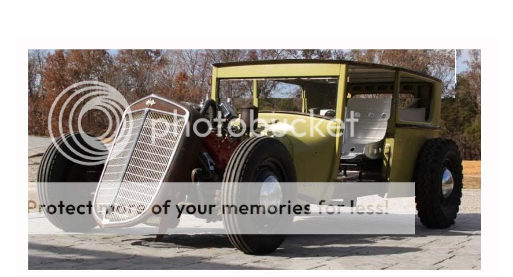

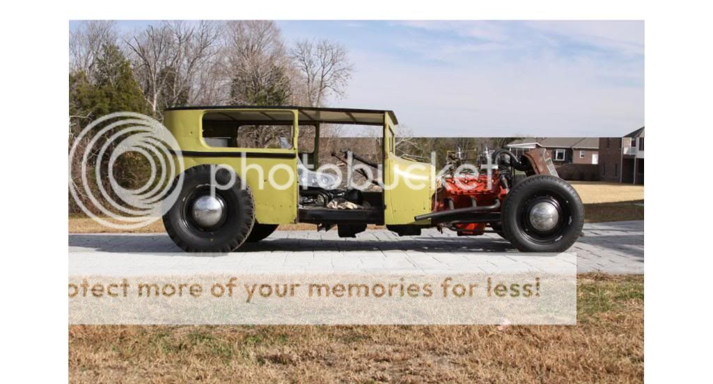

    I know those rear tires are ugly... I want them to match the front tires... I have no clue how to get the right size, as there are so many choices... Any input would be appreciated on that front. Also white walls or no??
    How much chop do y'all recommend?
    also what is a lakes car?
    Best,
    Whisky

  15. LANCE-SPEED
    Joined: Aug 10, 2006
    Posts: 2,259
    LANCE-SPEED
    ABOUT 2 FEET?
  16. Pensive Scribe
    Joined: Sep 29, 2010
    Posts: 1,098
    Pensive Scribe
    I was going to do a coupe 10 inches once. Any more and you gotta cut around back window, so you have a window left to see out of. Just don't park to close to a mail box. People might get confused and not know which one to put their letters in. You have to raise the panel behind the visor too. Or put a mirror on your dash so you can see green lights.

    okay, so here are some pre and post photochops... let me know what you think... too mild or not enough... save comments on grill for right now as I am probably going to section (only issue is size of damned radiator that needs to be covered)
    everyone free to comment except "Lance Speed" as I do not like negativity. Which is too bad as he appears to be a motorcycle guy and painter like me. When you get a chance Mr Speed please read the self actualization model, it will help you reach inner peace.

    Thanks for the info... Will definitely keep in mind... I'm thinking 4-6" maybe 8" at max, but will just have to go through the motions to see what I like...

  23. chaddilac
    Joined: Mar 21, 2006
    Posts: 14,093
    chaddilac
    REst of the car looks good, but that grill needs to go on a ihc pickup!! You shorter grill not raked out like that. Looks like a rat rod!
  24. Rpmrex
    Joined: Nov 19, 2007
    Posts: 664
    Rpmrex
    from Indiana
    With the cowl being so short, I think a T grill would be the best for proportions and flow. That flathead would look better/bigger with the shorter T grill also.
    I wouldn't chop very much. It might look squashed if you go to far.

    How much would you recommend sectioning the grill?

    This is the grill look I am going after...

    HAHA! I'm a car guy, I just race motor bikes. I currently do not have a car to fit the HAMB criteria but I do live the life! And if you knew anything about me I have build some ****! I hate to appologize to someone I dont know but I was not being negative I was TRYING to be funny, in other words chop the piss out of that thing, loose or cut down the grill, get some proper tires on it and your off to a great start.
    Heres the comment you didnt want! GOOD LUCK!
    PS. post your pics vertically, it easier to see!

    Oh yeah and i would un-channel it (raise the body) just my opinion, again.

    Very kool! Has a lot of potential if you can do it right. A nice clean hot rod. Please, get rid of the grille... Keep at it!

    Put down another vote for losing that grille. A simple rule of thumb, your rad/grille shell should never be taller than the cowl. Even if you do like the grille, I dont think there is much you can do in order to make it look right on that car. A model T, a 28/29 Model A or chopped 32 grille would look right at home on it.
