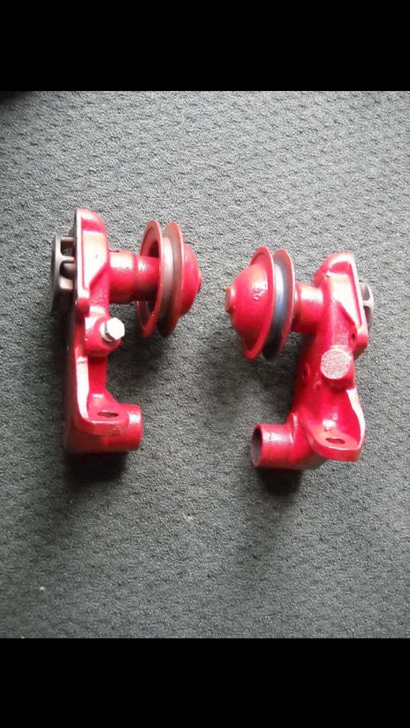

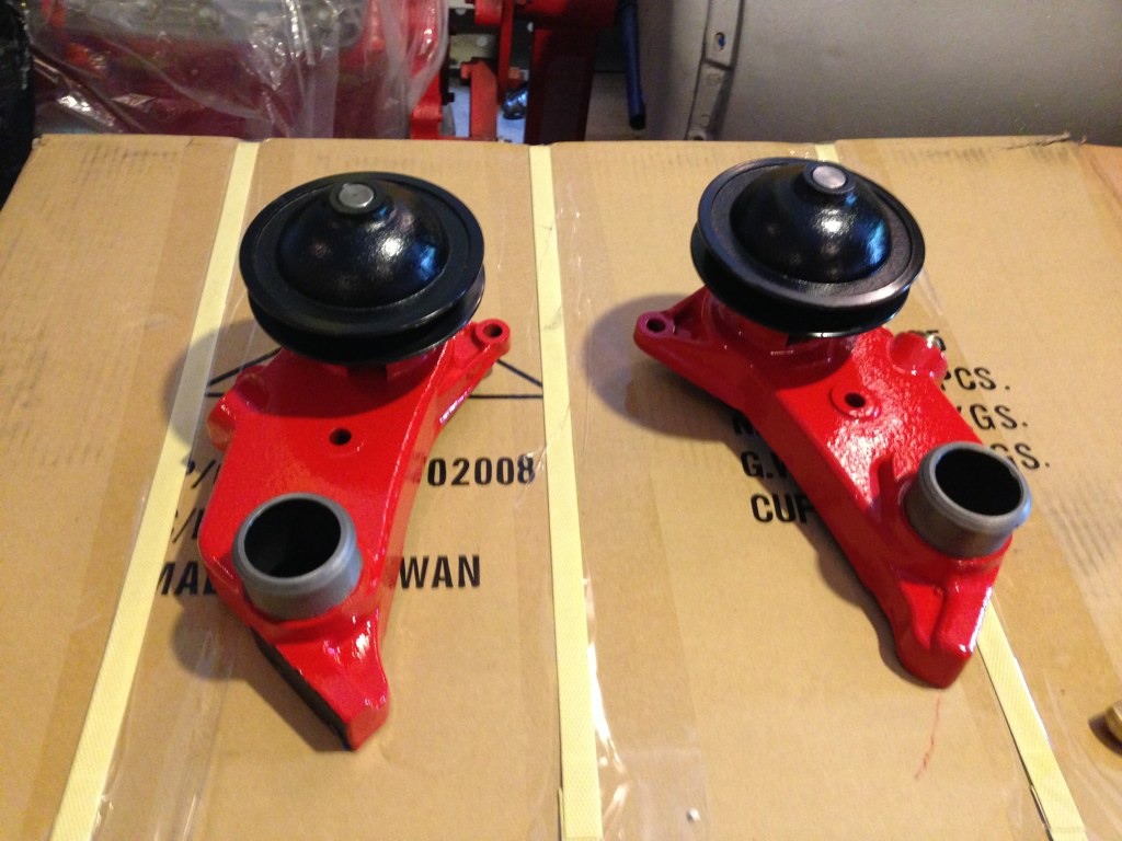

    Ordered water pumps... Yippee! They are red too... So one less thing to paint! ImageUploadedByTJJ1367074506.973252.jpg ImageUploadedByTJJ1367074518.717447.jpg ImageUploadedByTJJ1367074529.584534.jpg ImageUploadedByTJJ1367074539.334067.jpg
    This is the wide 5/8" single belt application for my 49-53 flattie. This is also an important step as the water pumps form part of the mounting for the front of the engine.

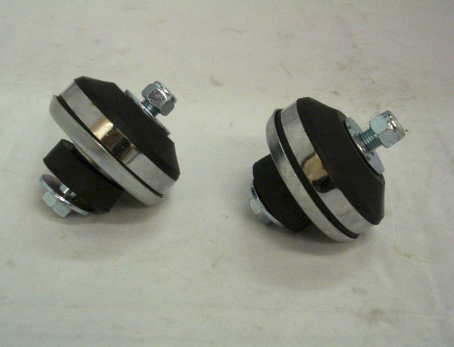

    Gotz ma engine biscuits too! Need some tea to go with my biscuits! ImageUploadedByTJJ1367075151.417185.jpg ImageUploadedByTJJ1367075159.667284.jpg ImageUploadedByTJJ1367075167.912347.jpg
    Quick question; what if any can I use in the rear mounting position? Is there specific biscuits for that area or can I use more of the same or none at all? Thanks to all for input!
  3. daddio211
    Joined: Aug 26, 2008
    Posts: 6,012
    daddio211
    On '49 and up, there weren't any rear engine mounts, just the two on the water pumps and one on the transmission crossmember.
    Glad to see you moving forward again!

    Thanks!! It appears the engine was attached to the frame on the rear by the PO. Are these mounting points not considered "engine mounts." So as I understand it the rear of the engine is rigidly mounted, with no biscuits?
  6. pennafxu
    Joined: Aug 20, 2010
    Posts: 2,263
    pennafxu
    from Kentucky
    Yes Siree!
  7. daddio211
    Posts: 6,012
    daddio211
    No rear engine mounts at all. Just the two water pumps and one trans. Considering what you started with I'm surprised there were ANY engine mounts!
    Sent from my DROID device using the TJJ mobile app

    Ok thanks Eric. Looks like PO mounted to frame. So if I place a X-member for transmission that would be my mounting point?
  9. daddio211
    Posts: 6,012
    daddio211
    Yep!

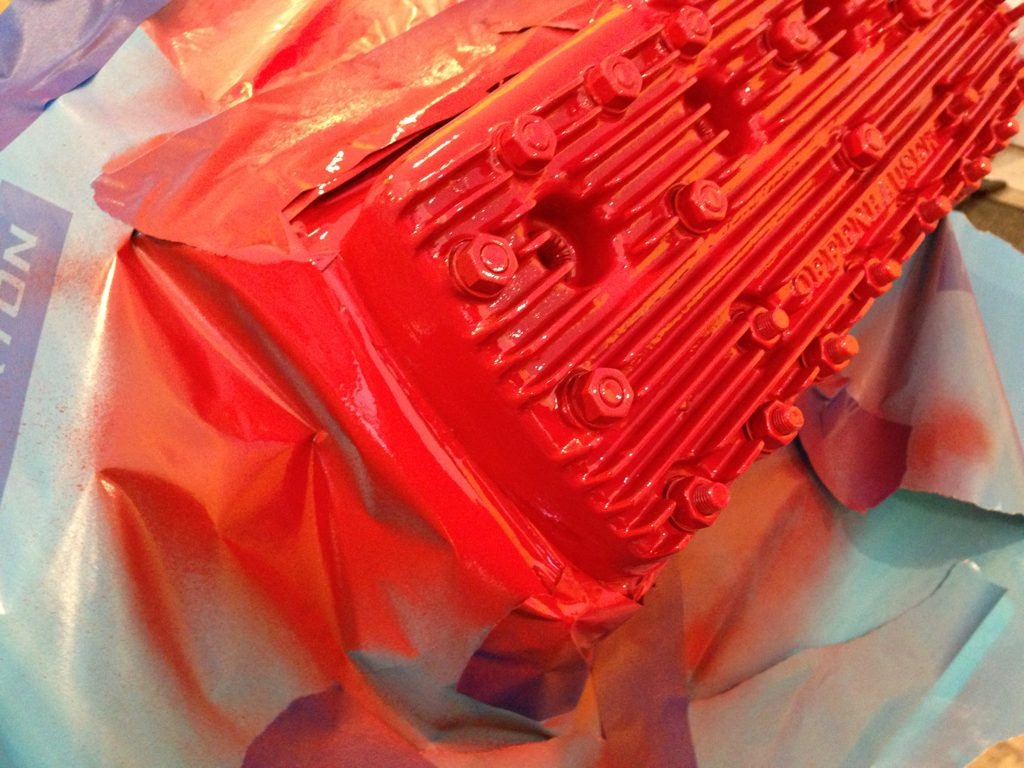

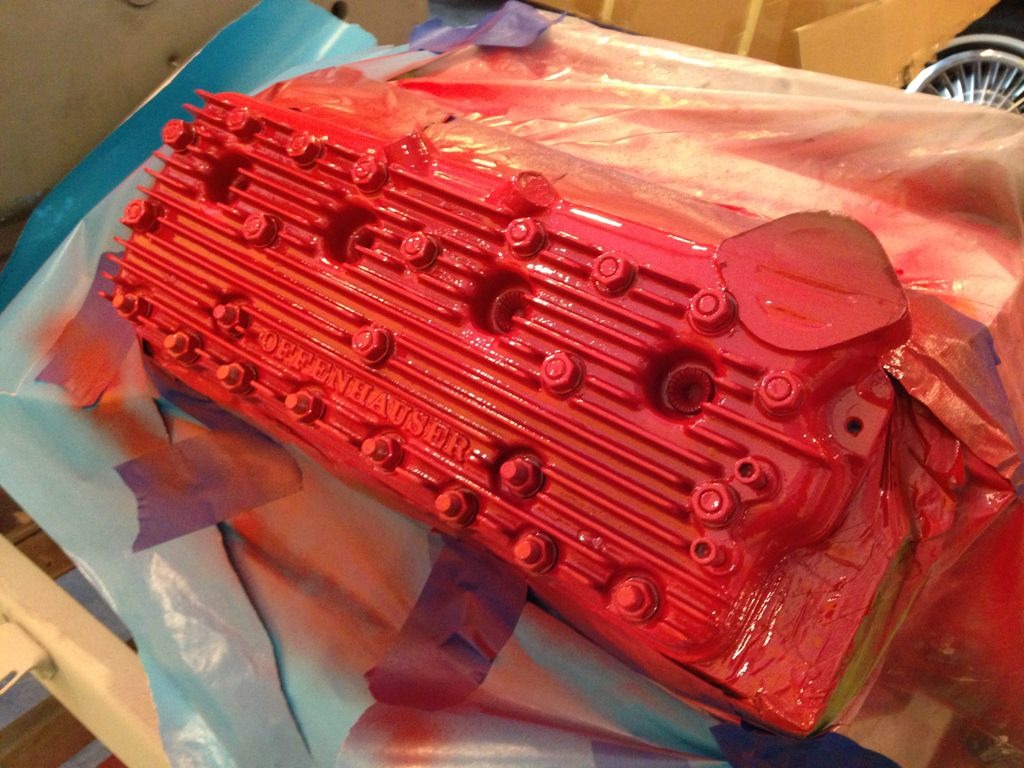

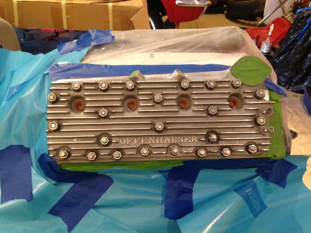

    Water pump/engine mounts all taped up... Using dupli-color engine enamel. Great product. Two light coats and one medium wet should get it done... ImageUploadedByTJJ1367781757.119877.jpg ImageUploadedByTJJ1367781793.936462.jpg ImageUploadedByTJJ1367781809.120025.jpg ImageUploadedByTJJ1367781821.320014.jpg ImageUploadedByTJJ1367781837.936506.jpg

    Tape removed and should be ready to mount in 3 hrs... Waiting for my SS hardware to come in to mount them... ImageUploadedByTJJ1367781979.219919.jpg ImageUploadedByTJJ1367781993.653222.jpg ImageUploadedByTJJ1367782021.820802.jpg ImageUploadedByTJJ1367782037.236516.jpg
    Seems like the way these pumps mount I won't need those damn biscuits... ****!

    Those pumps were designed to fit on a C channel type of rubberized isolater. I can post pics later if you'd like.

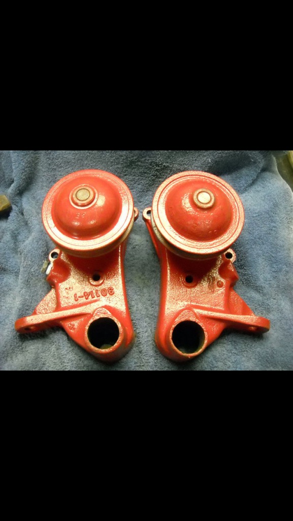

    These look like them... I ***ume they can be welded? after I drill through the frame?

    Yes, that's them. Sorry, been busy as hell lately!
    I wouldn't weld them. The studs on the bottom were designed to bolt through the cross member. Welding will likely melt the rubber mount, or at least cause separation from the steel portion causing early failure.

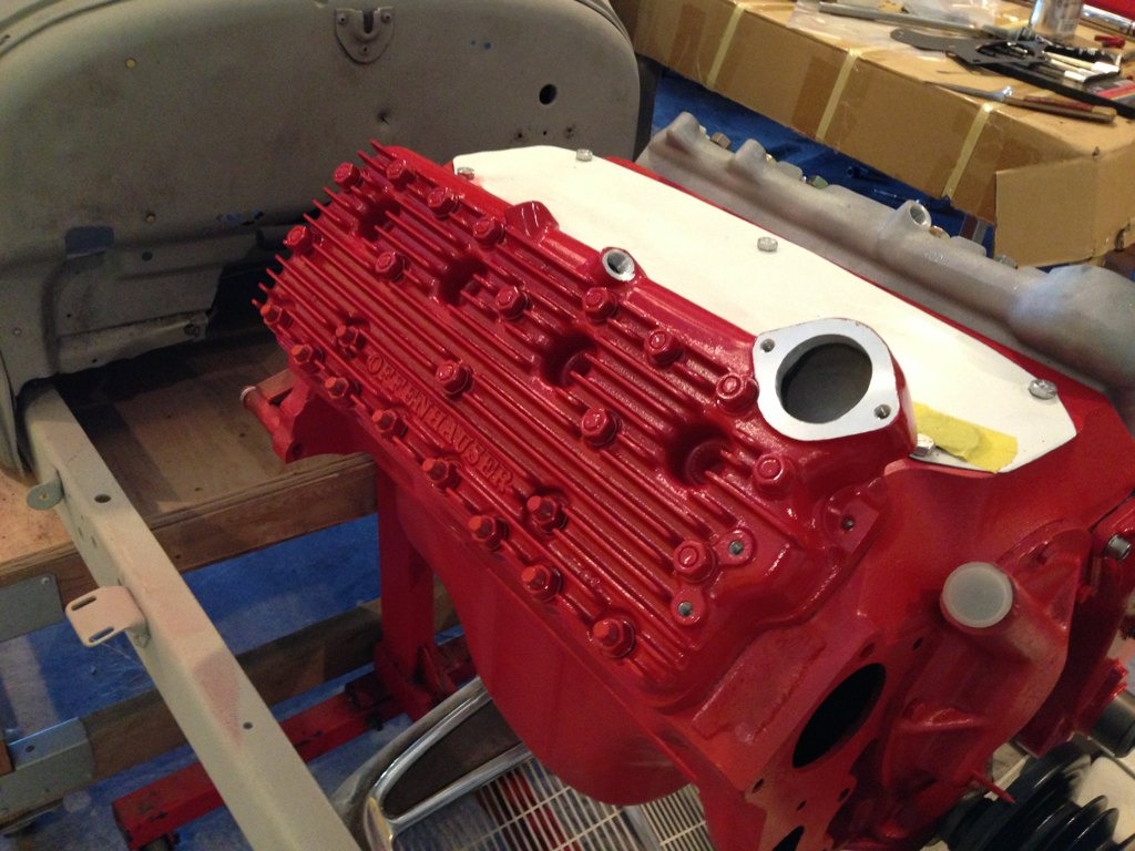

    Well some more progress with purdying up the flathead... ImageUploadedByTJJ1367949787.680670.jpg ImageUploadedByTJJ1367949807.330773.jpg

    Taped off and sprayed...
    ImageUploadedByTJJ1367949844.030005.jpg ImageUploadedByTJJ1367949865.246522.jpg ImageUploadedByTJJ1367949884.396681.jpg ImageUploadedByTJJ1367949898.780538.jpg ImageUploadedByTJJ1367949915.046735.jpg

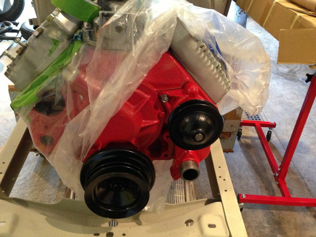

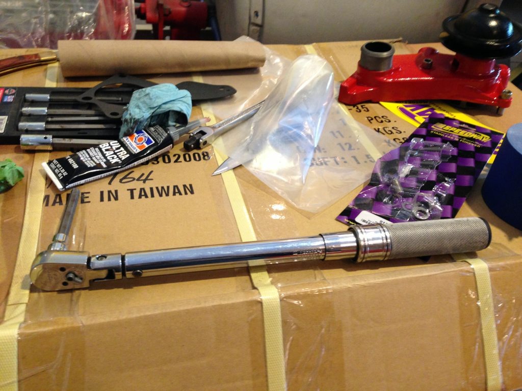

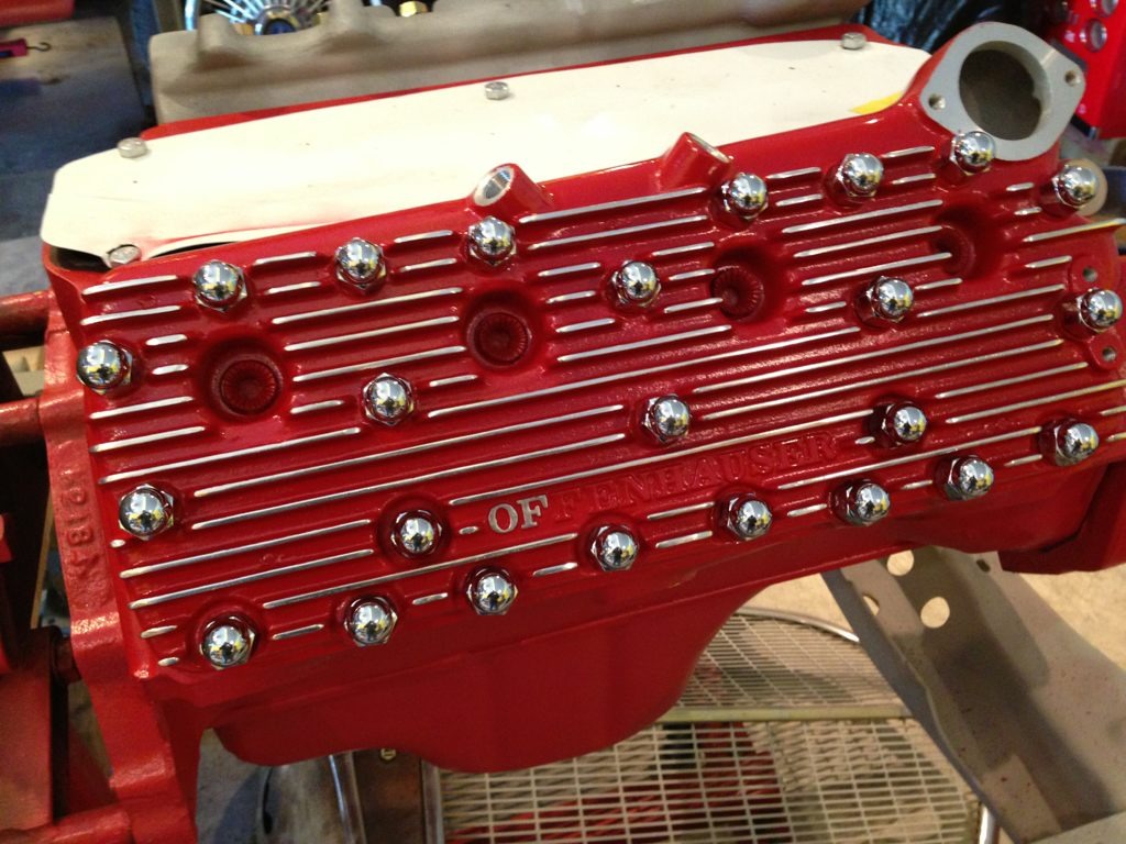

    Also attached the driver side pump... Used copper gasket sealer, blue permatex and torqued down to 30 ft-lbs per the instructions. ImageUploadedByTJJ1367950039.580104.jpg ImageUploadedByTJJ1367950109.479925.jpg ImageUploadedByTJJ1367950123.797302.jpg ImageUploadedByTJJ1367950135.713707.jpg

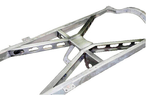

    Not the greatest picture, but this is the front cross member of my shoebox. (Very bottom of pic.) It's an engine cradle, of sorts, and ties all of the front suspension together too.
    I don't think you'll need anything quite as rigid, but take an angle measurement of the mounting surfaces and create something custom.
    OR... build two small brackets, one from each water pump, and mount those biscuit style. I'm not certain that's a great idea given the torque of the engine... someone with an engineering background will hopefully chime in.

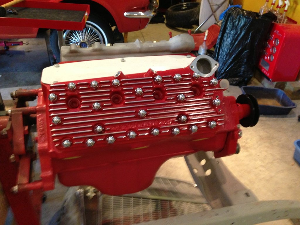

    On to cleaning the paint off the top of the fins and putting the bolt covers on...
    ImageUploadedByTJJ1368038648.333938.jpg ImageUploadedByTJJ1368038659.767886.jpg ImageUploadedByTJJ1368038676.316974.jpg

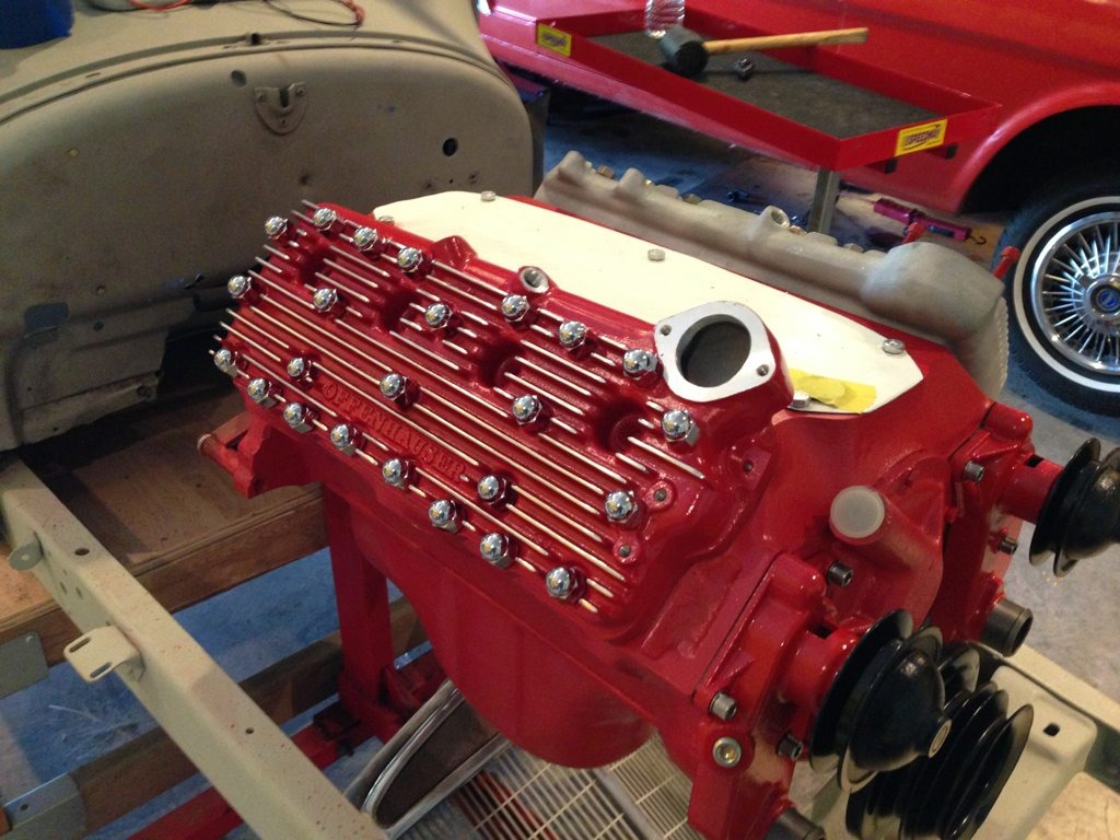

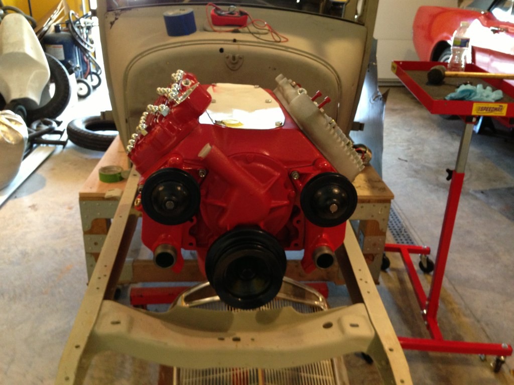

    Both pumps attached... Wish I had gone with the single mounting style as I will need to fab up a custom cradle mount... Oh well, live and learn. ImageUploadedByTJJ1368038932.399854.jpg
