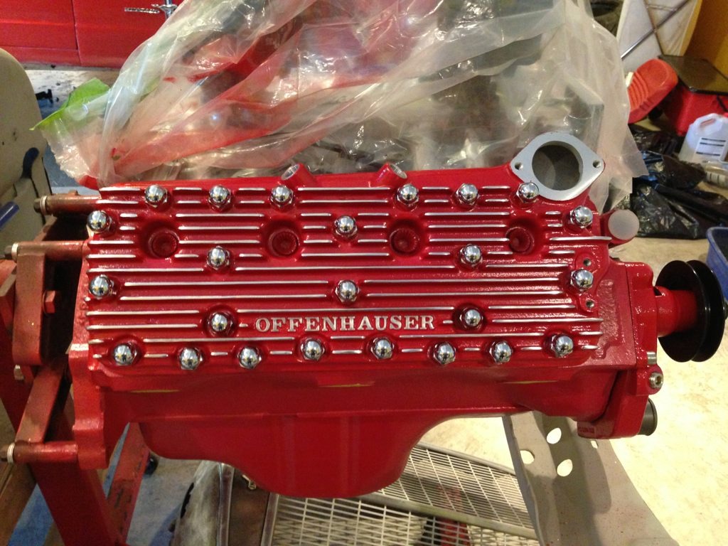

    Got some letters etched out...

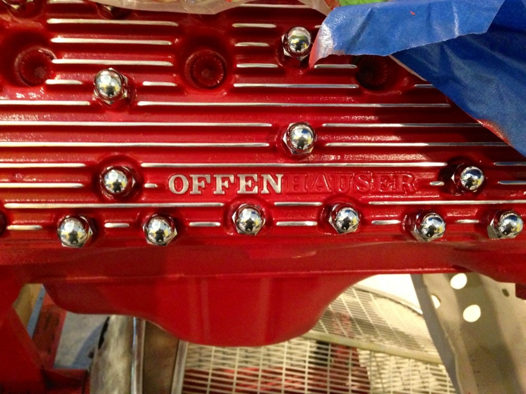

  5. pennafxu
    Joined: Aug 20, 2010
    Posts: 2,263
    pennafxu
    from Kentucky
    Finished etching the letters on the block... On to the next side. :)

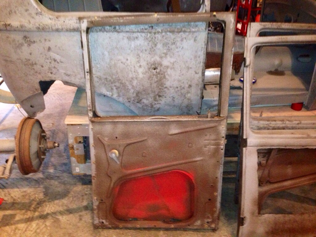

  10. Nocero
    Joined: May 16, 2002
    Posts: 489
    Nocero
    Motor looks good, but wtf at you doing to those doors?!
  11. pennafxu
    Posts: 2,263
    pennafxu
    from Kentucky
    Did you see those doors? I removed the tacked on "skins" so they can be blasted on the inside properly. They will need new lock mechanisms, re-skinning, bear claws, suicide treatment and reconstruction. The belt lines are rusted out too. Thats WTF I am doing to them!
  12. Nocero
    Posts: 489
    Nocero
    I can understand that dude but put the plasma cutter away. Get a 4 1/2 angle grinder with a cutoff wheel and take your time measure and plan your cuts. It will help you get it back together easier and get the door gaps lined up easier.
    Suiting up and whacking away with the plasma is fun , but you can make yourself a lot more work in a hurry.
    Also may e a little late but do some searches on mol***es rust removal.
  13. pennafxu
    Posts: 2,263
    pennafxu
    from Kentucky
    Once again I stand corrected! Damn you man! I didn't even think of the mol***es stuff... I guess I must be a glutton for punishment... It seemed that the PO used s**** metal for one of the skins, so I didn't feel so bad cutting it off but that other one gave me a sick feeling when I was doing it. (It was jolly good fun though!). Be that as it may, i cut them with surgical precision by keeping the input at 7-10 so it was a more precise version of an angle grinder. IMHO these areas were so rusted and pitted out that they needed to be replaced. Anyways, thanks for the input, and again it's HAMB'rs like you who have taught me along the way to help me and make me more knowledgable about hotrods, and I appreciate that.

  14. pennafxu
    Posts: 2,263
    pennafxu
    from Kentucky
    Got the doors blasted! Pics to follow...
