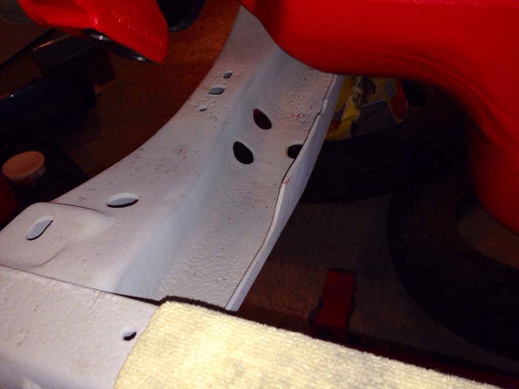

    ImageUploadedByH.A.M.B.1382989047.877378.jpg question on this area... Would you strengthen or chop this down/strengthen?

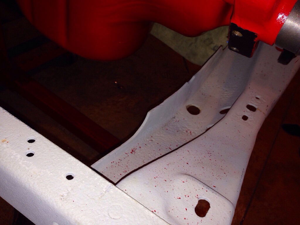

  9. pennafxu

  10. daddio211
    Joined: Aug 26, 2008
    Posts: 6,012
    daddio211
    I think it's plenty strong enough the way it is, however I WOULD weld around surfaces where the cross member ties into the rails. Doors are looking promising! ;)
  11. pennafxu

  12. daddio211
    Posts: 6,012
    daddio211
    Personally, I wouldn't. There's nothing wrong with adding material to strengthen the C channel, but it's a flathead, not a blown SBC. It's just my opinion, but I would leave the frame unboxed. As far as "cleaning" I wouldn't. I like seeing the raw edges of the stamped steel that came out of the machines the way the factory made them. Maybe it's just me, but I really DIG the industrial "as Henry intended" look to raw parts. The most I'd do is hand file any rough edges so help with paint adhesion.
  13. Pensive Scribe
    Joined: Sep 29, 2010
    Posts: 1,098
    Pensive Scribe
    Ah, some movement. I'm ditto with Daddio.
  14. pennafxu
    Joined: Aug 20, 2010
    Posts: 2,263
    pennafxu
    from Kentucky
    So u wouldn't box any of it then? Not even with one of those kits for the inner portion of the frame?

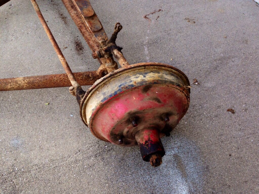

  17. pennafxu
    Posts: 2,263
    pennafxu
    from Kentucky
    ImageUploadedByH.A.M.B.1383008204.086318.jpg probably will leave this intact, and follow a tech link by Sam-I-am... Or should I split it? Decisions, decisions...

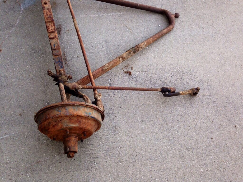

  18. pennafxu
    Posts: 2,263
    pennafxu
    from Kentucky
    ImageUploadedByH.A.M.B.1383008299.168515.jpg I ***ume these are mechanical brakes... I need to rebuild, so was going to switch to juice brakes... Any ideas? I'd like to use finned drums/Lincoln style but what all does it entail? CTK your input is welcomed!

    ImageUploadedByH.A.M.B.1383008549.337377.jpg I want to drop the axle, or is this ok and use a rubber rake?
  21. I have only come across your build this past week and it is great to see where you are now. The Tudor was a total POS at the start and because of your willingness to listen and learn is well on its way to being a *****in Hot Rod.
    Dropping the A axle would be the way to go and will help with the overall rake of the car, last thing you want is to have tyre rake with the nose up and tail down looking like a dog dragging his ****.
    Also your best bet is to run hydraulic brakes '39 and later. Find yourself a pair of '37-41 round back spindles or later '42-'48 spindles. That way brake backing plates don't need modifying.
