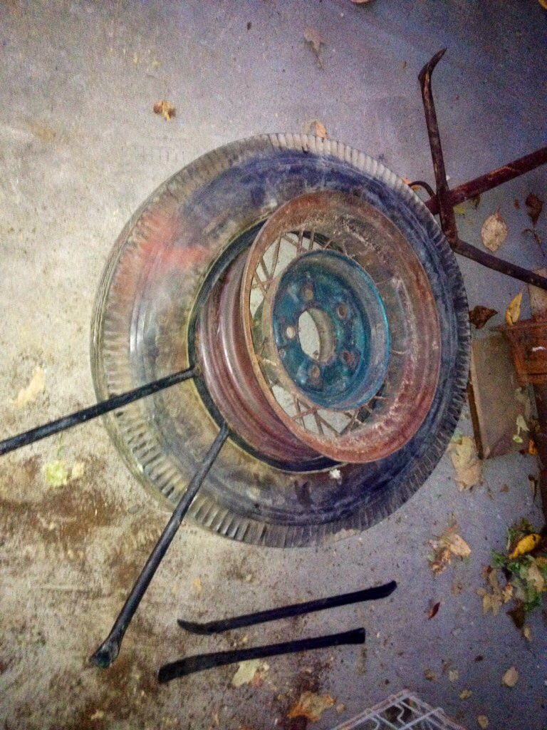

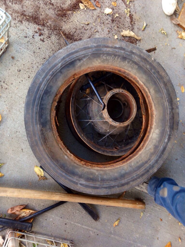

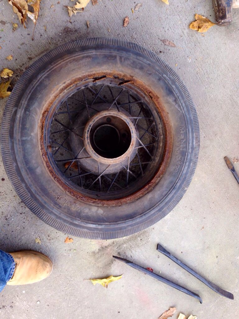

    ImageUploadedByH.A.M.B.1383352649.347073.jpg ImageUploadedByH.A.M.B.1383352676.531444.jpg ImageUploadedByH.A.M.B.1383352697.536552.jpg
    Getting ready to remove tire...

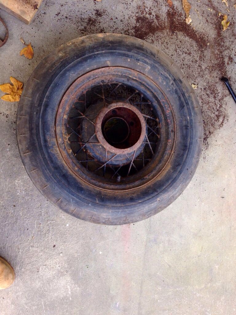

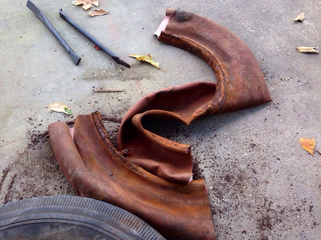

    ImageUploadedByH.A.M.B.1383352761.730140.jpg ImageUploadedByH.A.M.B.1383352776.769015.jpg
    Old school bebe

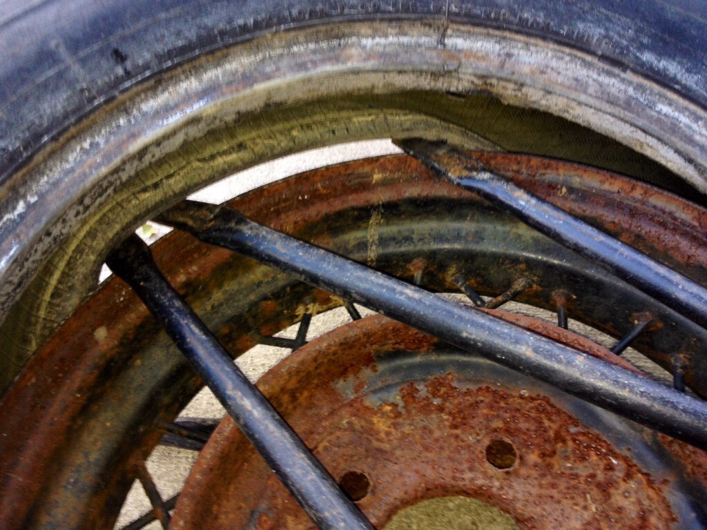

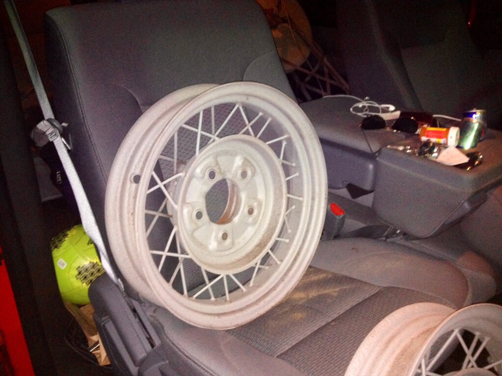

    ImageUploadedByH.A.M.B.1383353038.131290.jpg ImageUploadedByH.A.M.B.1383353048.099736.jpg ImageUploadedByH.A.M.B.1383353057.632295.jpg ImageUploadedByH.A.M.B.1383353067.481213.jpg ImageUploadedByH.A.M.B.1383353086.132023.jpg
    One side done!

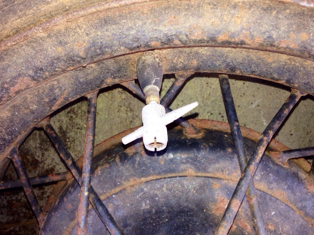

    ImageUploadedByH.A.M.B.1383353188.402887.jpg ImageUploadedByH.A.M.B.1383353198.202796.jpg ImageUploadedByH.A.M.B.1383353206.937530.jpg ImageUploadedByH.A.M.B.1383353216.586423.jpg
    That looks like an old piece of colon... Lol

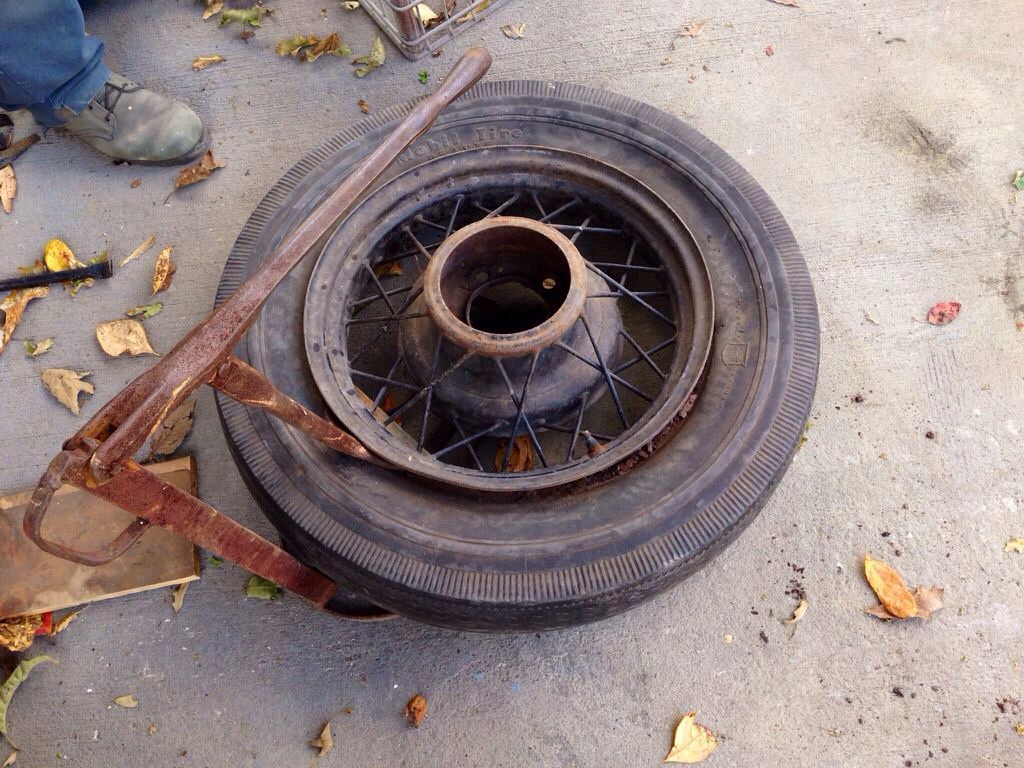

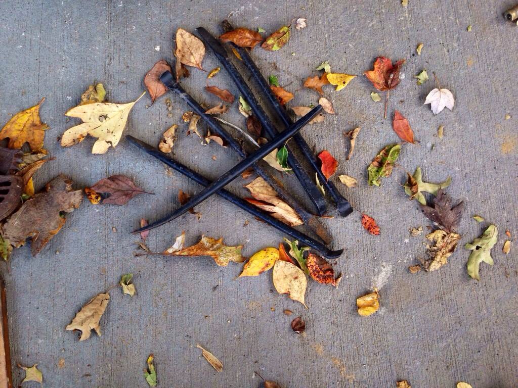

    ImageUploadedByH.A.M.B.1383353328.493199.jpg ImageUploadedByH.A.M.B.1383353345.658118.jpg ImageUploadedByH.A.M.B.1383353356.009885.jpg
    No rest for the wicked! Quickly onto the next one...

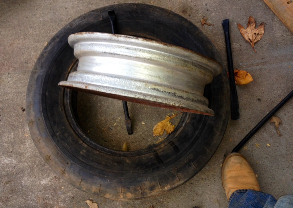

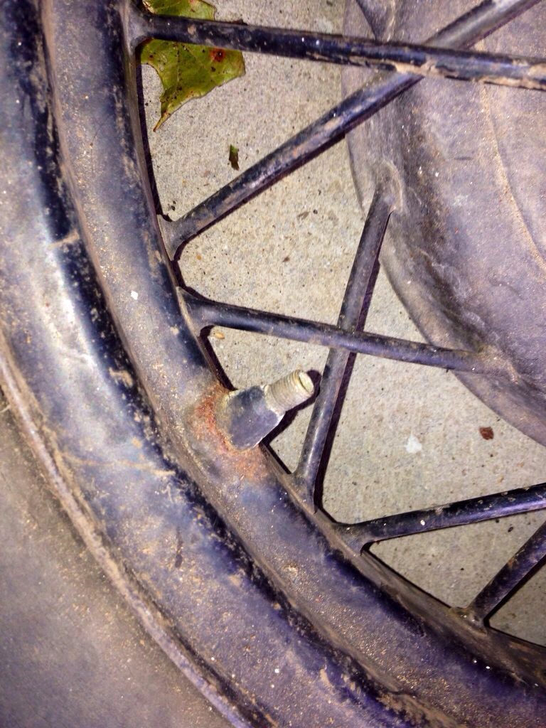

    ImageUploadedByH.A.M.B.1383354428.408618.jpg ImageUploadedByH.A.M.B.1383354451.576758.jpg ImageUploadedByH.A.M.B.1383354468.363795.jpg ImageUploadedByH.A.M.B.1383354482.989632.jpg
  8. pennafxu
    Joined: Aug 20, 2010
    Posts: 2,263
    pennafxu
    from Kentucky
    This one just looked hard! Used bfh to get bead to break!
    These pieces really stiffened up the side wall

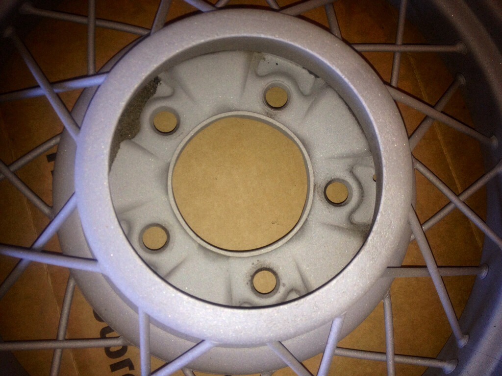

    Will need some hammer and dolly work to bring back. ImageUploadedByH.A.M.B.1383495327.086076.jpg
    Close to no pitting...

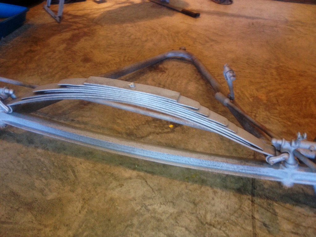

    That spring pack looks off...

    That spring pack is Very Bad
    Someone put it together using wrong leaves. Time to start over, you probably should start with another pack
    When you get all good leaves, grind out the wear on the top of each leaf, then grind the bottom sides of the tips to provide a bevel so they wont dig in next time. Some folks like plastic inserts between leaves.
