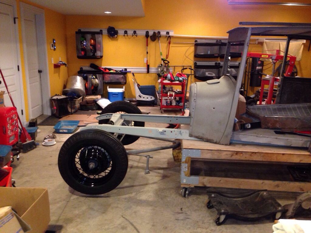

    Got front tires mounted! At Harley dealer!! ImageUploadedByH.A.M.B.1389023720.483820.jpg

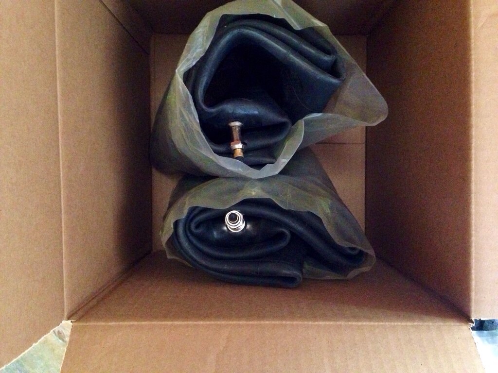

    Ordered the inner tube from speedway... For the front and will order tires and tubes for rear from coker!

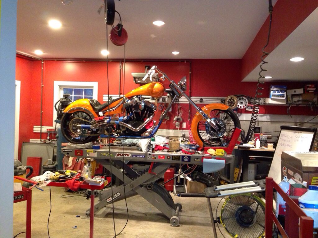

    Ps this is the chopper that has held up progress! But not for long... Back to the rusty chum bucket, yippee!!

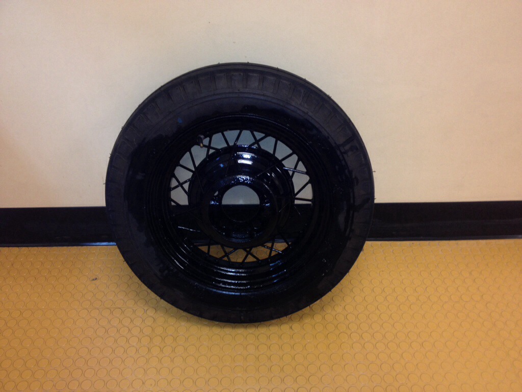

    ImageUploadedByH.A.M.B.1389213989.904548.jpg ImageUploadedByH.A.M.B.1389213998.538588.jpg ImageUploadedByH.A.M.B.1389214008.024926.jpg ImageUploadedByH.A.M.B.1389214016.874938.jpg
    Okay I ordered this stuff yesterday and it came in today! That's what I call service! Got the br*** offset valve stems too...

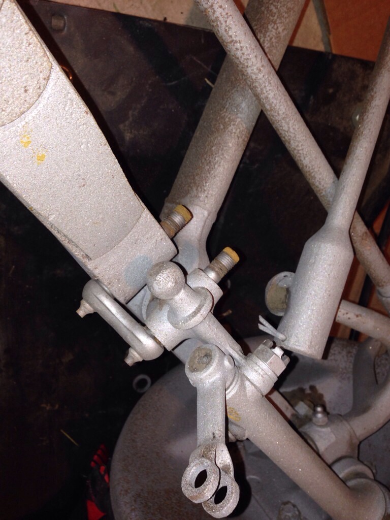

    ImageUploadedByH.A.M.B.1389482647.745773.jpg ImageUploadedByH.A.M.B.1389482676.496369.jpg ImageUploadedByH.A.M.B.1389482698.562998.jpg ImageUploadedByH.A.M.B.1389482733.280283.jpg

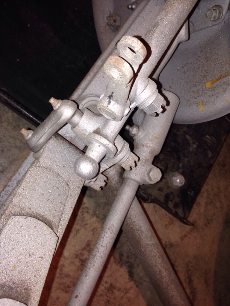

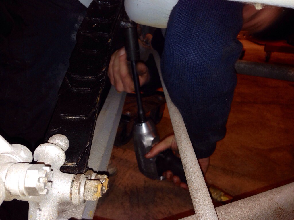

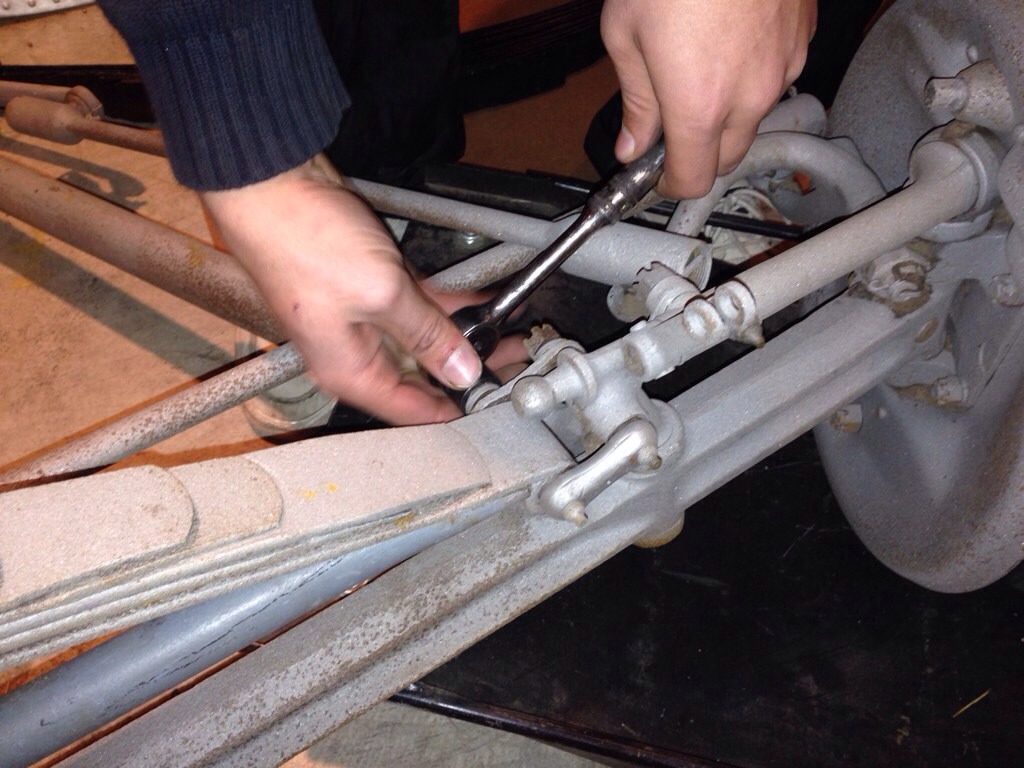

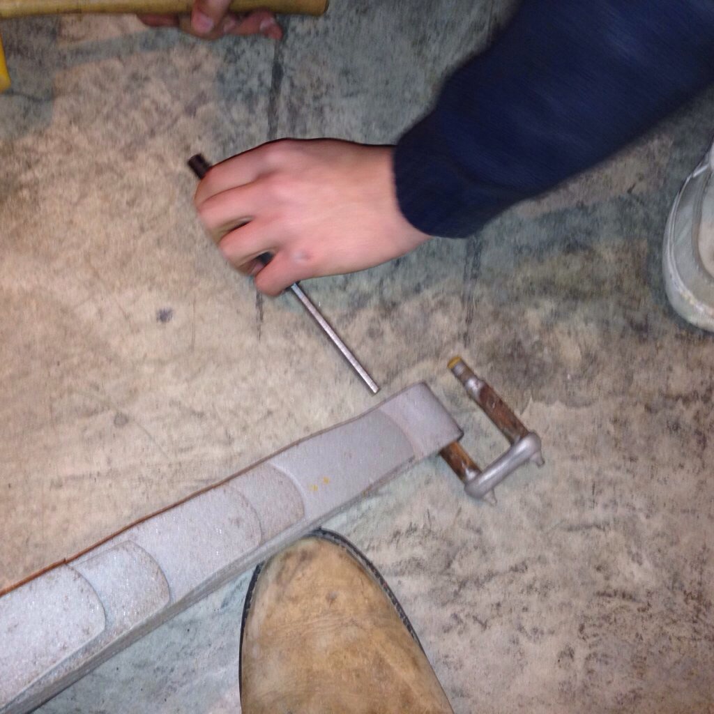

    Removing castle bolts... For old spring pack...

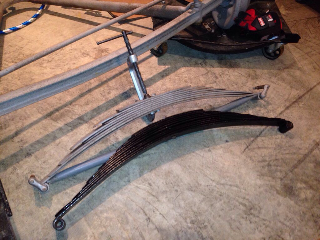

    ImageUploadedByH.A.M.B.1389482910.164777.jpg ImageUploadedByH.A.M.B.1389482924.954418.jpg ImageUploadedByH.A.M.B.1389482949.498086.jpg

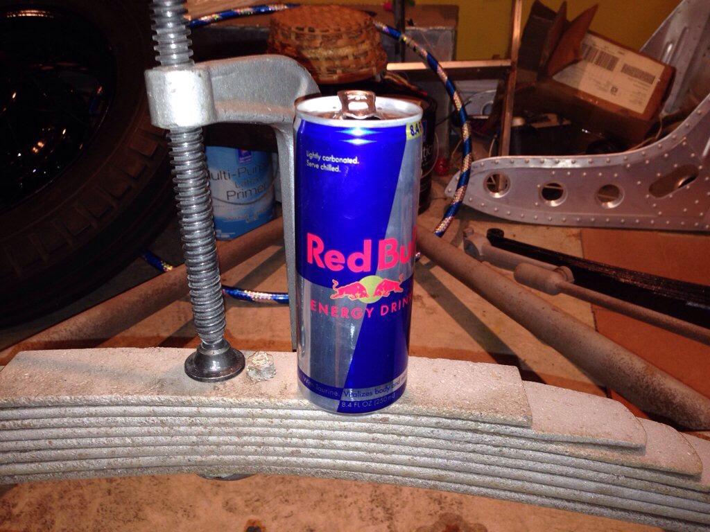

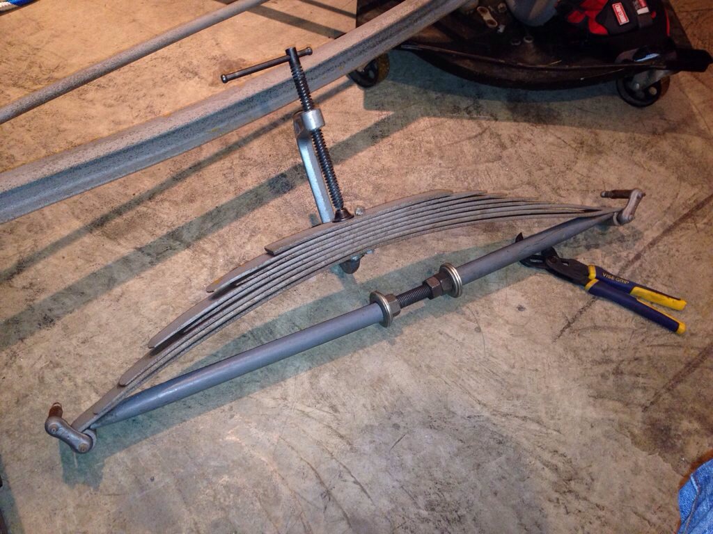

    Spring pack expander in place... ImageUploadedByH.A.M.B.1389482989.631129.jpg ImageUploadedByH.A.M.B.1389483005.715083.jpg
  17. pennafxu
    Joined: Aug 20, 2010
    Posts: 2,263
    pennafxu
    from Kentucky
    ImageUploadedByH.A.M.B.1389483105.529985.jpg ImageUploadedByH.A.M.B.1389483126.014674.jpg

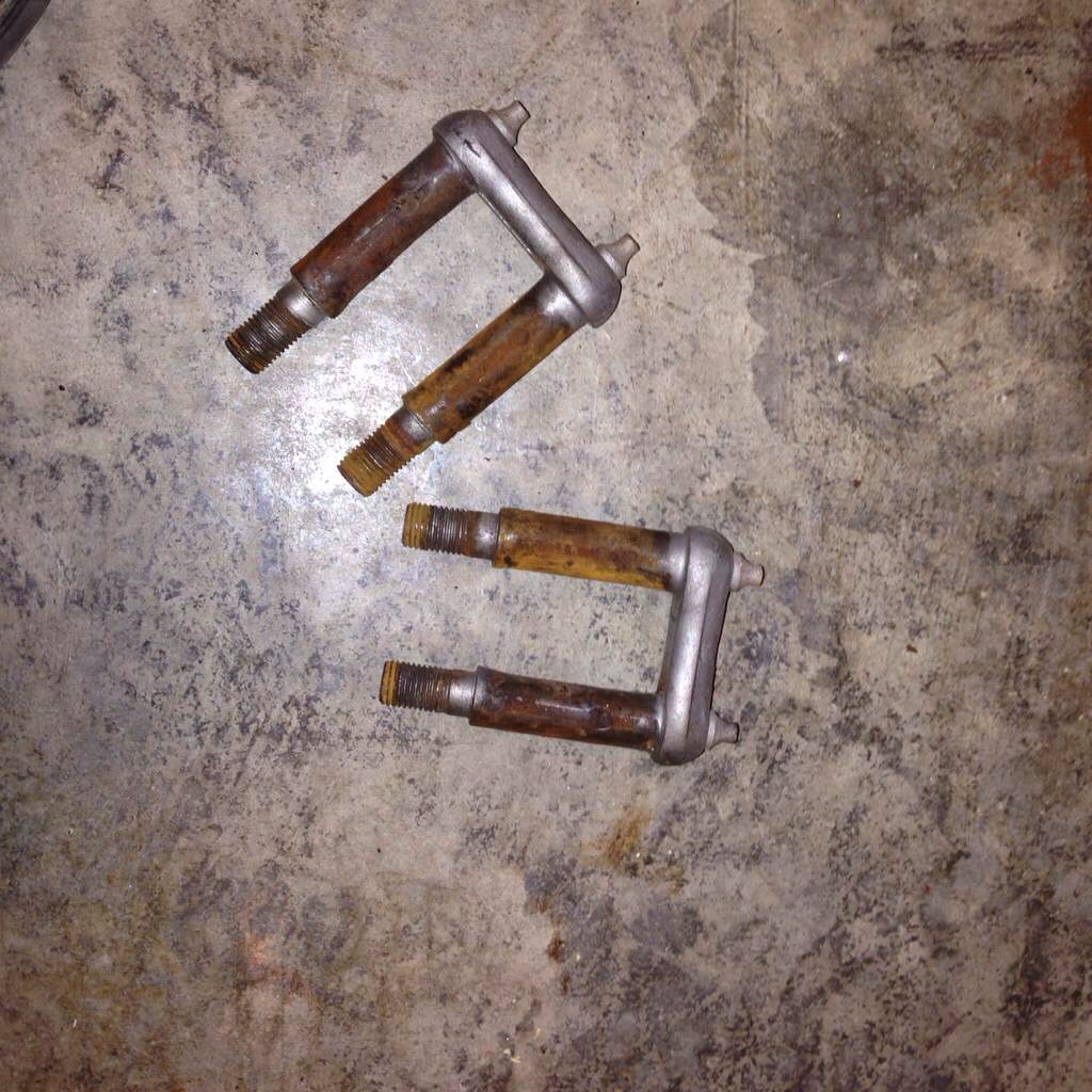

    Comparing old with "new" ImageUploadedByH.A.M.B.1389483181.864334.jpg ImageUploadedByH.A.M.B.1389483206.714645.jpg
    Removed pin thingy's...

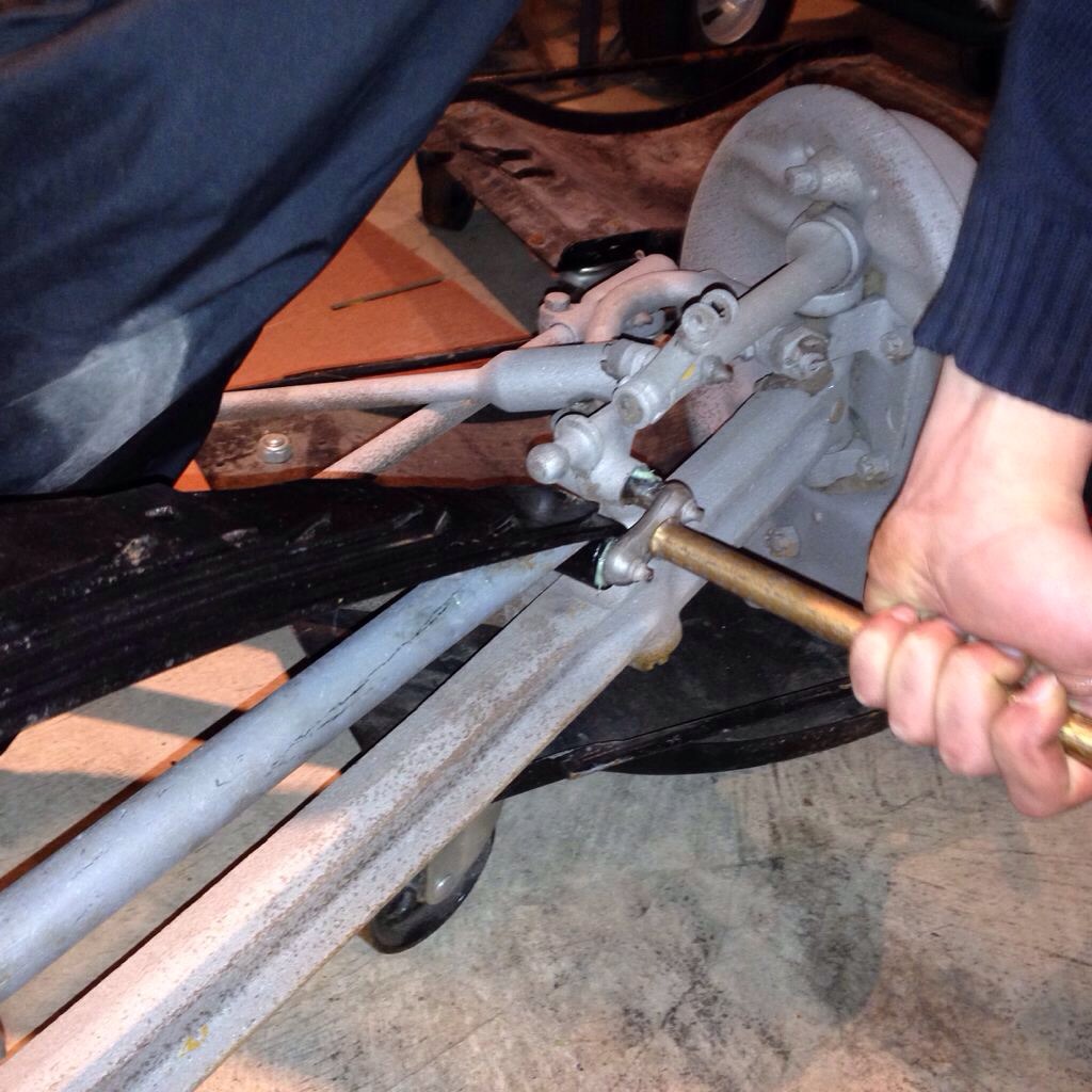

    ImageUploadedByH.A.M.B.1389483292.479884.jpg ImageUploadedByH.A.M.B.1389483303.763850.jpg

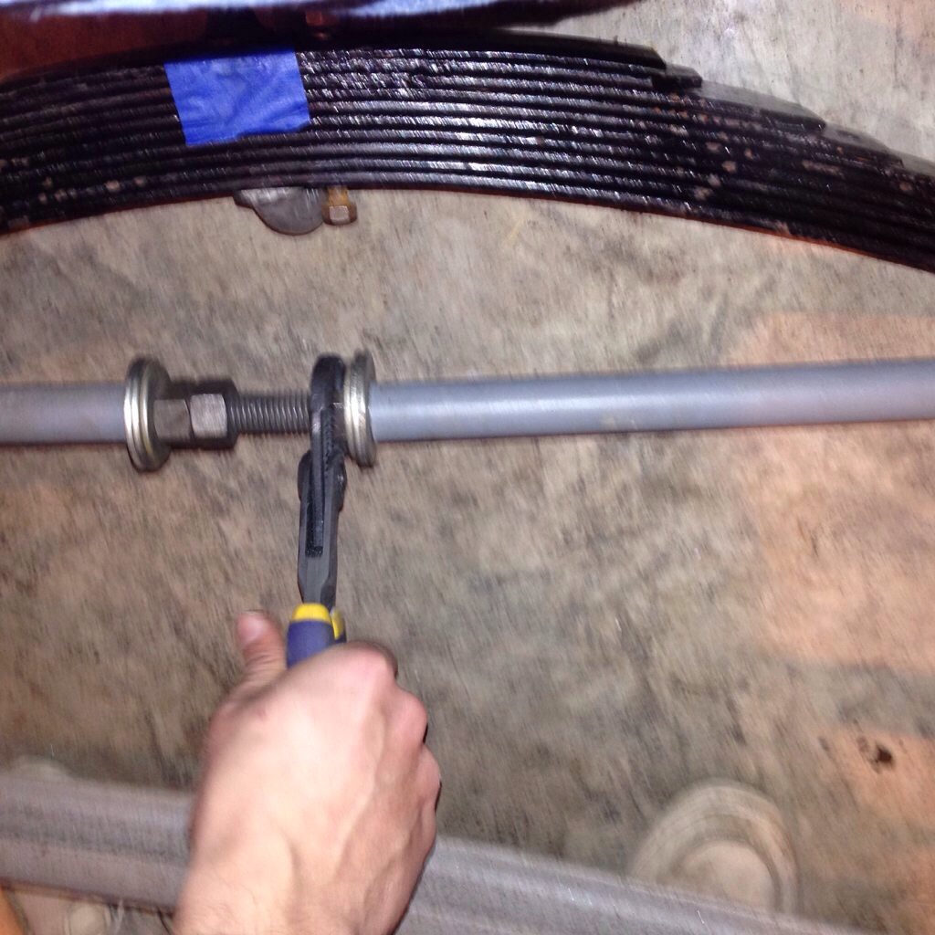

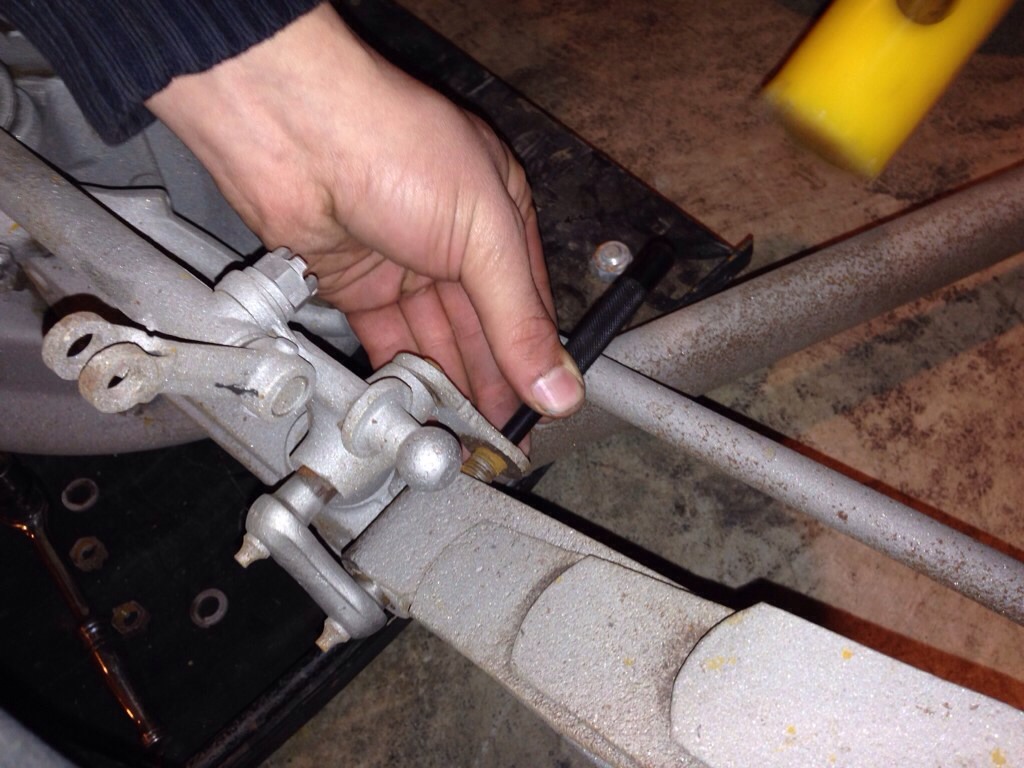

    Br*** drift and a little love...
    Now it's done... Just gotta zip it up...

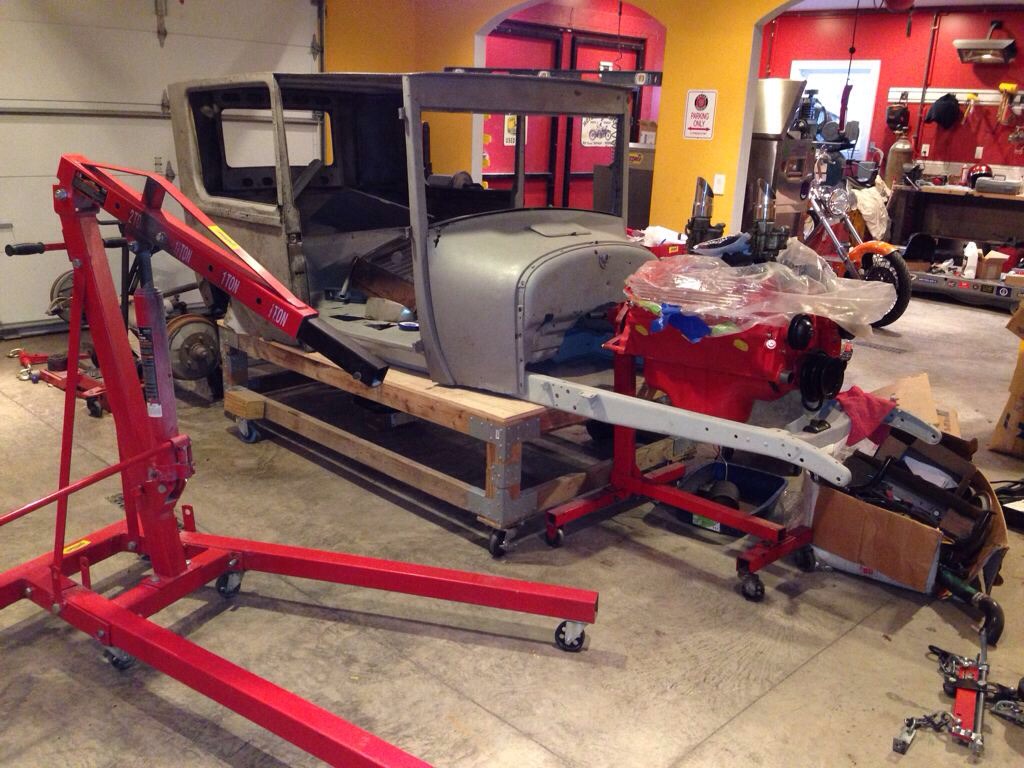

    Time to move flatty outta the way! ImageUploadedByH.A.M.B.1389483660.413102.jpg ImageUploadedByH.A.M.B.1389483680.847613.jpg ImageUploadedByH.A.M.B.1389483702.280693.jpg ImageUploadedByH.A.M.B.1389483757.931706.jpg ImageUploadedByH.A.M.B.1389483775.964781.jpg
  20. pennafxu
    Posts: 2,263
    pennafxu
    from Kentucky
    ImageUploadedByH.A.M.B.1389483999.295961.jpg ImageUploadedByH.A.M.B.1389484022.480864.jpg

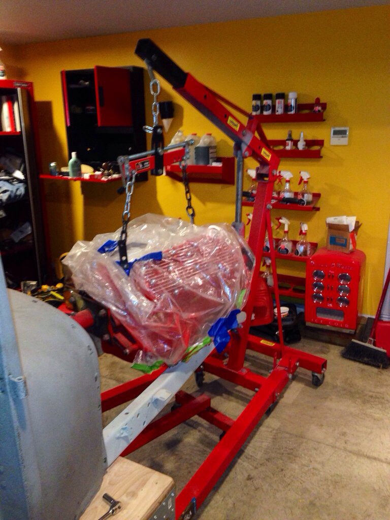

    Engine hoisted out the way! And frame ready for the front end mock up...
  21. pennafxu
    Posts: 2,263
    pennafxu
    from Kentucky
    ImageUploadedByH.A.M.B.1389484256.696826.jpg ImageUploadedByH.A.M.B.1389484288.348539.jpg
    Front end lined up on crossmember...

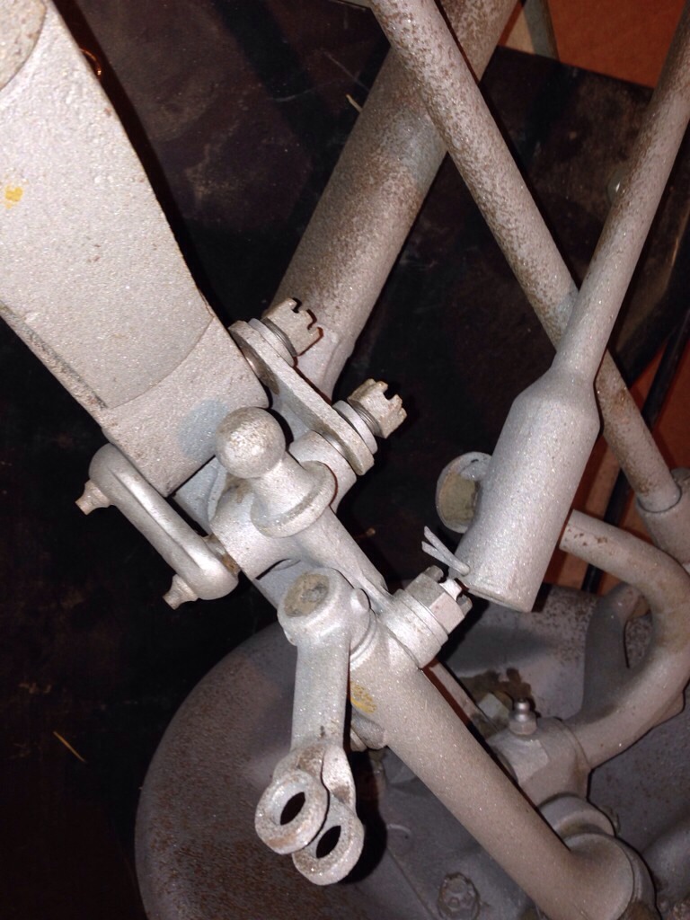

    Front end attached... Except for the wish bone... And shocks..

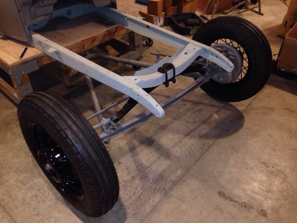

    ImageUploadedByH.A.M.B.1389485814.447511.jpg ImageUploadedByH.A.M.B.1389485830.298802.jpg ImageUploadedByH.A.M.B.1389485841.798036.jpg ImageUploadedByH.A.M.B.1389485856.549036.jpg
    Test fit of wheels...
  26. pennafxu
    Posts: 2,263
    pennafxu

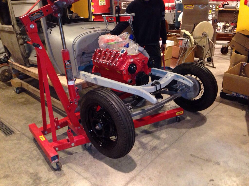

    from Kentucky
    Plopped engine in place... Getting excited!
